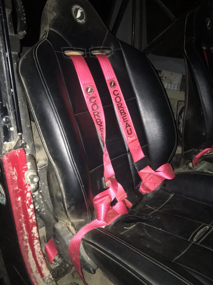

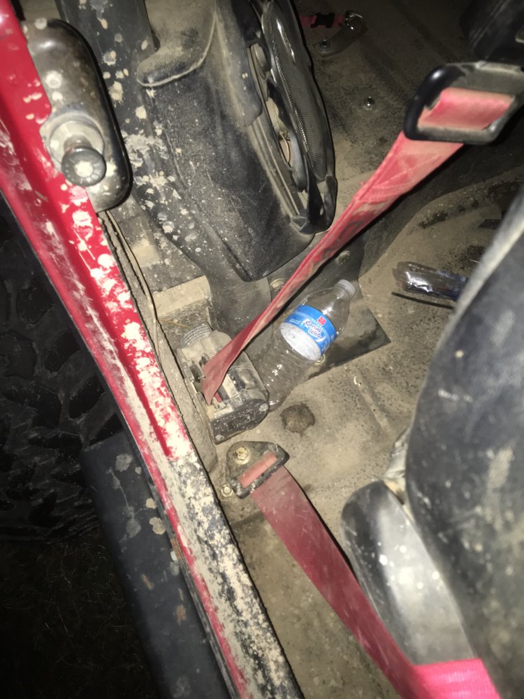

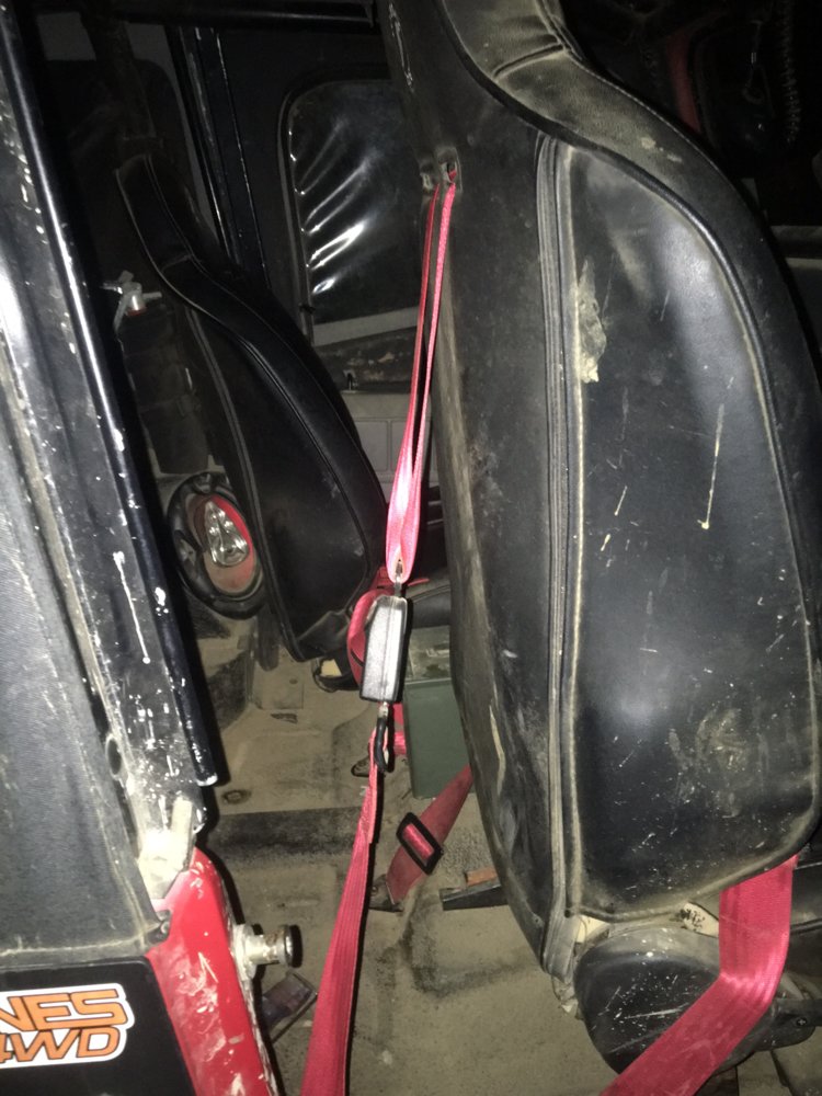

I mounted the reel on the floor where the original reel was. Ran the the strap up and through the backs of the seat.
Works for what i need and access to the backseat (if i had one) is simply done by unlatching the buckle.
