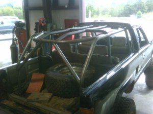

Yea it will tie across the dash. I'm not 100% sure yet if the top will fit. Jon said he would never run it so I wasn't concerned with making it fit. But I could definately build one that could still use the top if needed.

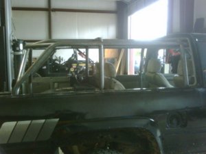

Nice work. I need to get some shop space and start building cages again. I actually miss the bending work.

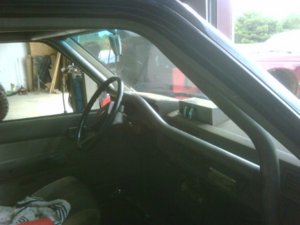

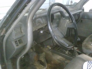

Interesting.... what size tube is that?
I like the bends around the dash vents and across dash, many folks covert he vents, which seems strange to me.

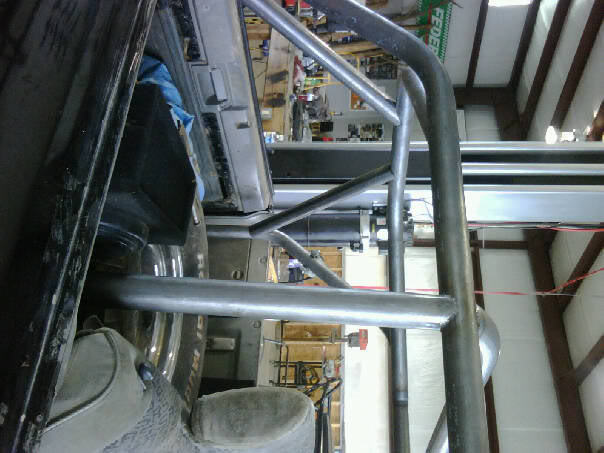

I'm not a big fan of the tube being in teh way, I've been debating making it wit ha thck plate on the side up the dash between there and the door, like some Jeep cages work.

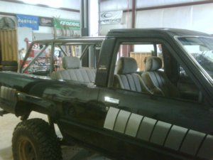

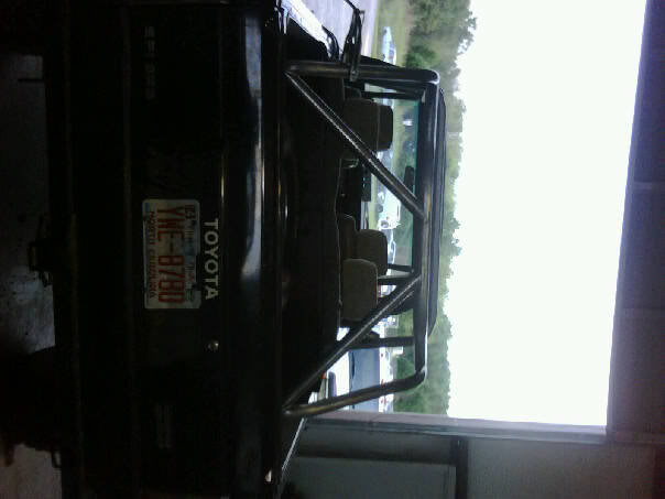

What are boxes in the rar, behind the seats - speakers?
It looks like the top might still fit on.
Gots to have the tunes ..I didn't really know what I wanted I told him a basic idea and he made he better then i told him. GREAT work GREAT price OK guy :fuck-you:

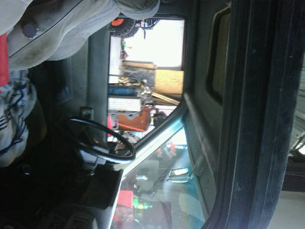

It's all 1 3/4" .120 DOM. The pictures kinda make it look like the bars aren't very tight to the dash but there's only a quarter to a half inch all the way up.
The bar across the dash does slightly cover the ac vents but as long as you don't want them blowing up towards your face it's all good
