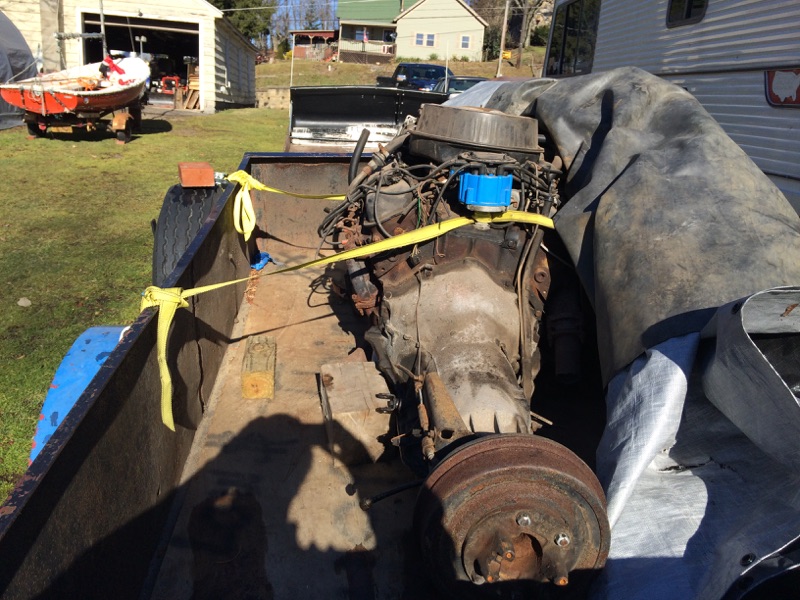

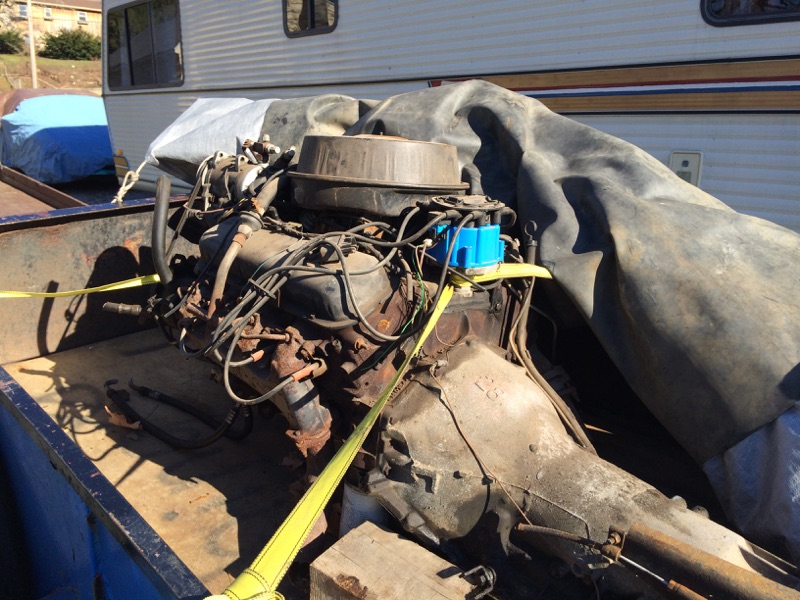

So I ended up with a deal on a 454 engine and trans out of a 1992 camper. I can't find any info on it, but for what they are asking for it, I am definitely into the deal. Does anyone know anything about this engine ? What is that giant drum brake looking thing hanging off it ? I appreciate and help, I am mostly looking for specs and mods as it is a very low mileage combo.
The drum is a parking brake. Can't help much on the specs
The engine is a typical 454 nothing special
( if you decide to sell the accessory brackets, mainly the ac and powersteering let me know )
The trans is a th475 basicly a beafed up th400 (iirc) the drum is the parking brake
pull the oil pan and see how many bolts hold down the crank cap. If it's a two bolt main, then not so existing, if it's a four bolt main, then you scored!!!!!
Also, If its a STOCK "unmodified" Mercruiser motor? If so, then the 330/310 hp is oval/peanut port heads. The 365 hp is a rectangular port head.
Unfortunately I don't know, it really depends on who wants it. Drag race guys I would think would pay the most for it.
