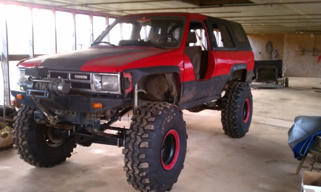

Done some upgrading, on my rig, before it had a narrowed dana44 around 63"wms 5:38 gears arb, 4.7 single case 36" tsls, after breaking 3 diffrent sets of cromo's, decided to spend some money and do it right. IMO So got and 85 housing with hi-steer, put and high pinion 3rd with 5:29's and arb set of longs and a duel case set up, and nearly new set of 38" tsl's. Big thanksto duane and big jakes fab for doing a great job on it.
Bad ass man!! How did you end up addressing the width difference of the taco rear and early front? :beer:
like the 1/2 doors and black up the sides too!
