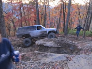

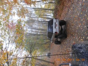

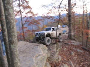

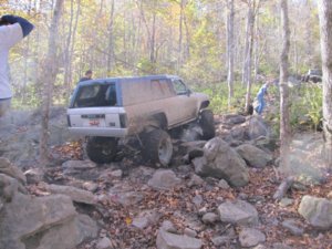

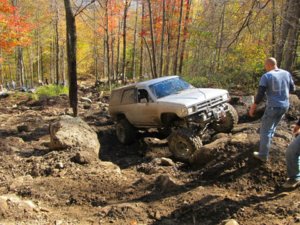

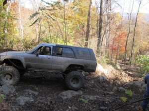

This is my first post of my rig i started it in march 11' and fall crawl in harlan ky was her madien voyoage and definately found what i need and where i stand. i did Mason Jar, Middle Rock Garden, Crawfords Cry, and the Intimidator. I was very pleased with the outcome and performance but got a long way to go.

i live down the street a few miles. I'm trying to pick up a runner myself. Rocking a single cab pickup now. Good looking rig though. What were the issues you had with the first trip?

front axle- trussed,longfields, spooled with 5.29s
rear axle- cromo shafts, spooled, disk brakes, both armored
front springs-ruf hybrid pack
rear springs- f-150s+add aleaf
37 iroks w/ old school slot wheels(machined to fit toyota hubs)
wheel base is 112"
near future- hydro assist, dual cases, and cage
the all the things in the near future are the things i found that i needed after the maiden voyage
