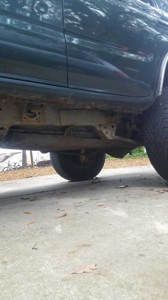

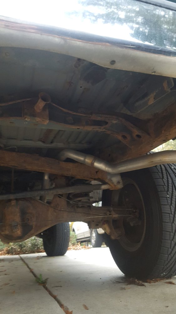

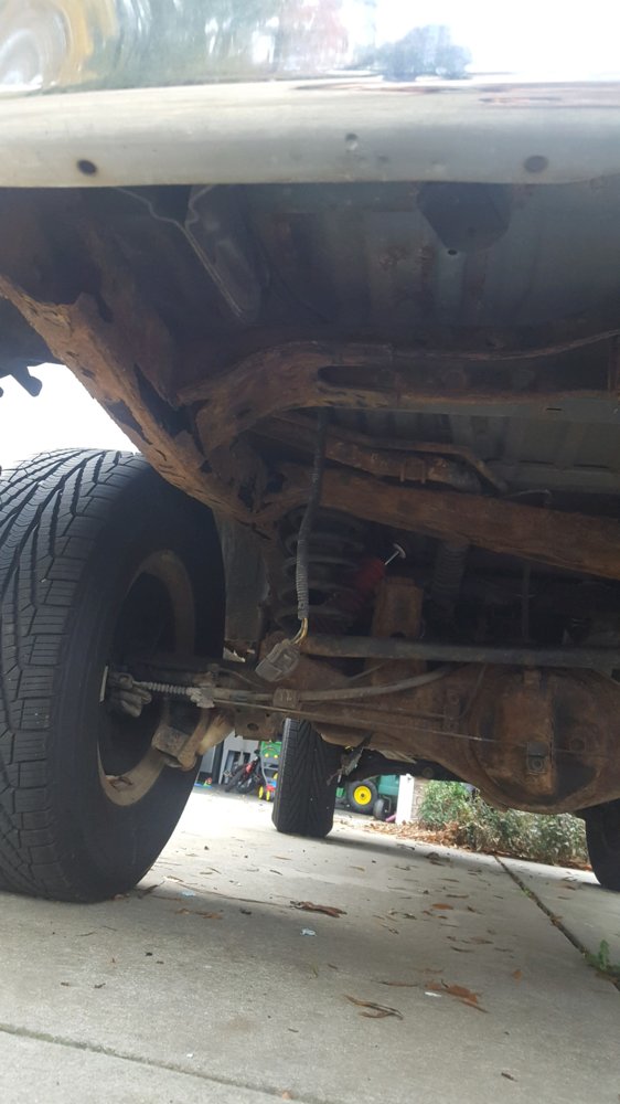

I have 99 4 runner with some frame rust and I'm currently deciding between selling the vehicle or swapping the frame. So far no good bites on the selling option. A few questions regarding the frame swap option though. When looking for a frame replacement, are there other year models that are a direct fit/replacement for a 1999? Also is there anyone who has done a frame swap like this before, and are there any out of the ordinary tips or tricks I should know before starting. Is a lift required? Or just a hoist, cherry picker, and a few jacks? I've never done a frame swap before but I have rebuilt a few transmissions and engines. Just kind of nervous about what I might be getting myself into but again I am mechanically inclined.

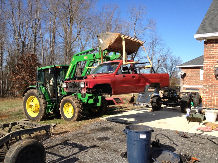

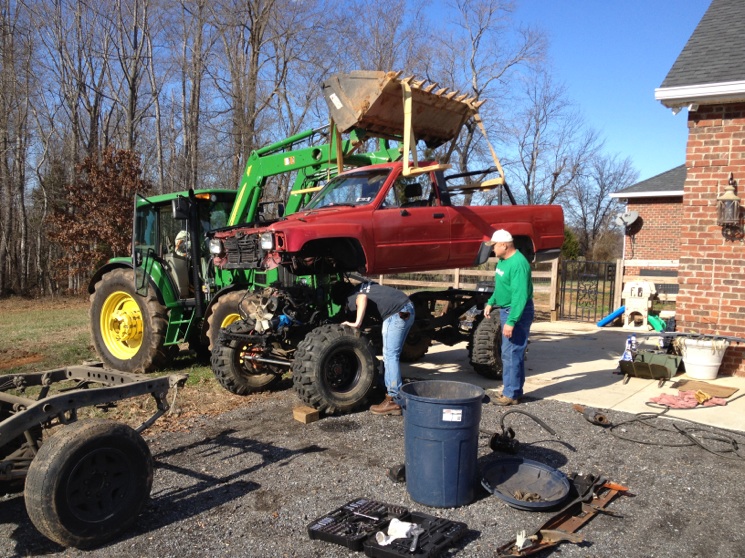

Did it once. Had 3 good helpers and a 100 horse Deere to do the heavy lifting. Still one heck of a job, but very doable with friends. I’ll echo what @sgtbriangreen said, all those fluid connections make yours harder to do than mine. I only had propane and brake lines to hook up. All the wiring had been stripped out as well. Crawler vs Driver.
I appreciate the quick response SST. Your actually my first reply since I've joined. I replaced the rear bumper on it about a month ago and snaped 2 bolt heads off while doing so. I have a feeling every other bolt under it is going to do the same. The brake lines are almost gone in some places too. At this point I'm thinking about buying another junk runner (if i find the right one) and rolling it's frame, lines, tank, axles, shafts and all up under the current body then just swapping the engine, trans and everything under the hood. I have a shop with a lift and a few wrench turning friends I'm sure I could borrow. I really don't want to dedicate more than 48 combined hours on this project though. Does that sound like a long shot?
