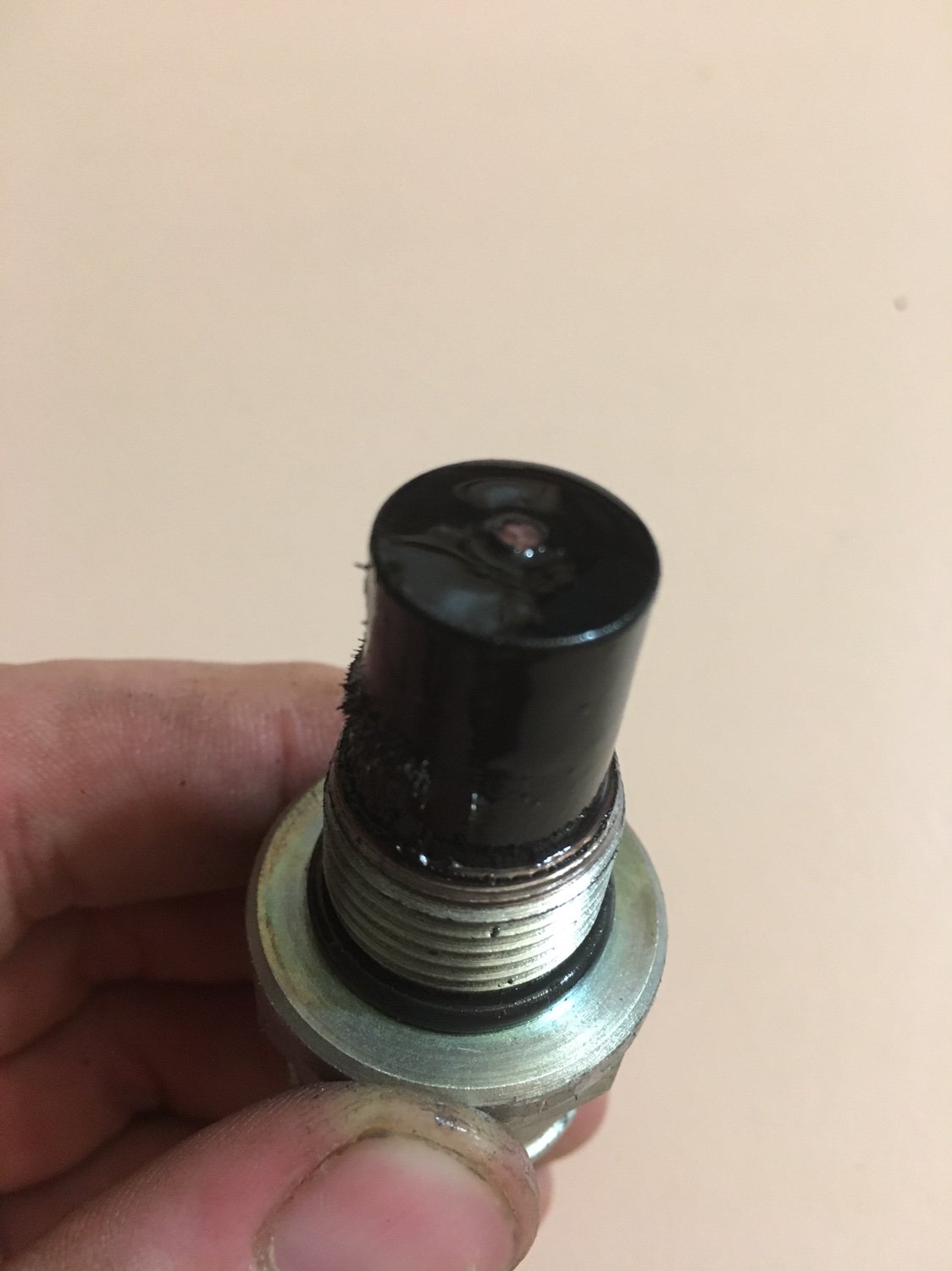

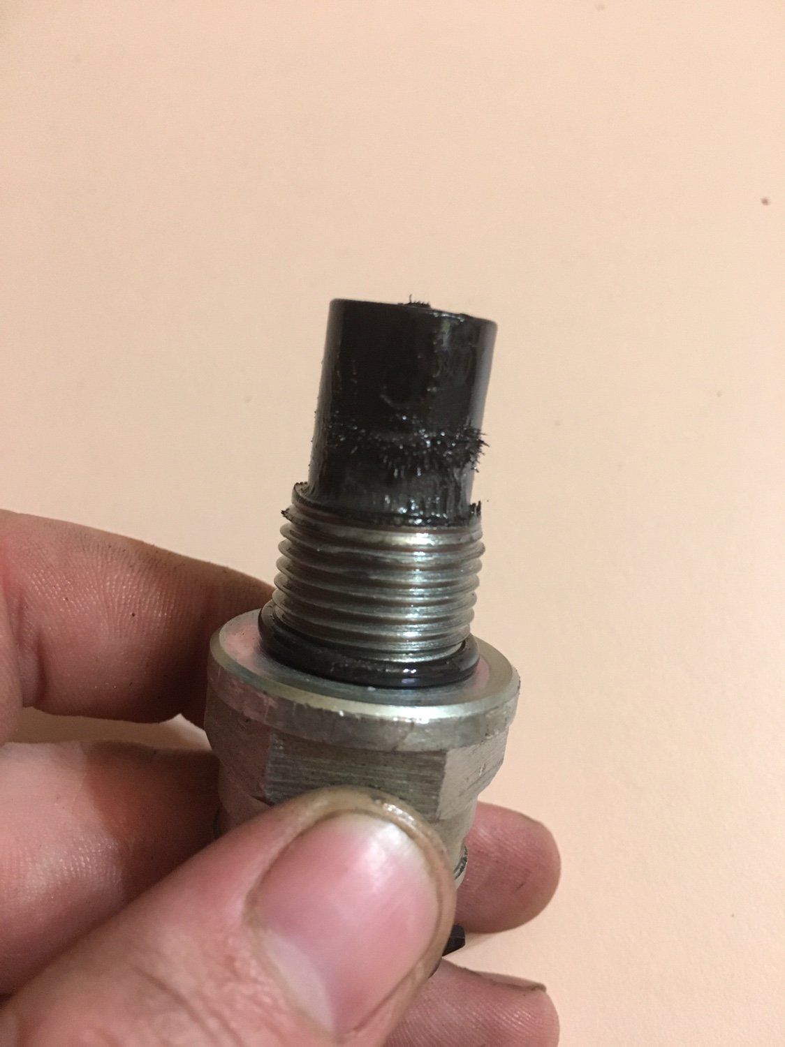

Sorry. Running manual. Yes to VSS. Pulled it and it has some flakes on it, and the tip had something on it besides the ATF. Wiped clean now.

@XJsavage and have looked at this VSS and hope that the cleaning did the trick. I'll know more tomorrow.
If it was the vss, your speedometer would have read wrong as well.. check the iacv as said.. scan and see if any codes present. When you say running manual do you mean manual trans or manual valve body? Also if the latter, is the t/c lockup still under PCM control?

Manual trans right now. No speedo atm either. I just use my phone when driving through hot spots. But I'm a fair judge on speed based on rpm and gear.
Reading online. Apparently depending on loop status determines if vss or iac is controlling rpm. And loop status is determined via vss.
So hopefully this was just a dirty vss issue. We will know more tomorrow. Apparently stalling while braking is a common issue exp by those who run non electronic trans but also try to skip vss

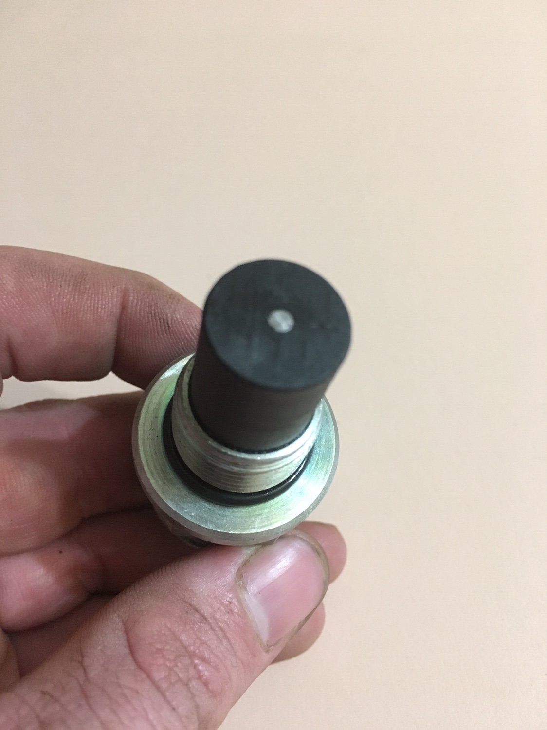

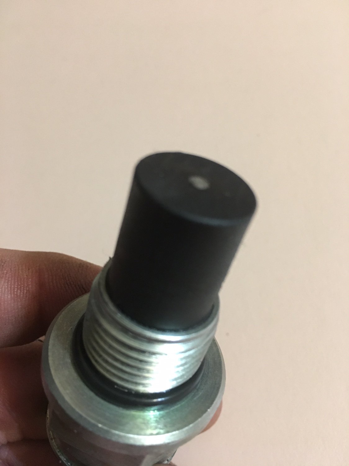

Its back. Not as bad. Basically as it was like when it first started.
Could this be just a really crappy vss that is too sensitive? Its a 90$ duralast sensor. (dual latch version)
ALT options are Airtex/Wells ($60) and Ultra-Power ($40). Both of which have probe tips which have a convex area for more probe protrusion...
