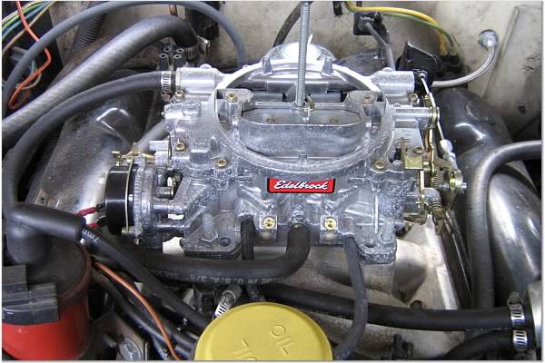

360, edelbrock carb & intake

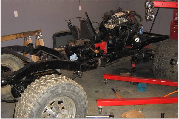

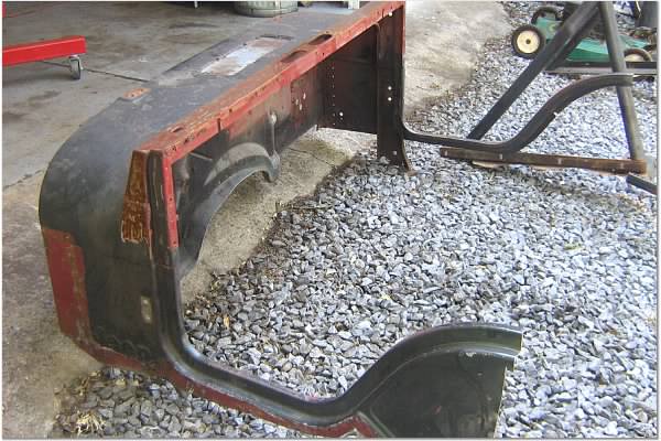

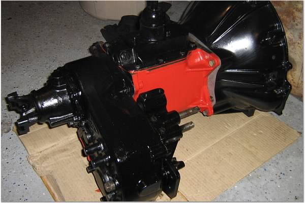

Rebuilt it all.

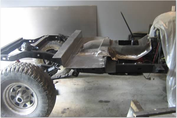

Slightly redesigned the step behind the seats for more legroom.

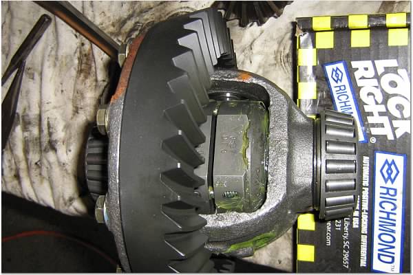

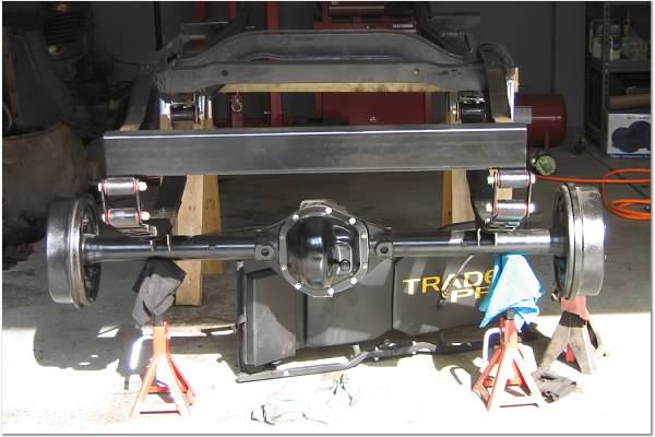

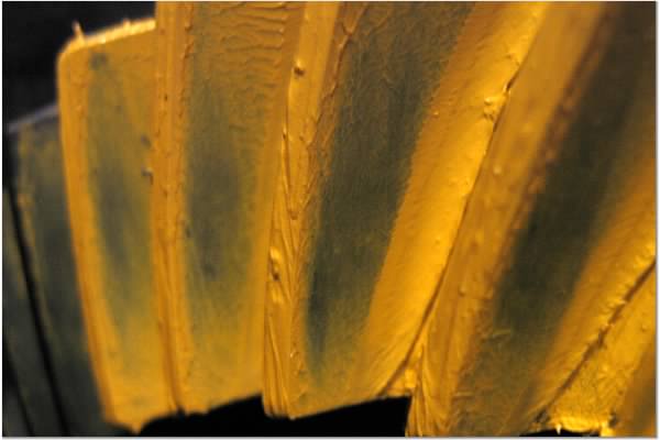

How bad was the AMC20? I just geared one for a guy because he didnt want to spend the $$$ to build a narrowed 9 inch. Thats the weirdest thing, all that pumpkin with tiny tubes coming out. It already had Moser shafts though.
Swapped in D44's from a scout. I pulled the cover on the 20 and it all looked ok. Didn't tear into it much more than that. I sold both stock axles to a guy for 75 bucks.

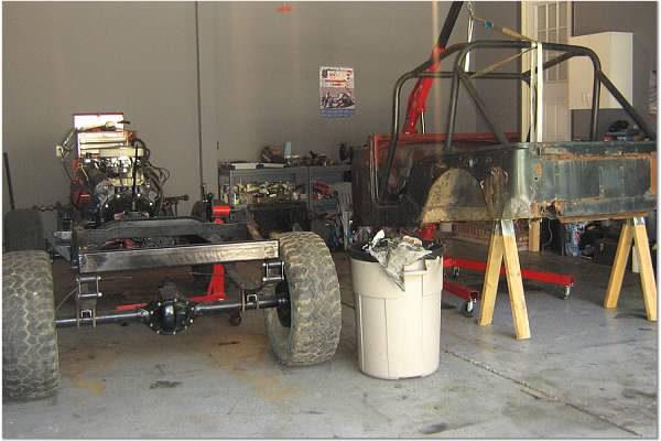

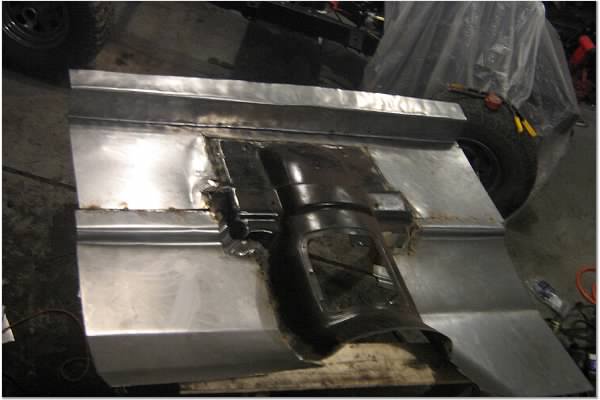

The entire body is going to be hand made except the front cowl/firewall, 1 inch of top rail that goes around it, and some of the trans hump.
5.13s/lockrights. First time setting up gears.

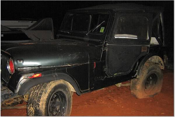

Bought the donor vehicle off ebay for $1k. Was told amc 360 had just been rebuilt. Found this in the dash. Work done by USA Machine Shop in Fayetteville, NC. Dated 8/06 :huggy: Also has an edelbrock carb and intake. Steal of a century. I burnt the tires off the wagoneer.:Rockon:
