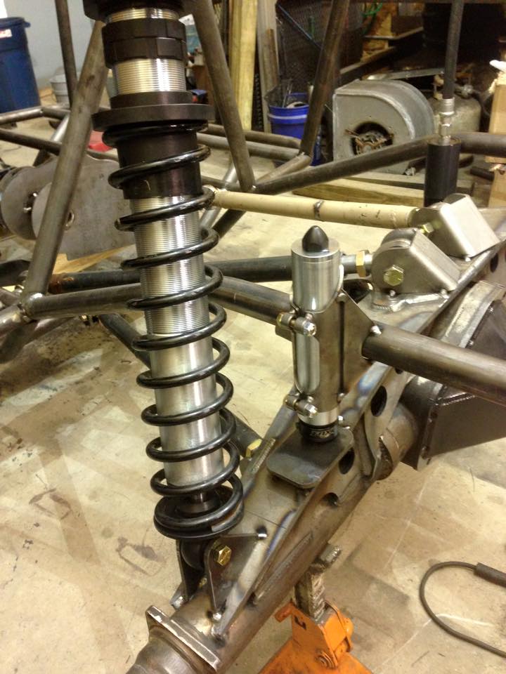

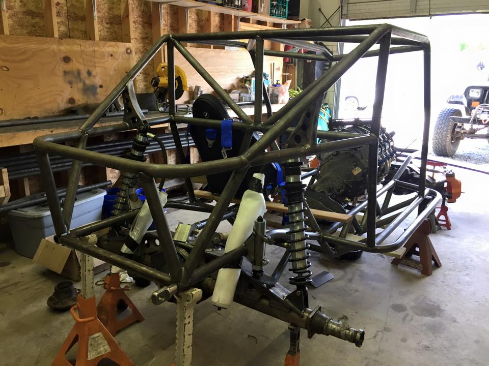

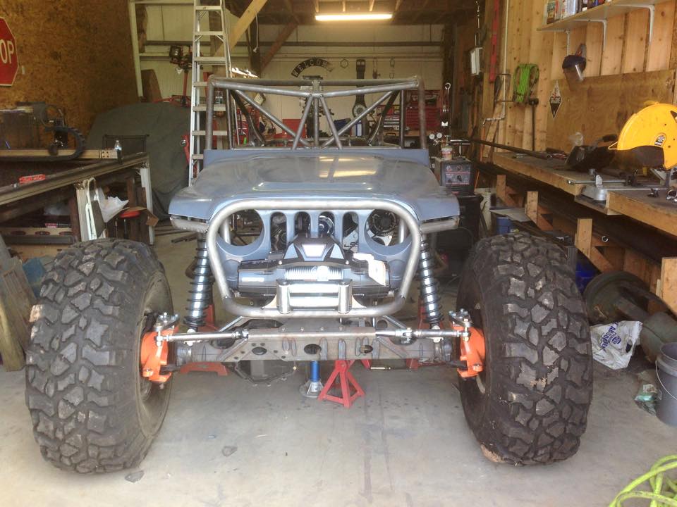

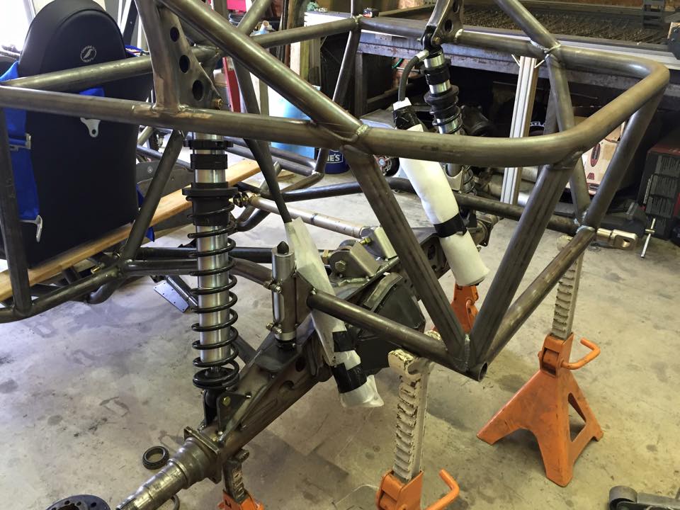

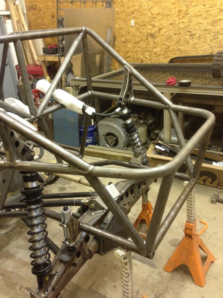

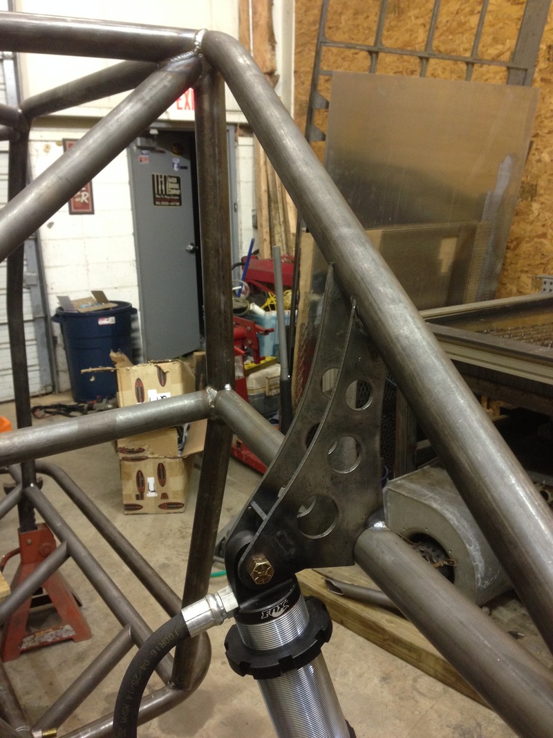

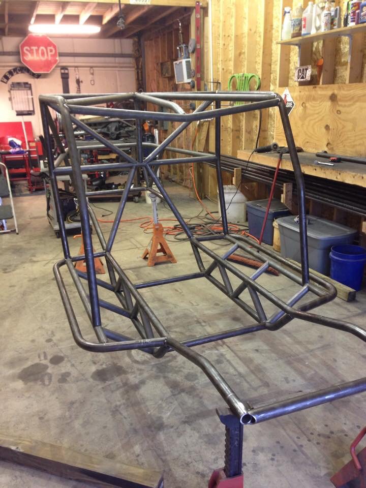

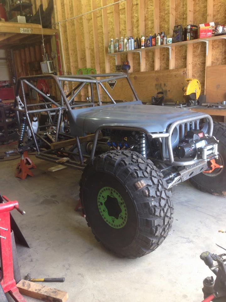

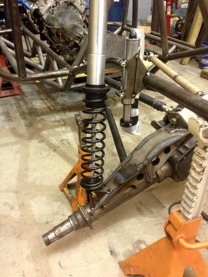

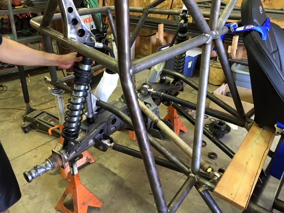

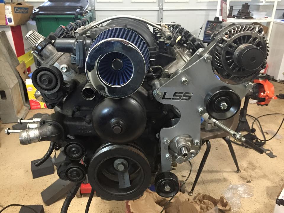

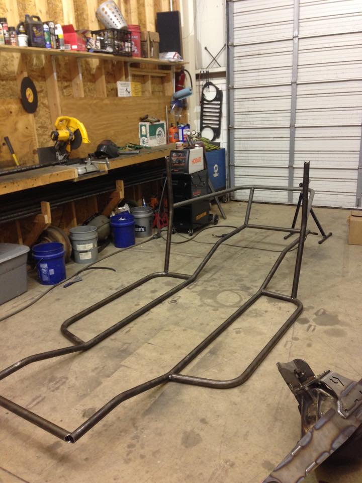

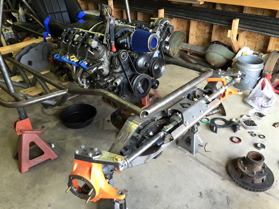

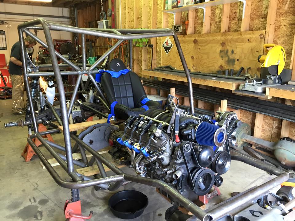

After 2+ years away from wheeling, and building my business I decided it was time to do something about it. I had bought a Salvaged-Rebuilt 2005 GTO to play with but decided it wasn't my thing, so I parted it out and kept the low mileage LS2 to build a buggy around. A local Ga builder is making it into a roller. I`m going to do the wiring, plumbing, tear down, powdercoat and rebuild. Looking forward to get back into the wheeling game. :smoke: And yes, I gave in and got the GF pink harnesses as a Christmas gift.
Plans:
54" Fiberglass JK front clip
6.0 LS2 with some goodies. Estimated 510 horses
Hughes TH400 2400 stall
205 or Atlas
Chevy 60 456s, Detroit, Reid knuckles, Artec trusses, 300M RCV shafts
14 Bolt 456s Detroit Artec truss
43sx on Creeper Locks
1.25" heims

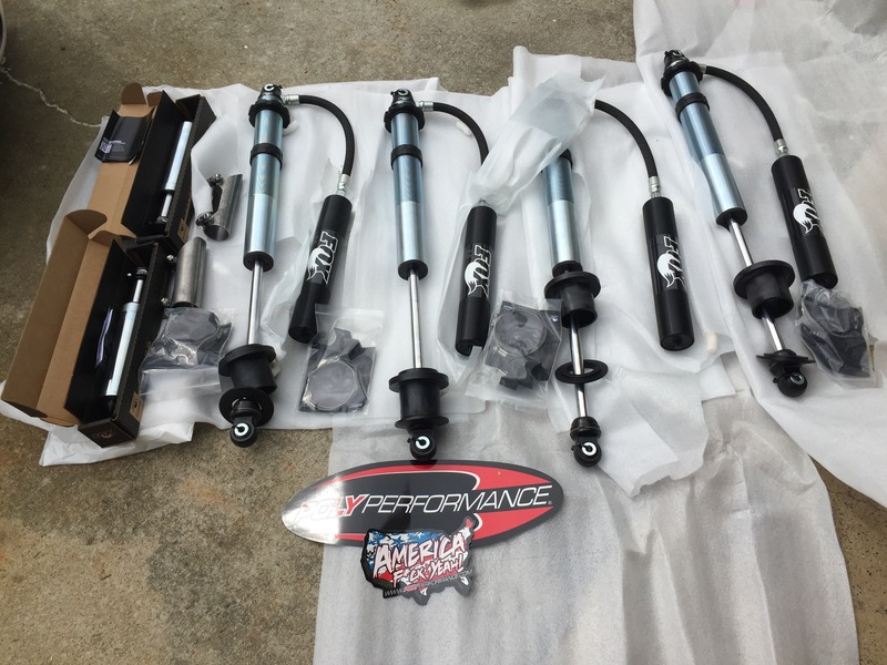

Fox 2.5 14 remote res coilovers front and rear. Fox 2.0 3" bumps upfront
PSC double ended full hydro
Corbeau Baja SS seats
RJS Harnesses
Polished aluminum links

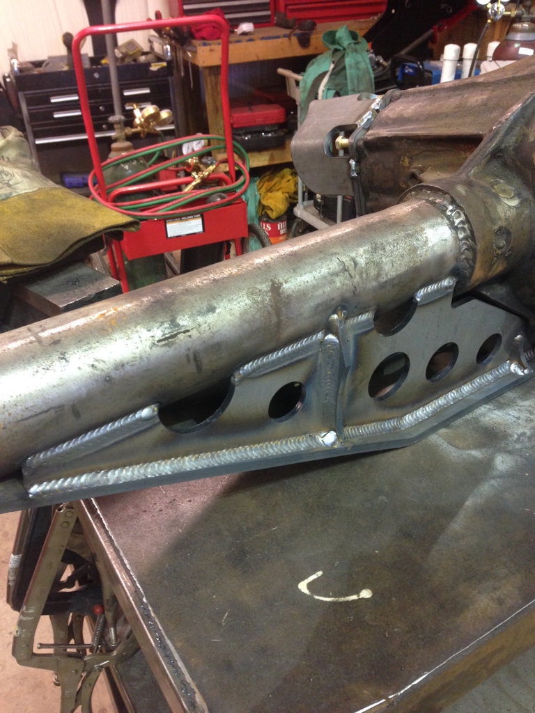

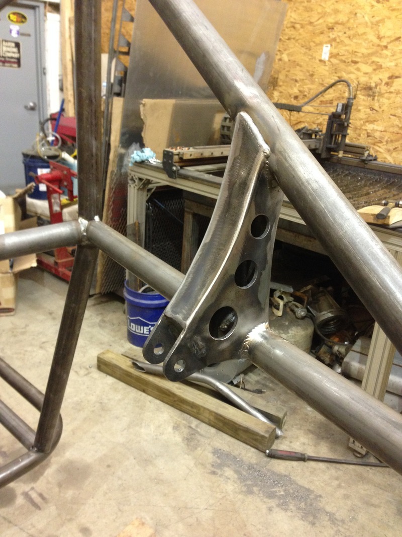

Awesome parts list! Nice welds on the Artec trusses. Who is the GA builder? Just curious. :D

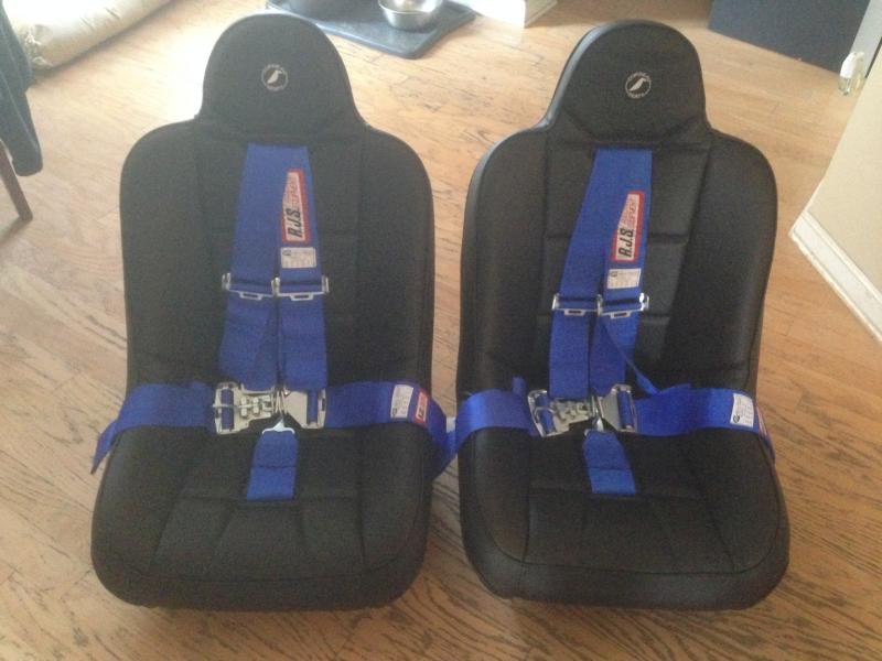

Subscribed... And we're gonna need to see more pics of the seat model...
Well then. :bounce:

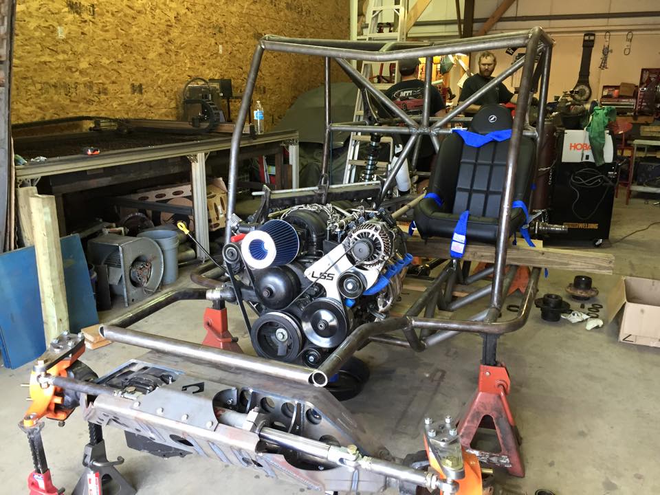

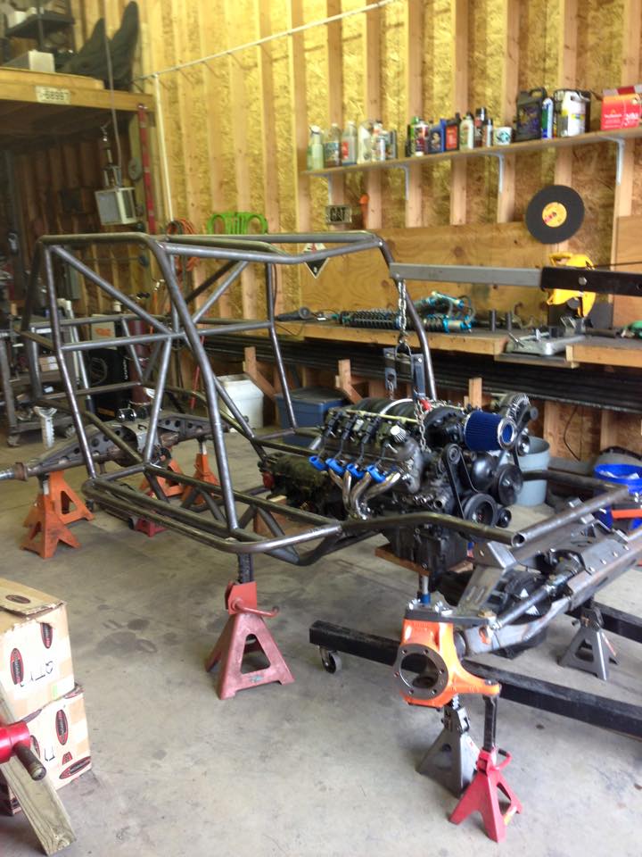

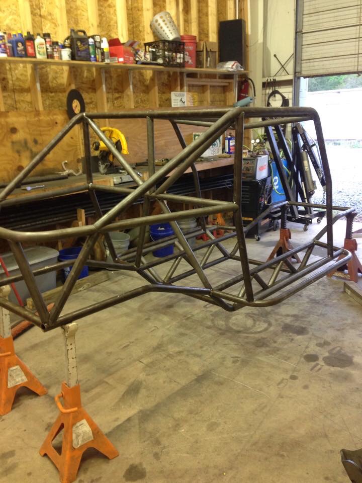

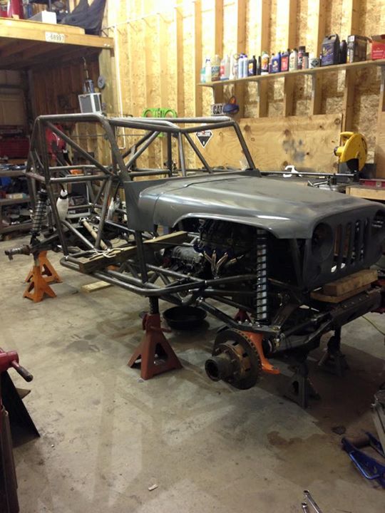

It would look better with a motor in it.
Looks good! It'll be way more comfortable with seats in it. :flipoff2:
