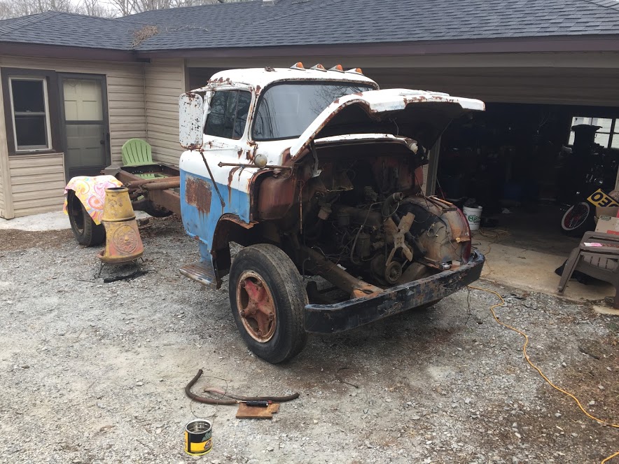

So in December 2016 I bought this truck as a project and have finally decided on a donor for the drivetrain. The Idea is to make it into a medium hauler as well as a plow truck for the winter here in the mountains.
1957 GMC 2-Ton COE:

What engine and trans are in it now?

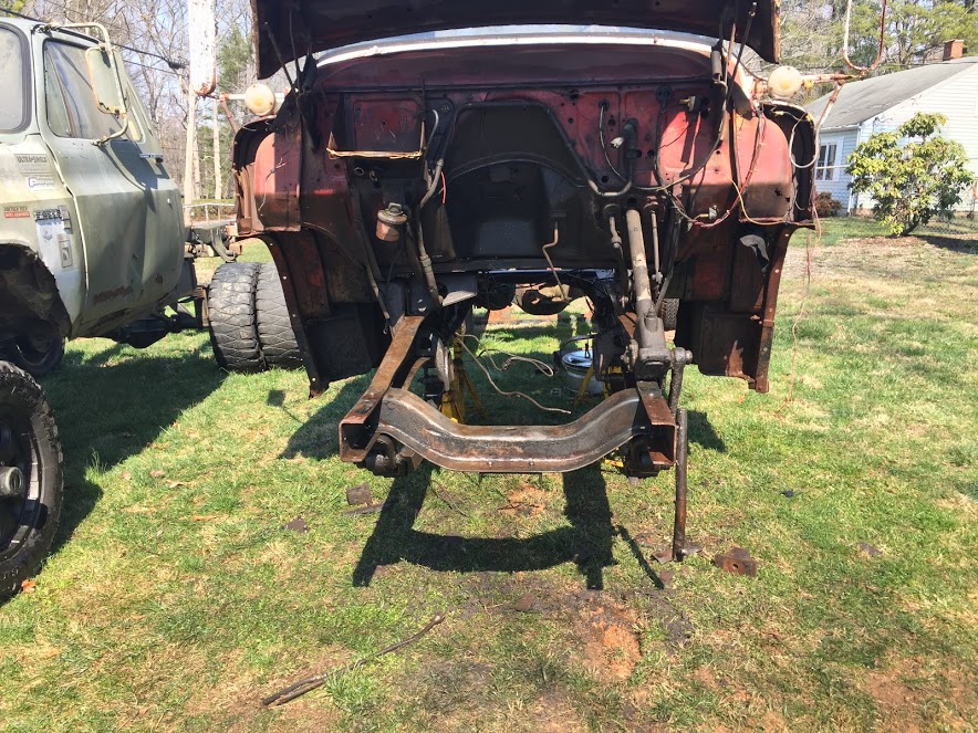

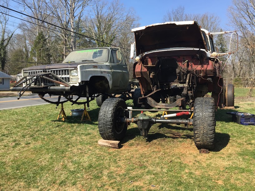

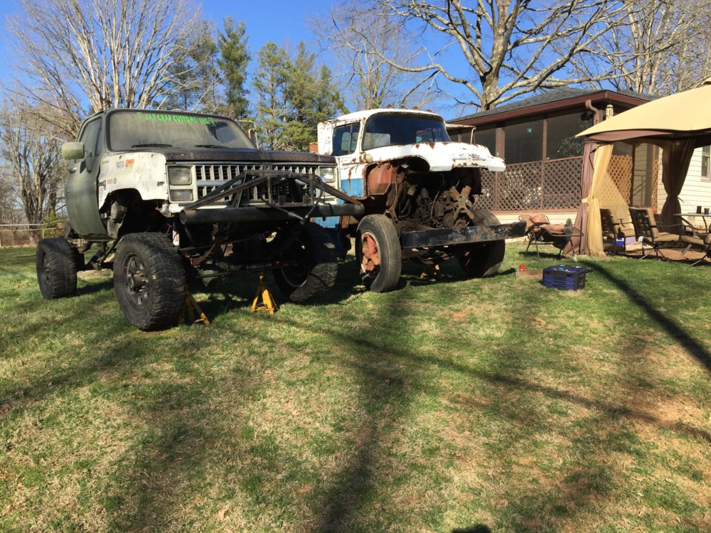

Also Moved the COE next to the Chevrolet:
And removed the front axle from the COE:
Next step is removing engine, and trans from the COE and cleaning up frame rails and painting. Good news is that the spring perches on the Dana 60 match the spring locations on the COE... no cutting and welding perches on the fron, just on the rear.

are you keeping the COE's springs or swapping those from the K30? Also, are you going to try and lower it any? The factory axle had a big drop in it, so I suspect you will get a ton of "lift" with the swap.
dackers
Aug 30, 2013
Mill Spring, NC
Planning to keep the COE springs, should be roughly 4" of lift. If it looks like too much I'll relocate the spring hangers, but that can be done later if needed.

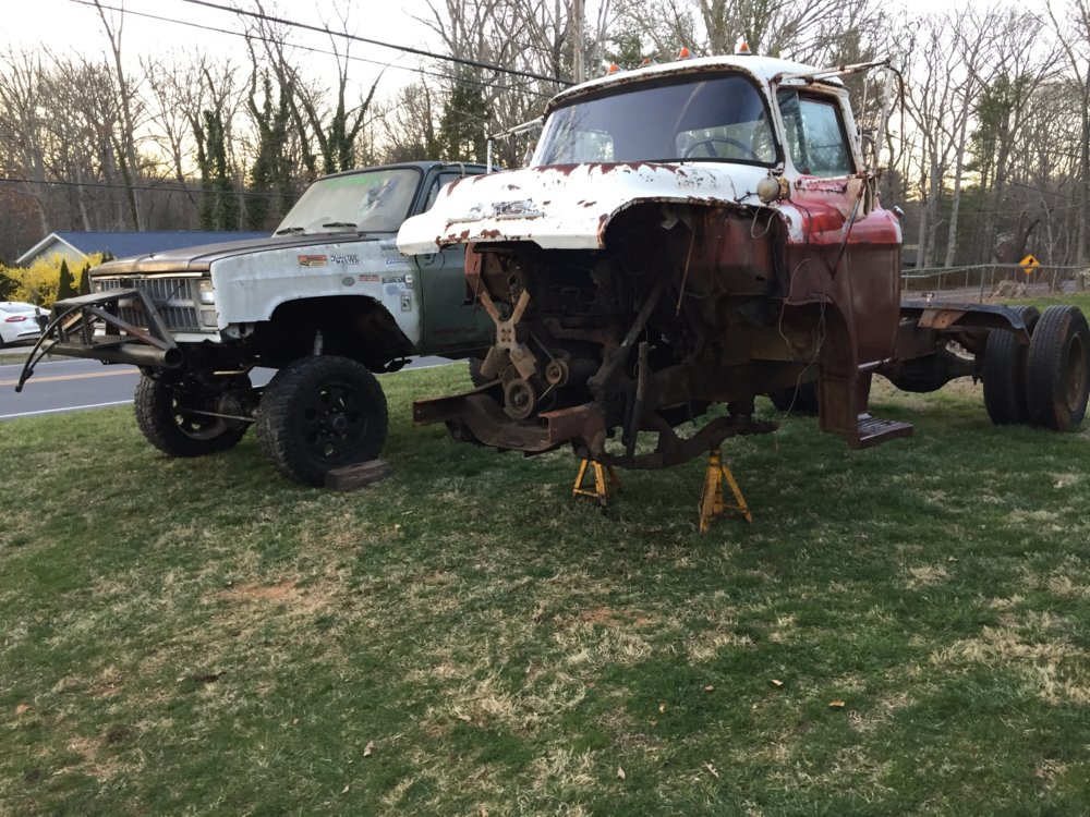

If I got home this afternoon and one of you "spectators" stripped the engine and transmission out of the COE, I would not be the least upset...
Well, since none of the spectators could make it by to do this for me, I did it Thursday night...

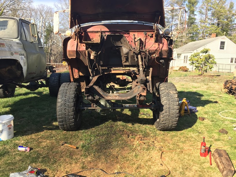

Today was front axle swap in:
And it is bolted in:
My wife helped as much as she could and I really appreciate her! Tomorrow, hopefully I can get front drive shaft, transfer case, and crossmember in...
