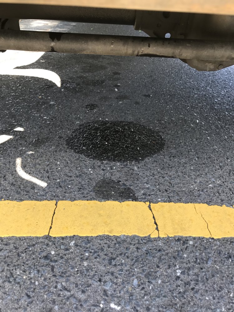

Hunter44 Well-Known Member Joined Feb 26, 2014 Location Lexington May 7, 2017 #1 After sitting over night every night. It's deleted and bulletproofed. Had the water pump replaced about 6 months ago. Attachments IMG_0735.JPG 192.8 KB · Views: 239
Ron Dum Spiro Spero Moderator Joined Apr 16, 2005 Location Sharon, SC May 7, 2017 #2 Is that oil or anti freeze?
Tim C Wizard Joined Jan 22, 2007 Location Fayetteville May 7, 2017 #4 Look real close there's a fat doughnut gasket between the front cover and the intake. I've seen them leak. It's to the right side if the intake elbow. Sent from my XT1254 using Tapatalk
Tim C Wizard Joined Jan 22, 2007 Location Fayetteville May 7, 2017 #5 And just because pump was replaced doesn't mean it won't leak after a few months anymore. Sent from my XT1254 using Tapatalk
Hunter44 Well-Known Member Joined Feb 26, 2014 Location Lexington May 7, 2017 #6 I was thinking the timing cover gasket myself
