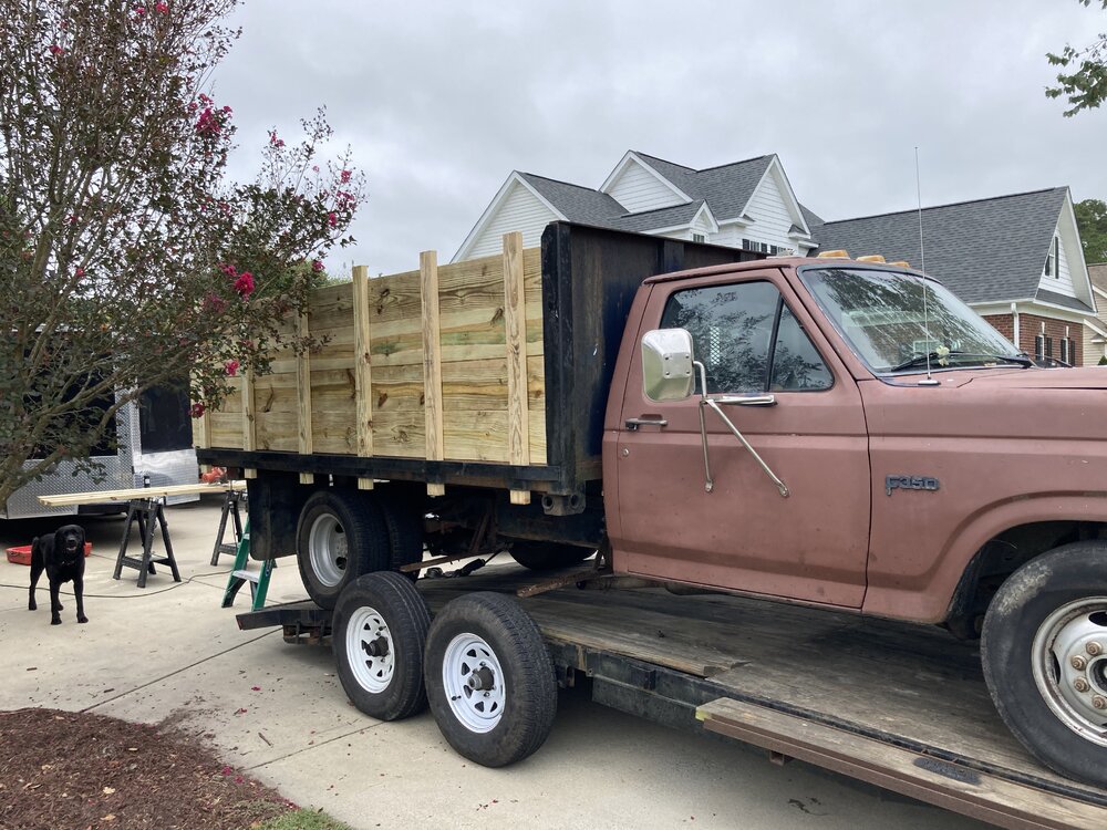

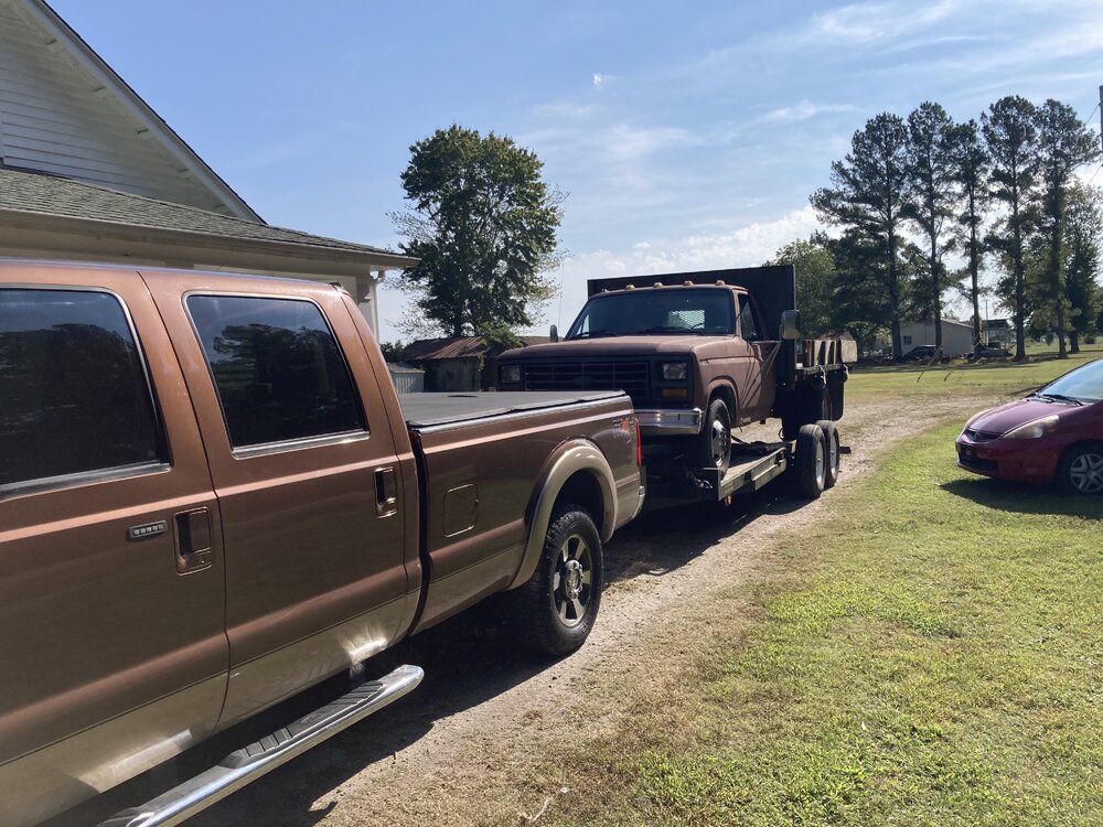

Whelp, it followed me home. Farm dump truck. :)
