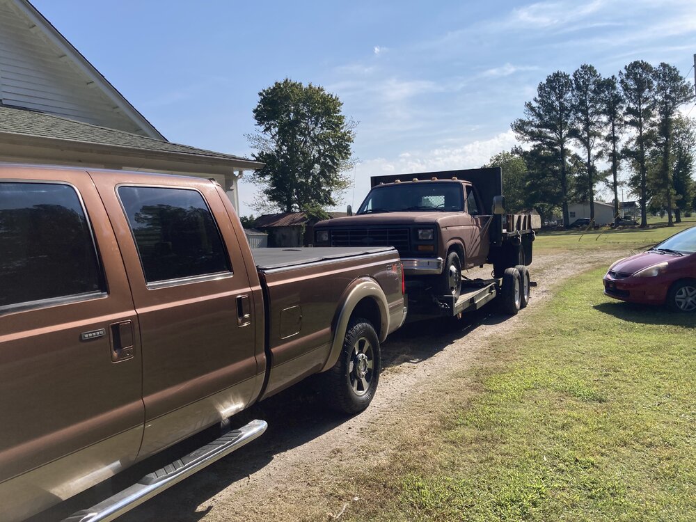

I’ll paint the dump truck to match this f350. 2-tone Ford bronze to match for the win! And to hide some of my upcoming half ass rust repairs. :D

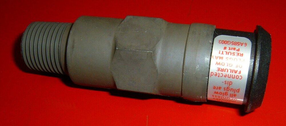

Just saw them feed one to the crusher that had a a pretty good interior lees the dash pad.Ive been around several of these trucks w the 6.9 and it seems you can never ween them from the shot of juice every morning.Theres a glow plug controller that screws into the block(or maybe intake) that goes into the coolant and iirc youre not suppose to try and start it for 15 mins until that thing has time to read the coolant temp to know how long to keep the glow plugs on.Been along time since Ive been around one.
