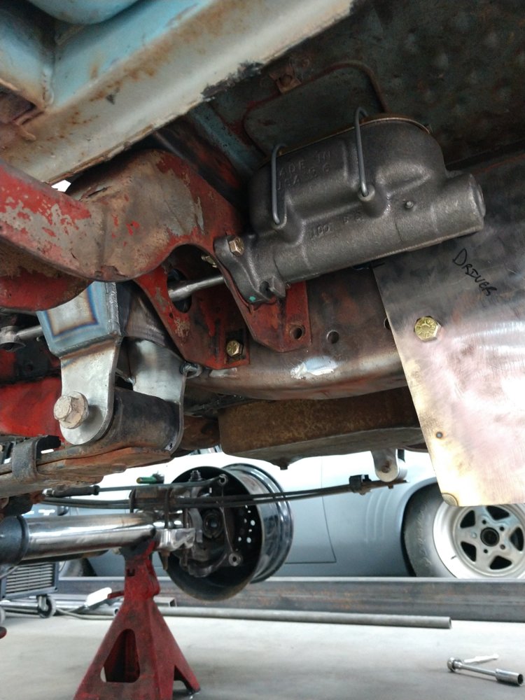

this is my first project at work. 1962 M-37 Firetruck.

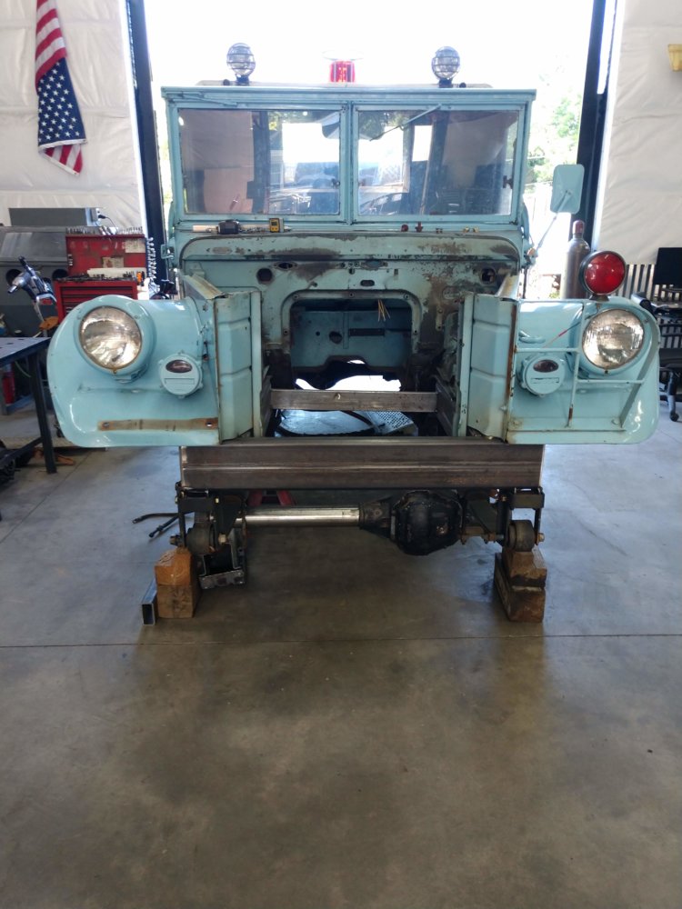

axles: 02 Superduty 60 front 4:88 gears, Yukon Detroit locker, high steer arm
rear: 02 sterling 10.5 4:88 geared, Yukon detroit locker,
I did the gearing, first time was an experience lol, but I managed.

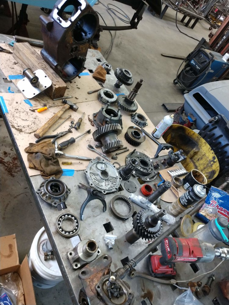

SBC 350 mildly built, TH400 with NP205, rebuilt 205 (I rebuilt it too, that was fun).

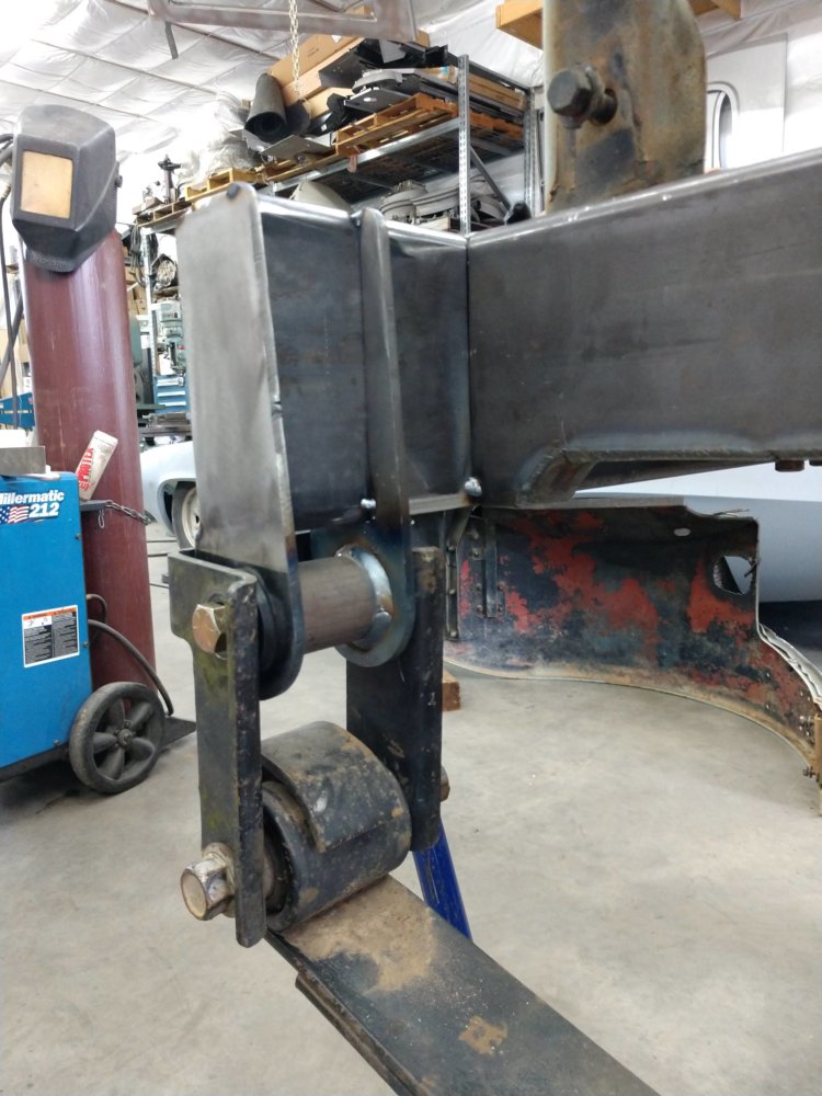

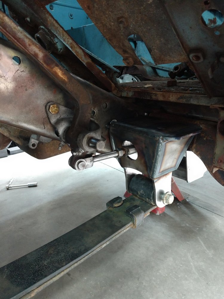

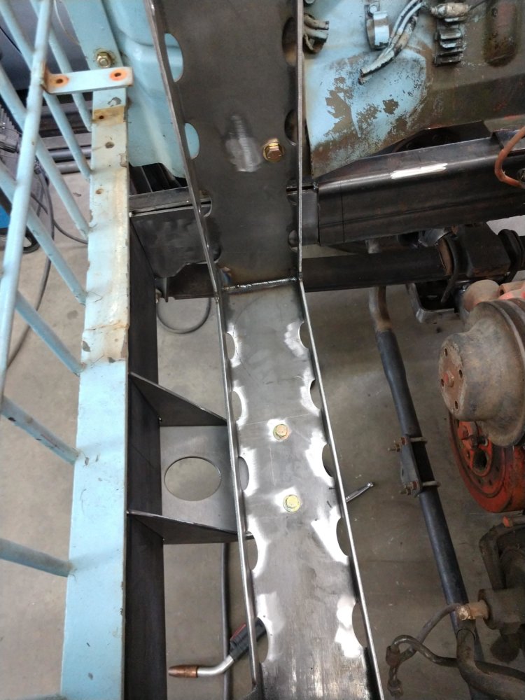

Used front leafs off the 02 superduty truck, rear had to keep the factory leaf pack due to the massive weight of the tank and all the firetruck accessories. All new brake lines, fuel lines, brakes, the works.

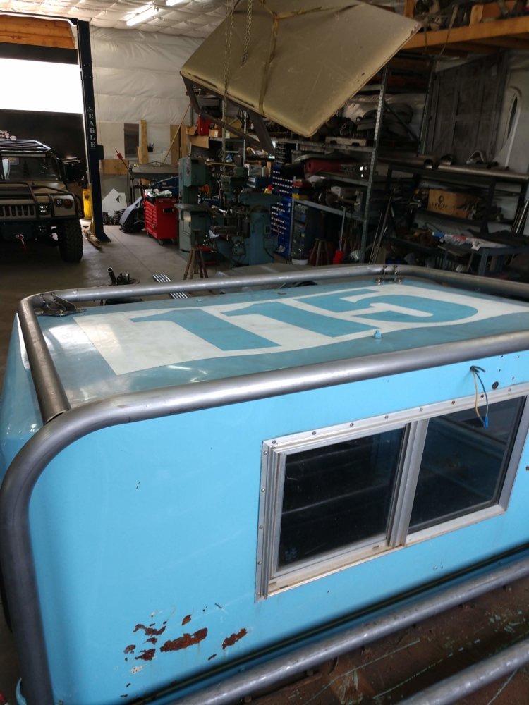

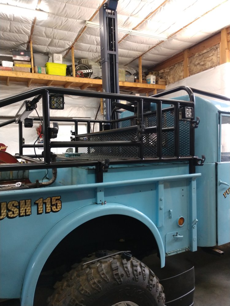

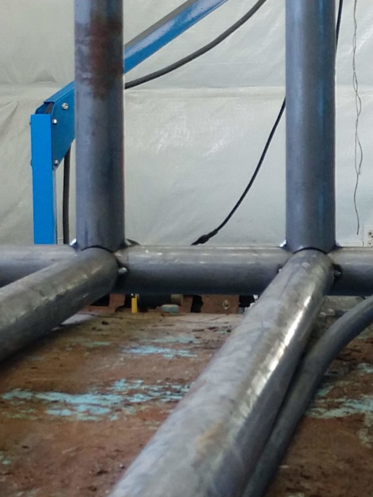

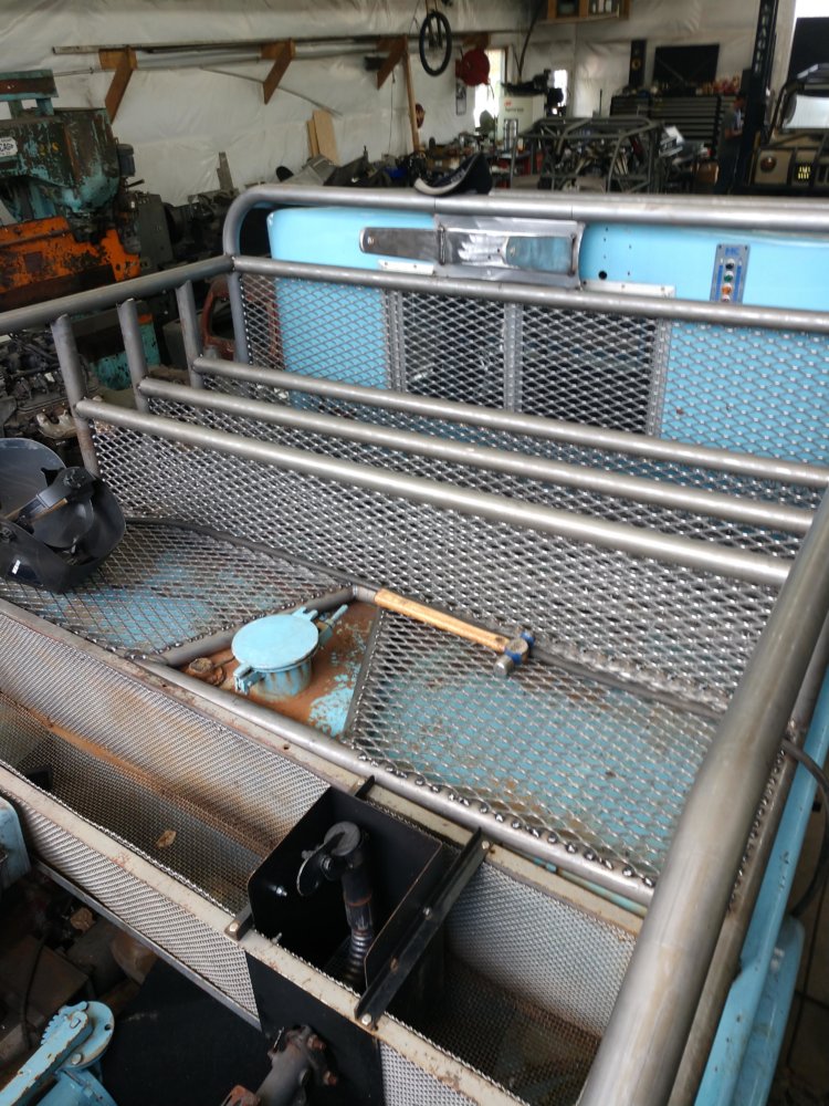

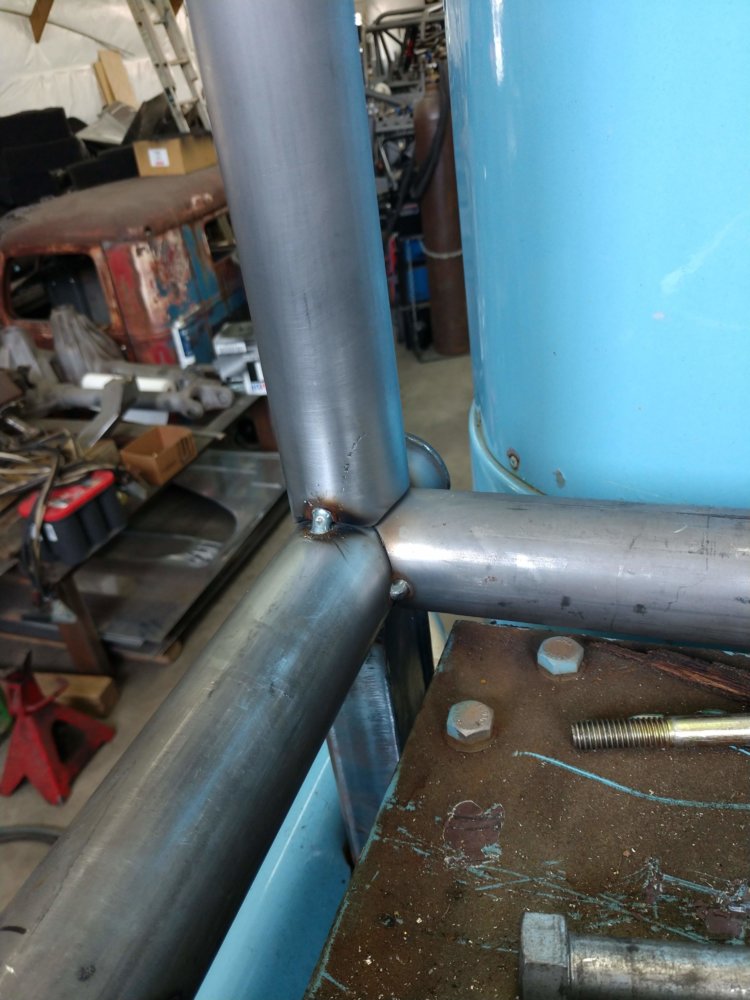

Did a custom roll cage .120 DOM, more for looks and shelving/storage. Found out roll cages/tubing work is my "niche" as I did it pretty good and was pretty quick at it. That was a cool learning experience to build my first roll cage...I like doing tubing work as a favorite now.
Everything is my work that you see, mostly my design with the boss mans input and direction on final outcome. This has been a cool first project for me, I've learned how to do gears, cage, rebuild several NP205s now, learned how to run the CNC table almost good enough.
The biggest thing I've learned in the last 4 months is what I always kinda figured...If I take my time and focus I can do pretty good work, neat, clean, good looking and effective.

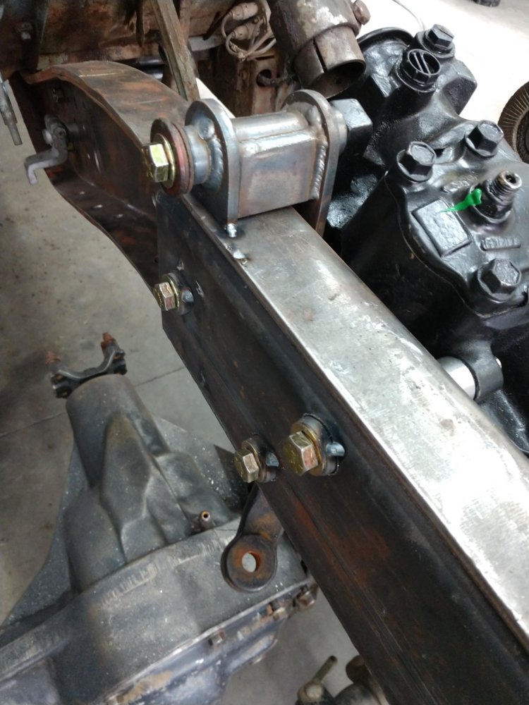

On the tcase, are you doing a full flip on the Chevy 205, or are you adapting a Ford 205? There's adapter kits for that, or I can assist with measurements since I have a few laying around.
Dang John, this is really cool! So glad you found something you love. I'm in the same boat where I am also.
:smokin:
we used an adapter to bolt it to the Th400. it's all in, just gotta get driveshafts made and the other guy to finish all the wiring and dash work and she'll be ready to run almost.

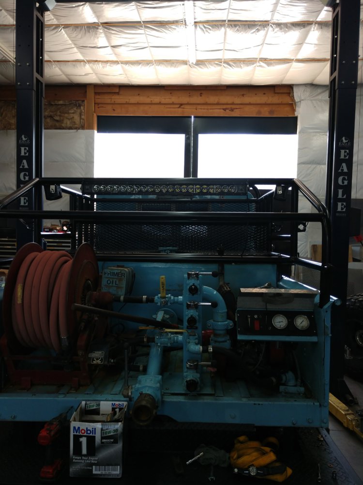

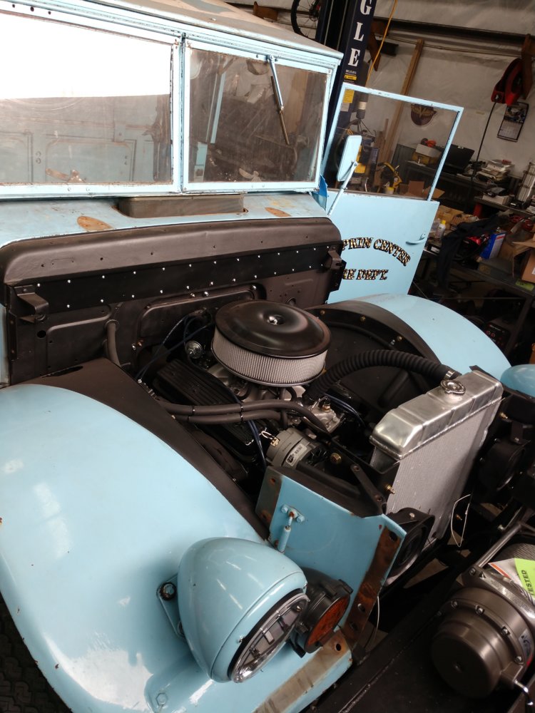

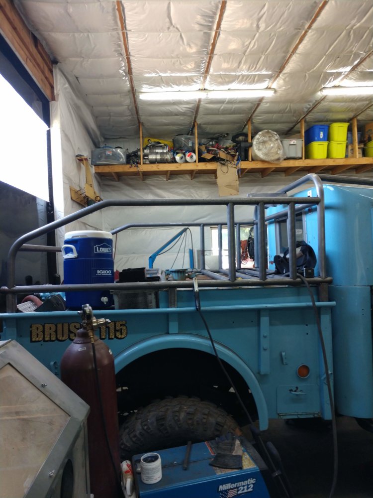

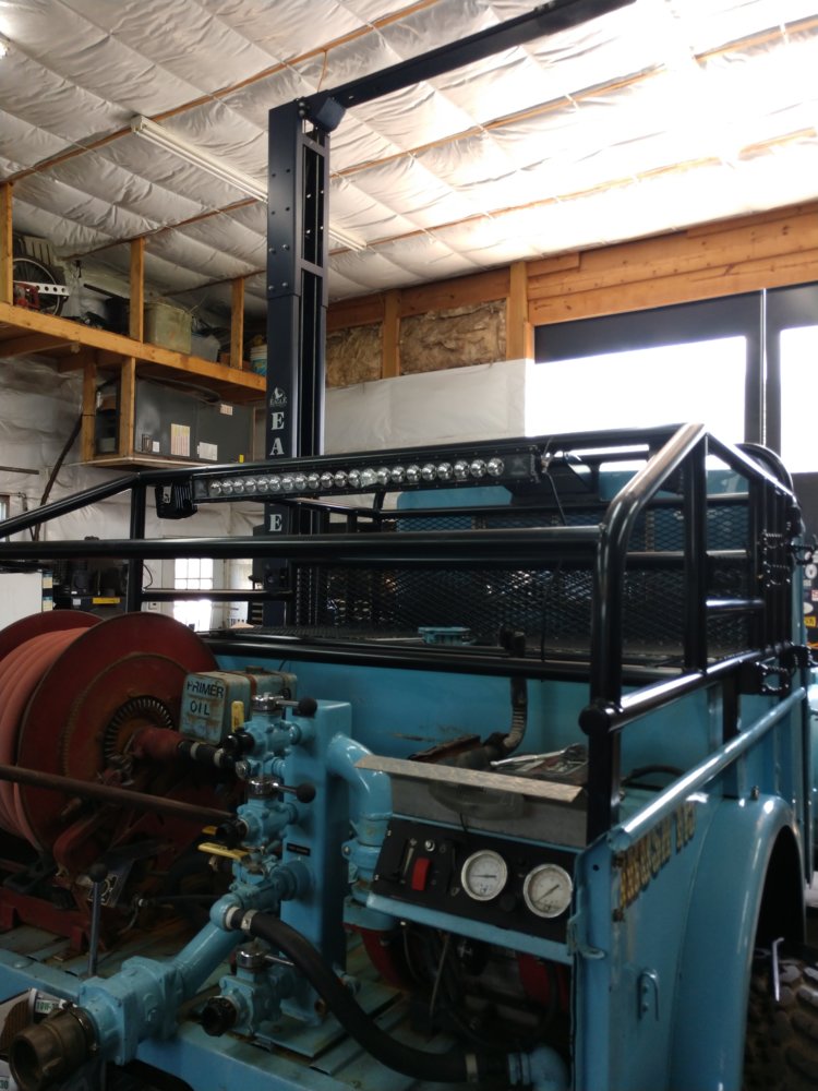

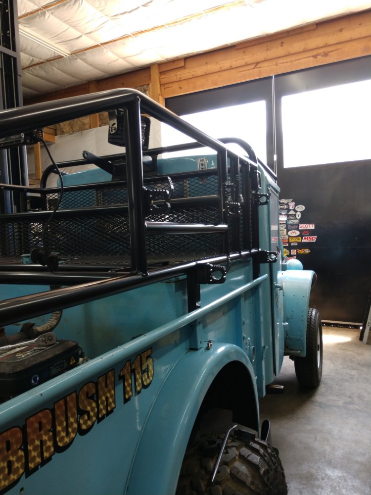

Got roll cage back and installed. Lights mounted and all the little hooks for their tools.

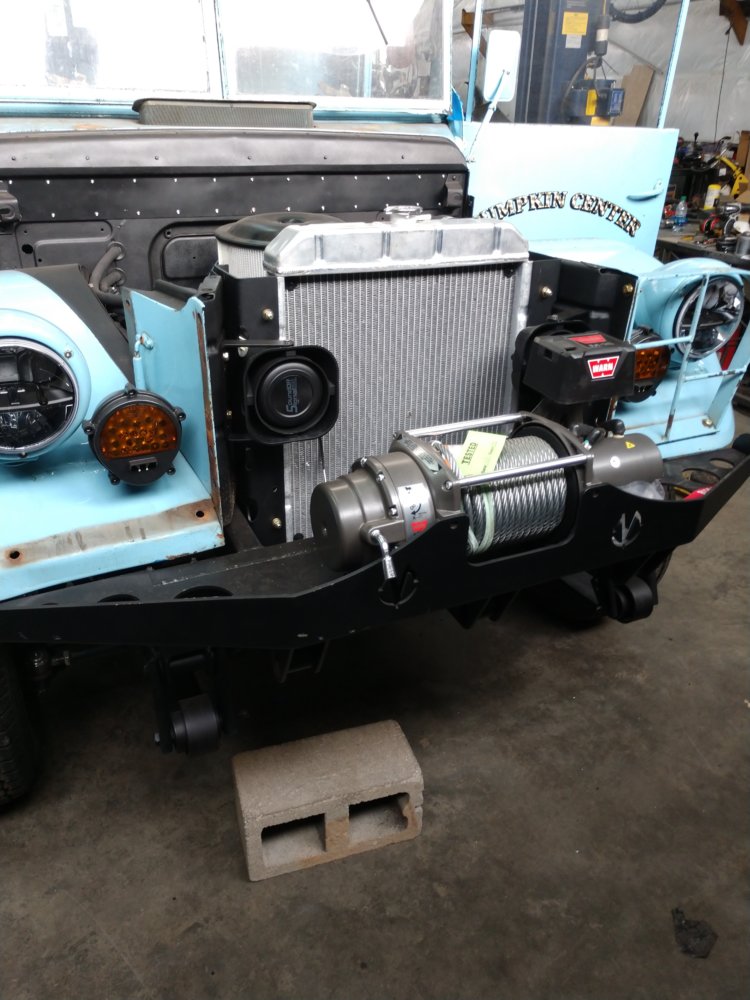

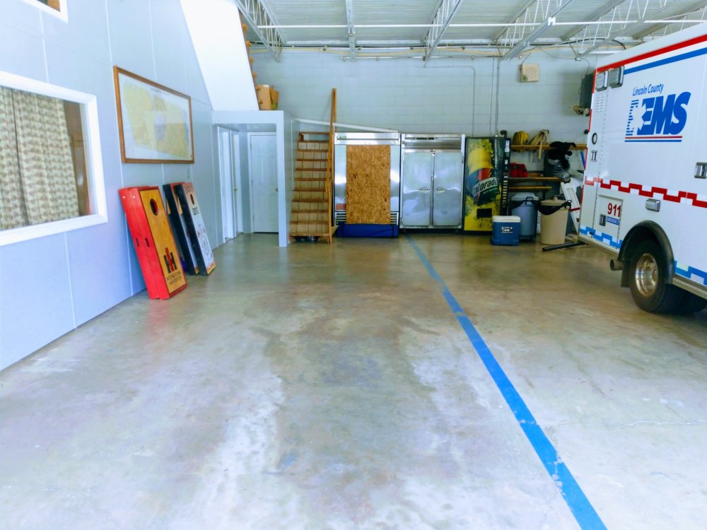

I had a delivery right down the road that the Pumpkin Center FD, is on. Thought I'd stop & see if I could get a Look, at the Brush truck Marty was working on....................... Really? Recon the Shop Can't finish it, without Marty? :popcorn:
lol. sorry dude, I left several weeks ago. My part was done. The interior is what was left on it. I'm actually craving to see the finished interior..it was looking pretty sweet in it's fab stages from the guy working on it. You'll have to wait and go check it out when done (surely that'll be soon)
