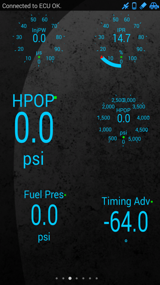

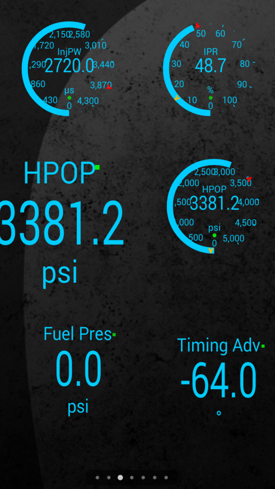

So I am trying to get my truck start cranks and cranks but not start. New cps. Glow plugs.gpr.new fuel pump when cranking getting 3000psi out hoop. Any ideas im thinkibg im missing.
It a ford f450 7.3
Here video
Definitly not turning over fast enough to kick off. I had a problem with both my 7.3s with 246k and close to 400k not cranking worth a damn, had to plug them in at 50degrees, and then the starters eventually took a shit. Replaced starters and they are like new trucks. Have two other friends that have been through the same stuff
