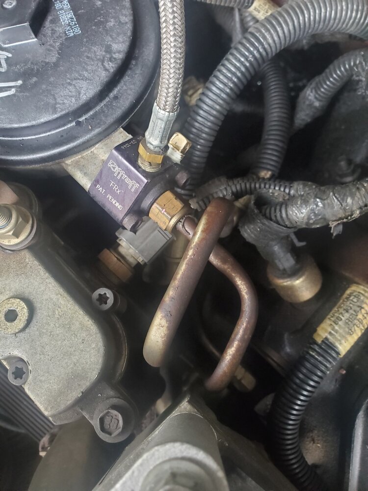

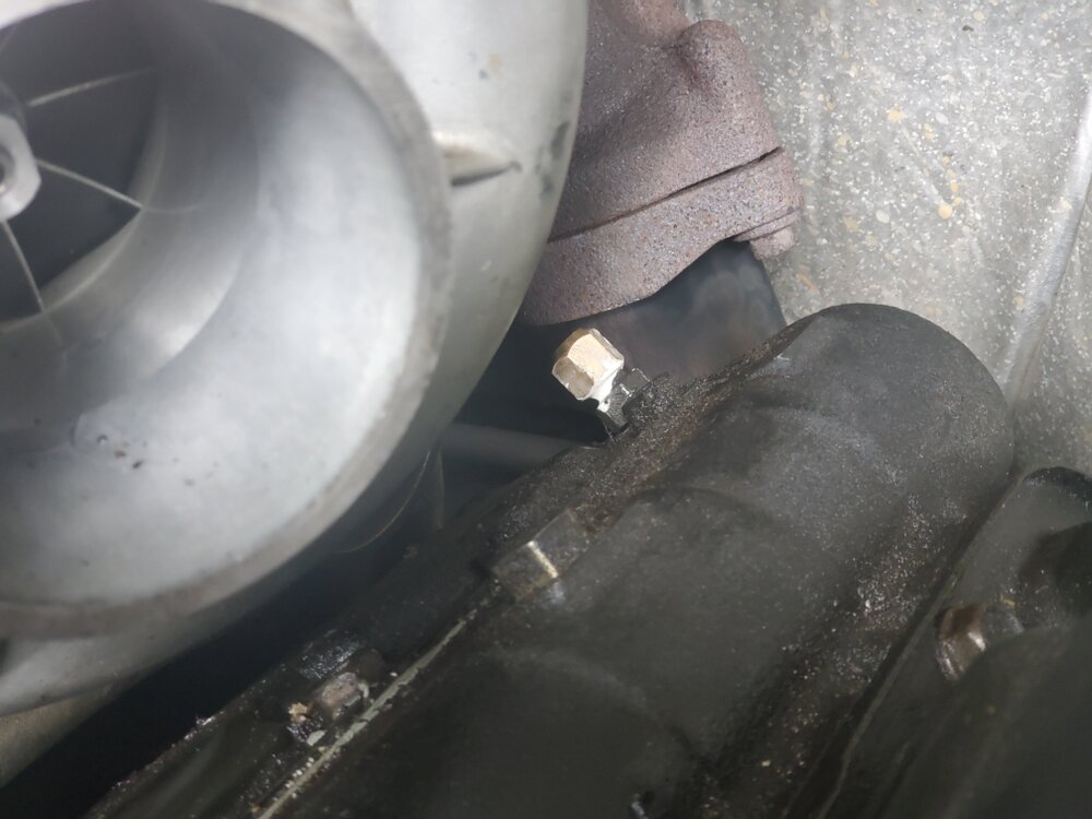

Pics of the housing plug & cap on the test port:
