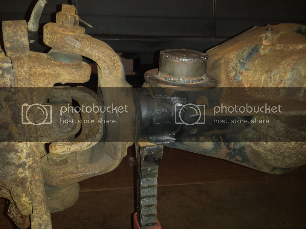

Anyone have any ideas for moving the lower link mounts towards the center on the super duty axles. I feel like my tires are going to rub my lower link bars.

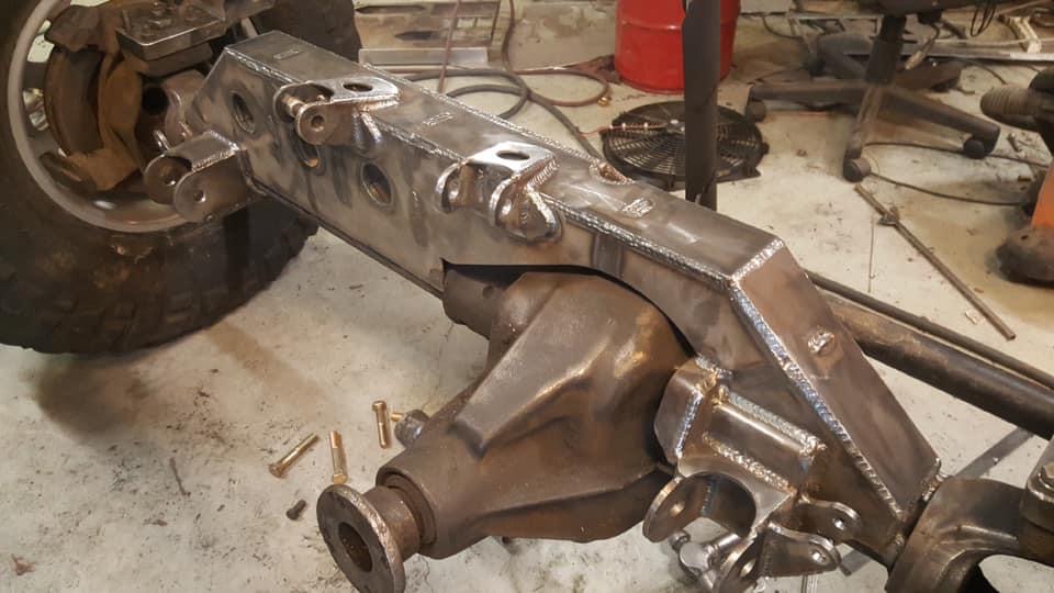

Can you triangulate your lower links frame brackets? I cut like 3 inches of center section casting off of the tube. Basically what artec recommends for their conversion trusses. Just enough room to drop in a link bracket in between the C and pumpkin.
Triangulated lowers and stock ford steelies I won’t have any link clearance issues. These are wide axles to begin with.
Correction. More like 1.5 inch cut.
You could try to locally notch out the casting where you want to put your link mount?

This was my idea. Just to notch out the bottom to move the link mounts in and reweld the housing to the axle tube. That way you don't remove too much housing and weaken the axle.
This is what I was thinking but it’s a lot of work.

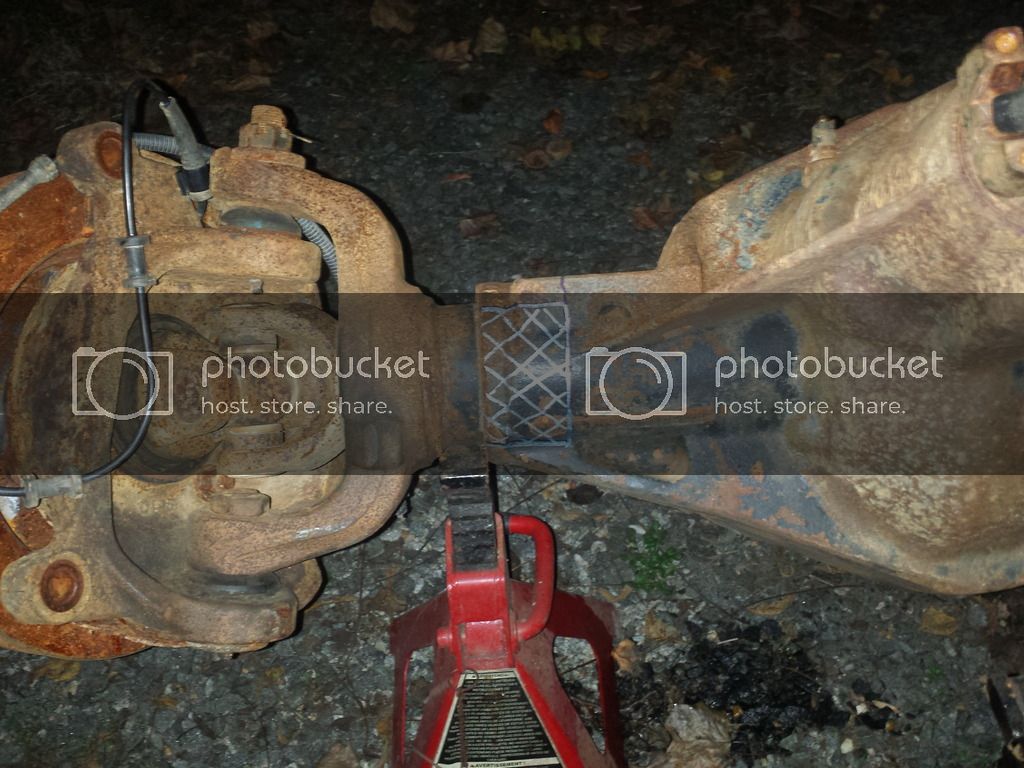

This is an old dodge axle I saw on FB
I think you're over thinking it, moving the link mount inward on the axle only marginally increases your tire clearance. The frame side is where you get the clearance at, and by looking at the Goat built sub-frame they've got them moved in pretty damn far. Plus with as much web-wheeling I've done I don't really remember seeing it being an issue.

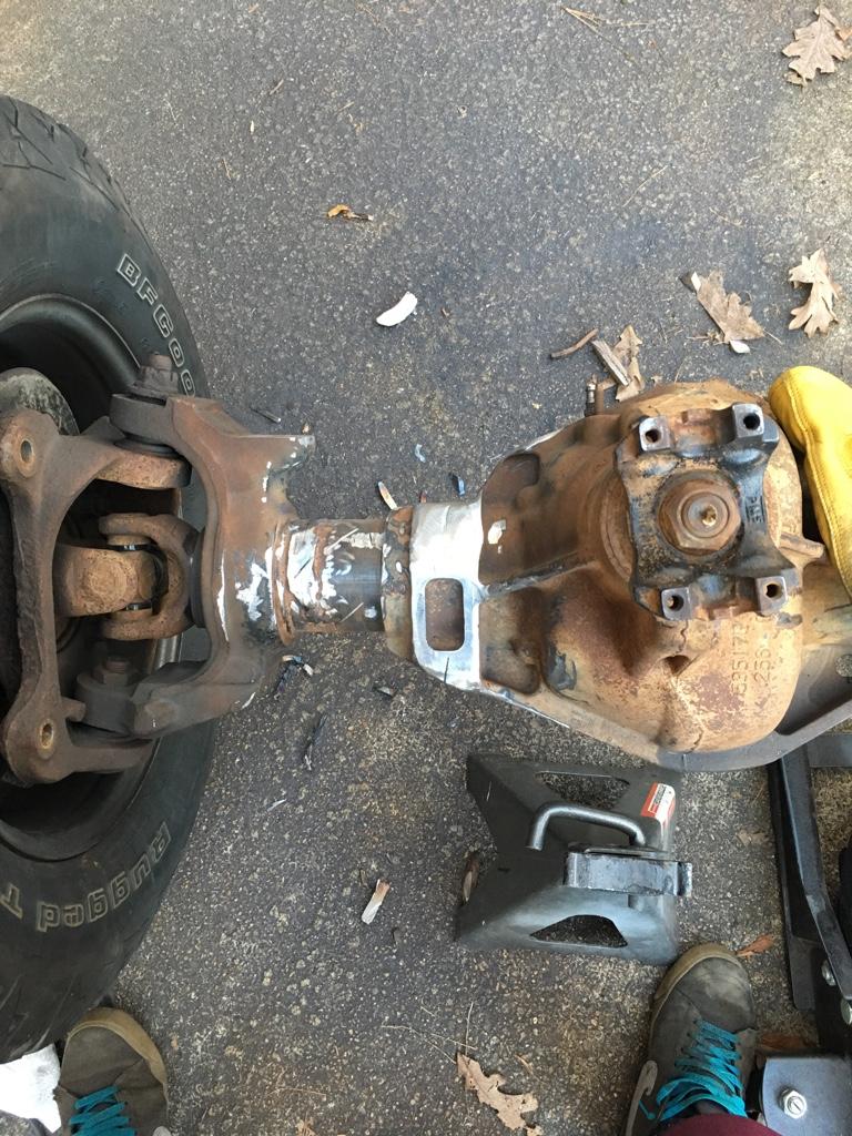

This is a 99-04 axle, but I was thinking more like this.....

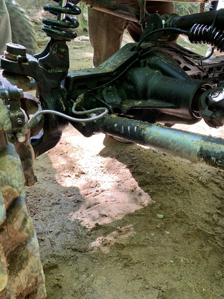

I guess I could just weld to the housing. That’s what a buddy did. Saw him at gulches yesterday.
His tires still rub.
What size tires is he on? I could see 40"+ tires rubbing any sort of link set up for a SD60
40 treps which measure like 38
I’ll be on 43’s lol...
