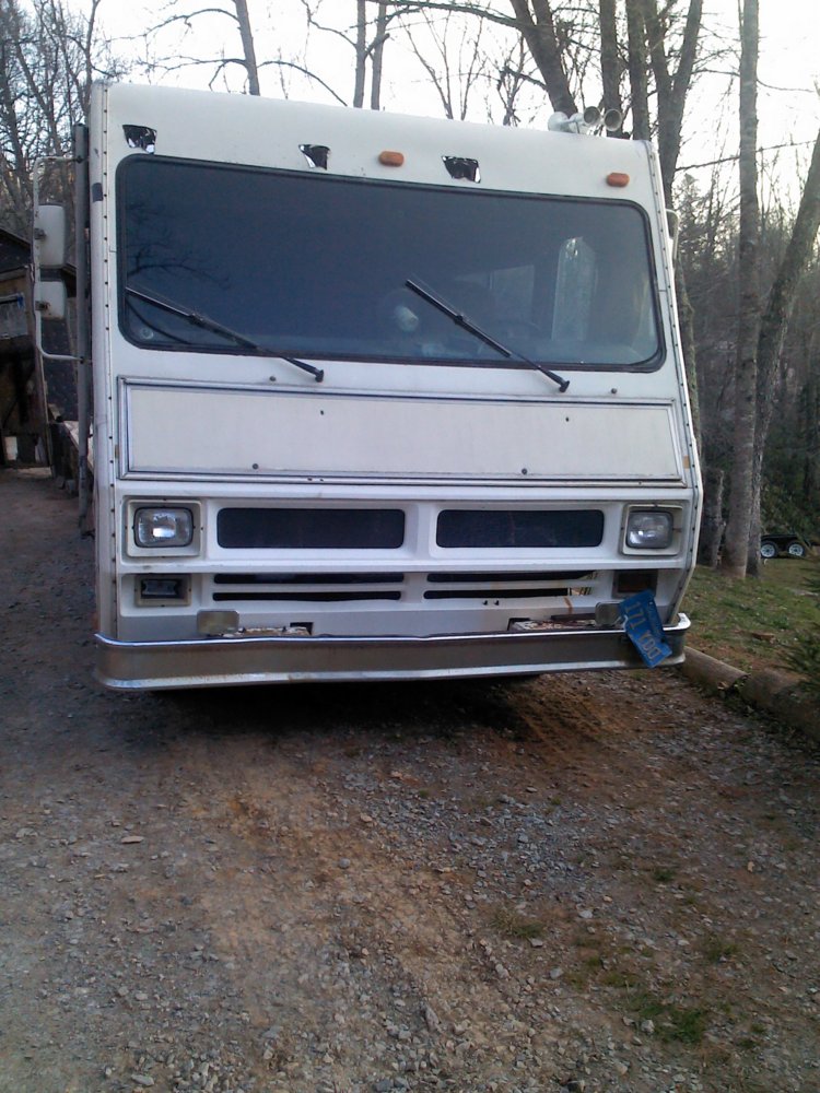

@marty79 can you post a pic of the front? I can't belive there is no way to get to the radiator from the front...
wish there was dude but if it comes out the front, LOTS of crap including cutting some steel out of the way, fiberglass and too much junk to list.
I swear when they built this thing, they didn't care AT ALL about how things will be fixed and removed. They just slapped everything where it could go and dropped the body down on it and done, sell it and let that be the owners probelm lol

@marty79 ok you missed what I said! That big ass removable panel right below the windshield wipers, open, and CLIMB IN! You are not seeing something there IS a way to remove the radiator and trust me it sucks but you literally have to climb in and twist you body like a yoga master. I couldn't stand up straight for an hour after I worked on one..
OHH ha ha ha ha ha THAT THING haha very funny sir!! With my bad knees, NO CAN DO for this guy. Not worth me throwing out my knees/locking them up again. When this happens, I can't walk or bend for almost a week last time and I would (no joke) get stuck in there not being able to get out once my knees lock up (yep they are that bad lol) so I have to find different ways to work on stuff that is easiest on my knees to avoid this.

Snagged a front-end pic from the other thread....
Zoomed in, it looks like a horizontal seam the the lower corners of the 'hood'. Looks like that panel from there down removes (grill/headlamp/parklamp area)?????
rv-phase-1-front-outside-jpg.213887
It looks like it but it doesn't. Thanks for all your help bud. I got it done today and wasn't that bad from the inside actually. Once I removed the air cleaner, the big huge compressor and bracket, alternator and bracket, all the heater lines and a/c lines and some other crap, it was pretty easy from there on as far as water pump itself goes. surprisingly the shroud and fan came off pretty easy out the top inside so I think the radiator comes out through the inside too for when that has to come out someday but it looks really good on the outside.
