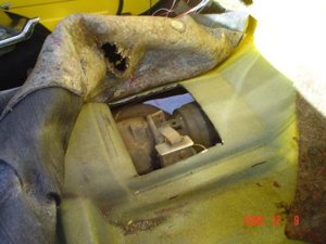

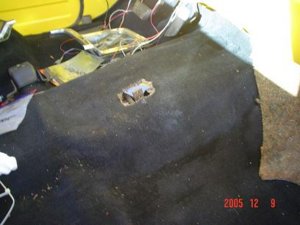

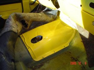

Here are those pix of the tunnel area. It is still work in progress but it appears that it is going too work.
