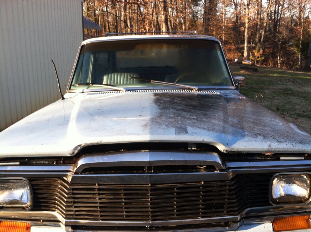

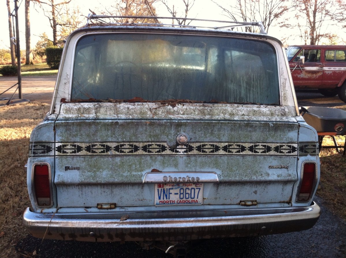

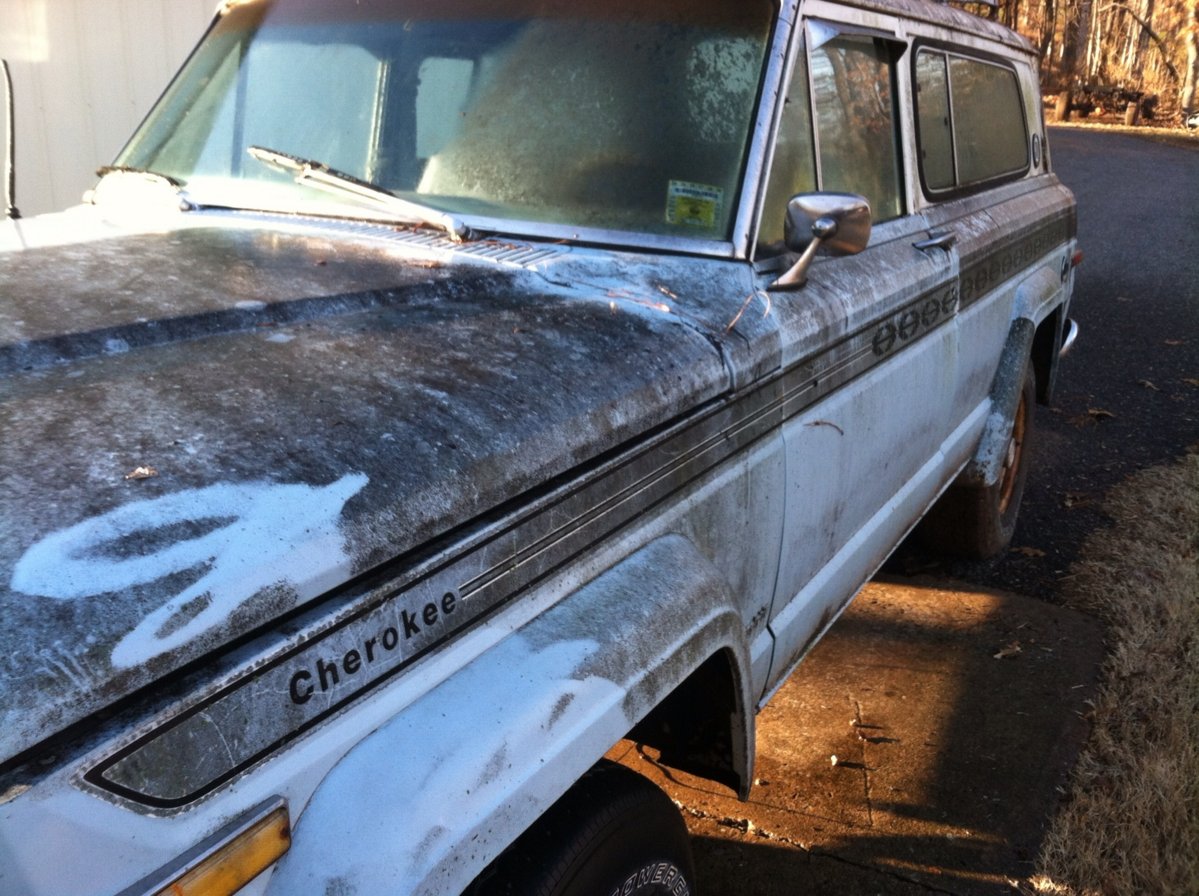

This is how it looked when I pulled up to the shop to hit it with the power washer.

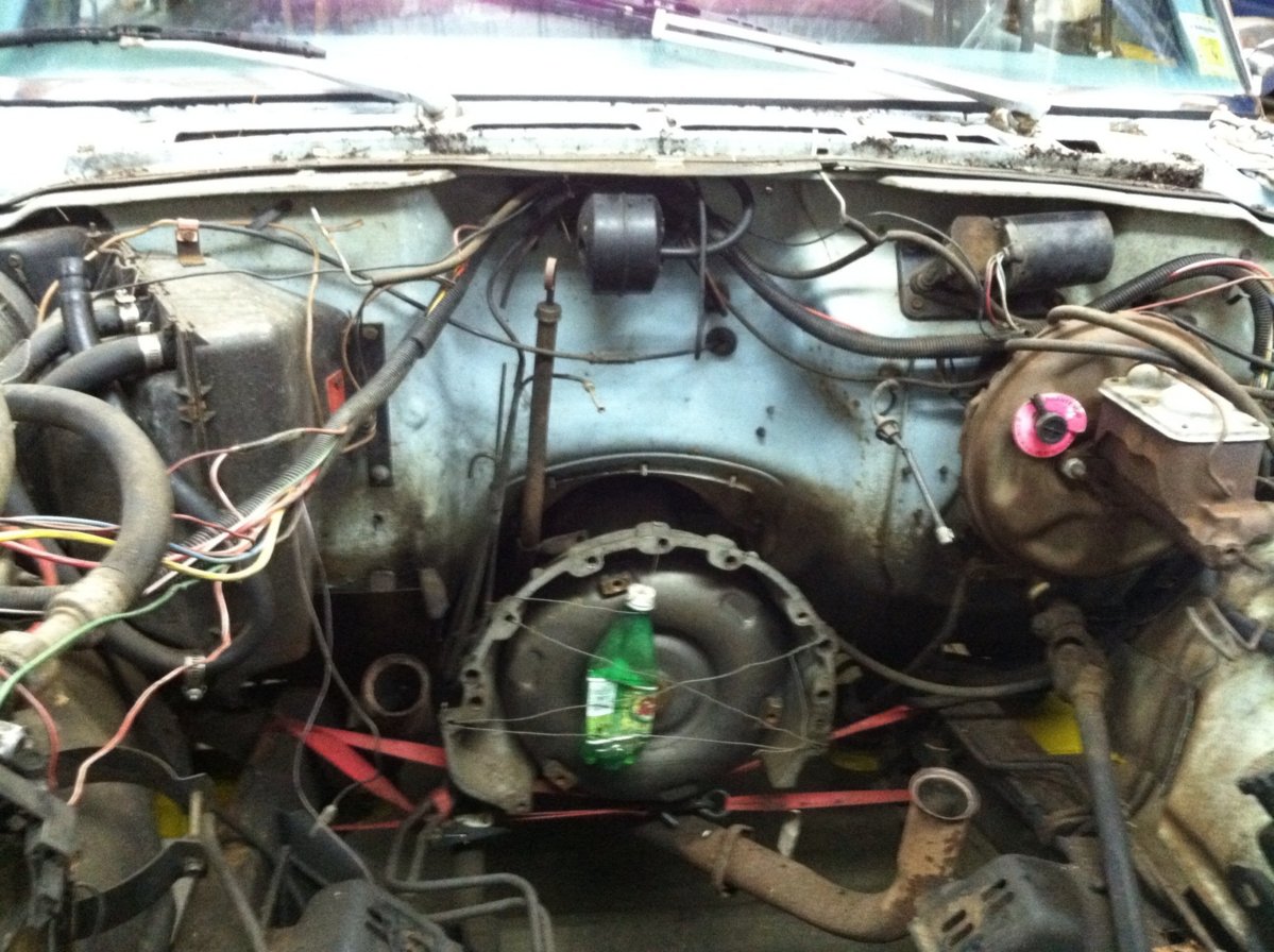

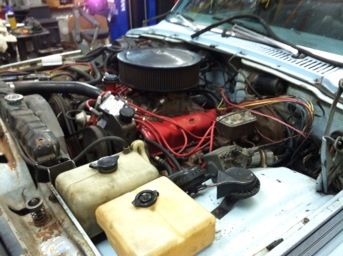

the engine bay

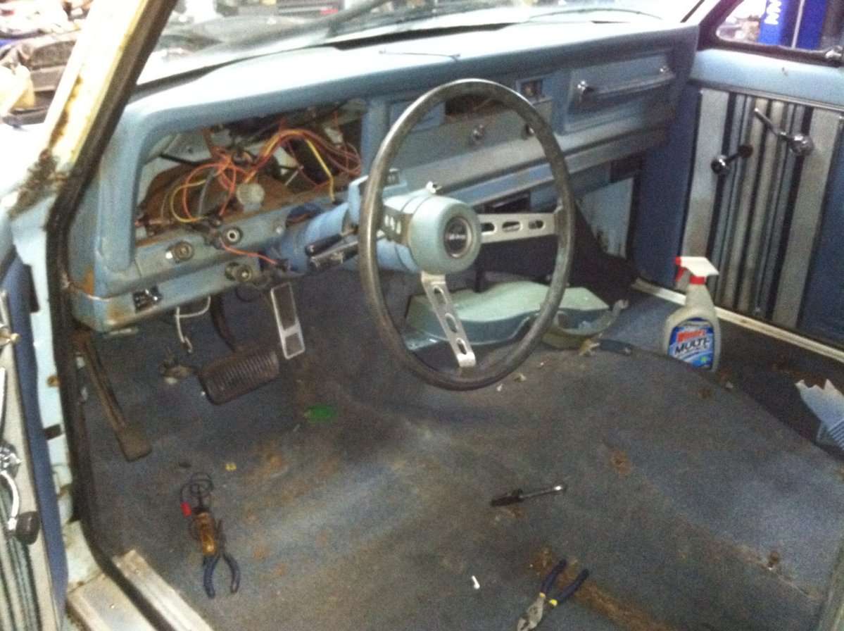

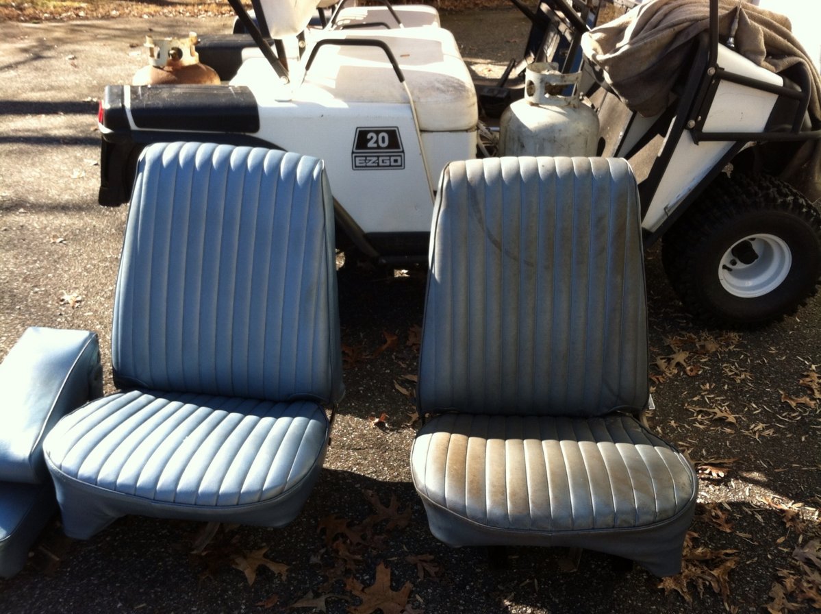

seats before and after some scrubbing.

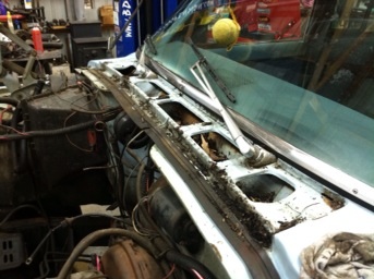

removed the cowl screen, what a mess...

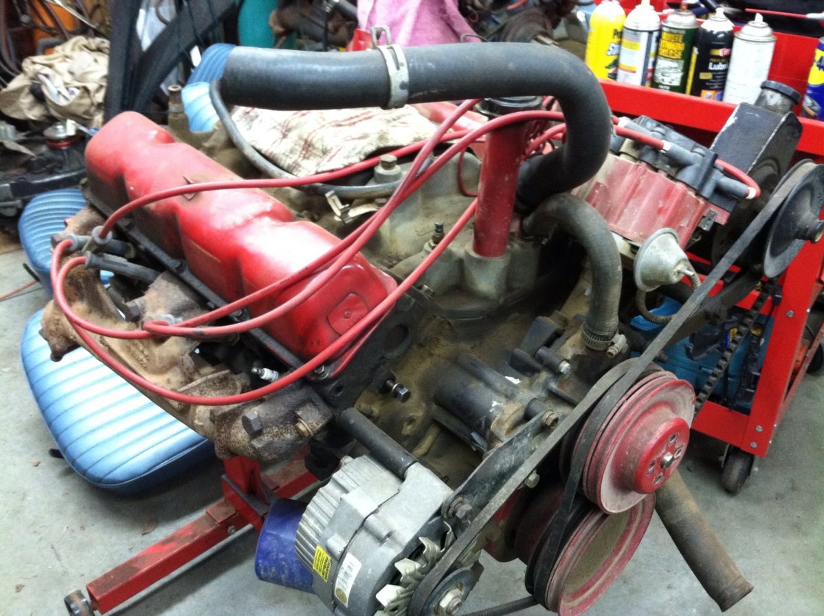

The engine that has been setting on the stand for a couple of years.

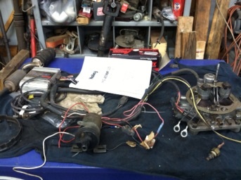

Holley TBI kit

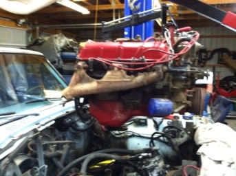

engine on it's way in.

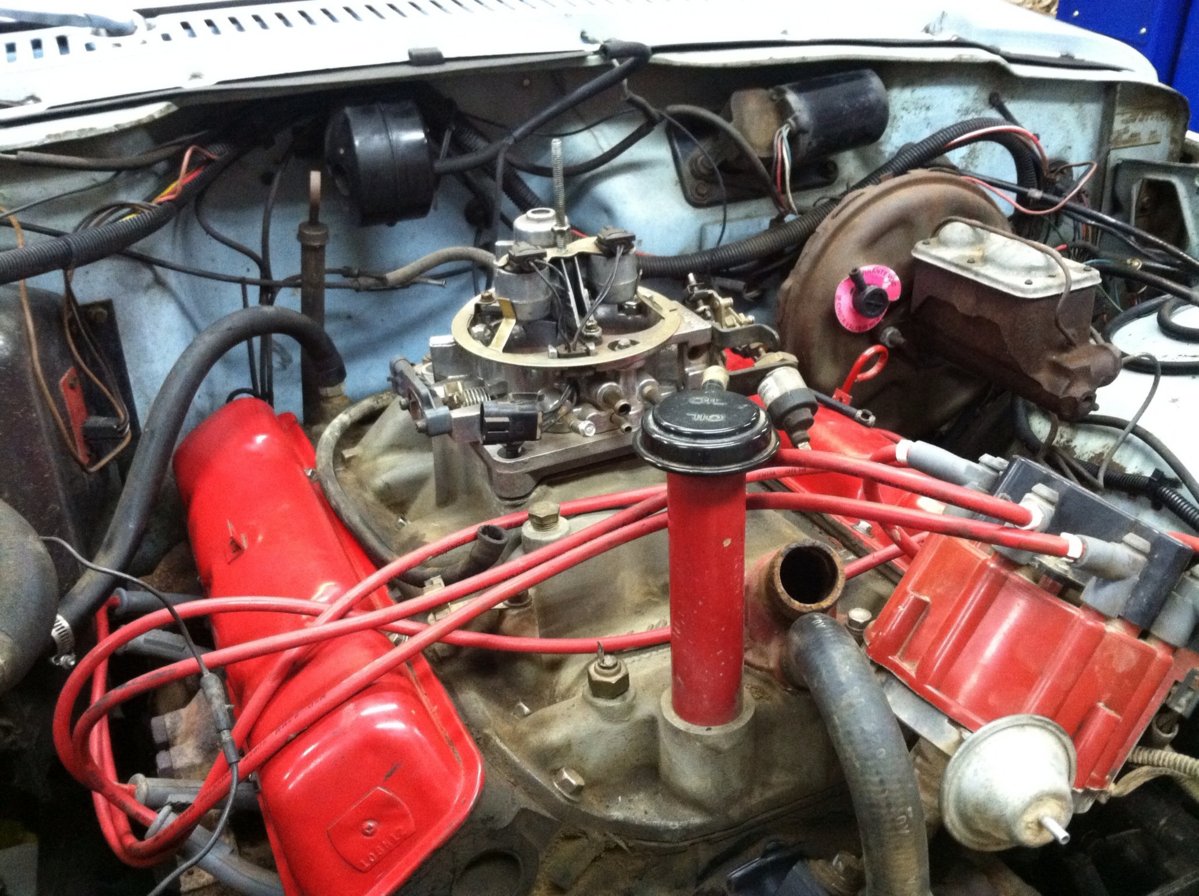

engine in with throttle body test fit.
standalone

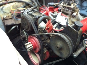

adding the accessories including AC
standalone
engine installed, need to clean up the wiring next.
standalone
Got the engine bay wiring all sorted out, old/non-used wires and spark box removed and add new plastic wire covers to the harnesses. As I highly suspected, had to order a new gas tank, sending unit and fuel gauge before firing up the motor. So on to the interior wiring. Pulled the dash gauges out to check,clean and inspect bulbs as well as check all the vacuum hoses for the heater/defroster switch.
