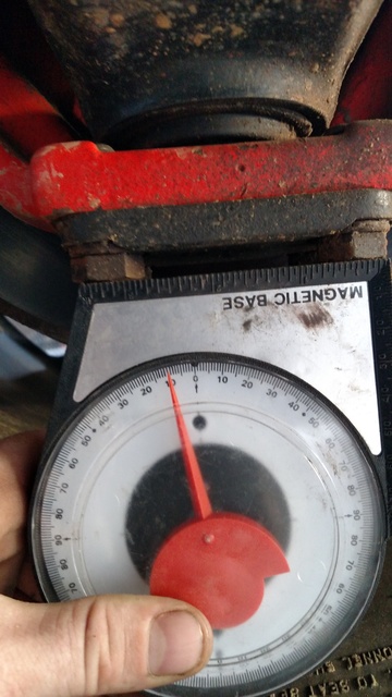

I did a solid axle swap on my 99 Silverado and used a 79 Ford 60 and a 2500HD 11.5 AAM rear. I set the caster at 3* which works great and is a decent compromise with my pinion anlge since the transfer case is flat from the factory in the Silverado. I did swap to an NP241C with a JB Conversions SYE, but that's beside the point.
With the caster set at 3 to 4*, as it is now, my camber is around 2* positive. I'd like to be fairly close to zero or possibly a small amount negative, but certainly not positive. I seen offset bushings for the uppper kingpin and the adjustable lower kingpins and I don't want to use either because as the upper bushings wear out I'll lose my camber and the lower adjustables won't stay tight.

So, as an impulse buy, I snagged some Reid Racing knuckles for my HP60. Guess what! No more positive camber issues! All of the Reid Dana 60 knuckles are apparently the same castings/forgings and they just drill a 5 bolt pattern in the ones for Fords. Upon further measuring, I found the spindle face of the factory knuckles to have been causing my issues. If any of you other guys have the same issues and are using stock knuckles, ditch them for some Reids and it'll solve your problems!

8 degree of caster? Good Lord...you only need 3 degrees or so on a Dana 60! My problem was camber though. Tops of the tires were leaned out 2 degrees. I must admit, with the 2500HD brakes up front now, it damn sure stops better too! It also looks much cleaner and is easier to work on and find parts.
