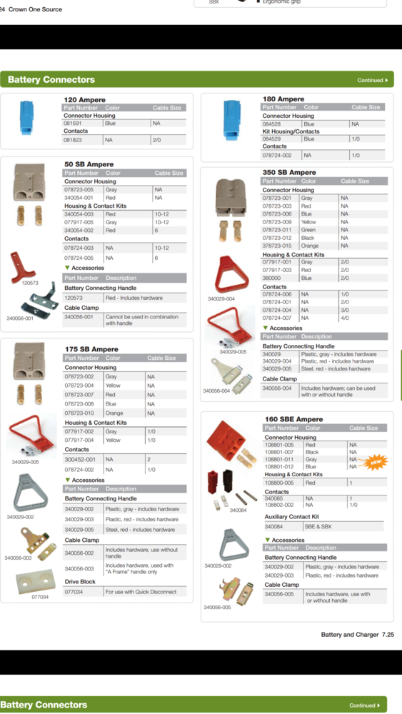

For the disconnect, if you want a plug type go to Crown Lift in concord and ask for the blue disconnect that are used on a "M" model..
the top blue one is what I am talking about..
Those are Anderson connectors if you need to describe what you're talking about to a parts person. There are a few brands that make them, but they're generically known by the Anderson name.
