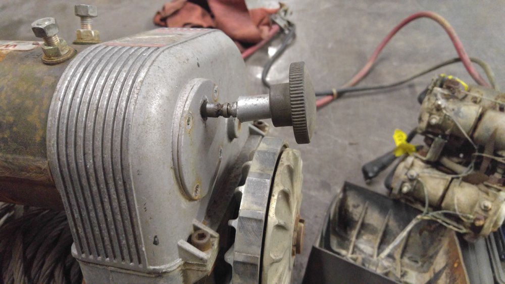

First no shift for the free spool.

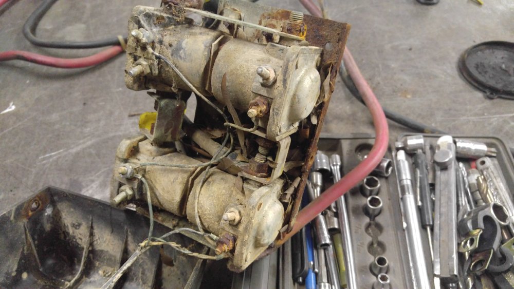

After rolling it around a bit the cables are decidedly horrible. So I decided to peak under the black box.
Par for the course. Full of leaves and mud. She's pretty crudded up. All points are corroded. One of the control wires is completely bare and green with envy of younger days.
Me thinks she may be fully functional as advertised but only for a short time. Any decent use and she'd be smoked.

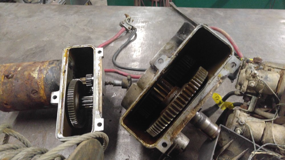

Well wrong so far. So why not open her up?
While she wasn't plum dry what was inside wasn't pretty. Smelled rancid. Had the consistency of pond scum and filled with nasty bits of grit. Over all Its just yuck. But very little rust so a bit of hope.

Replace the bottom seal and the spool bushing while you have the case in two.
