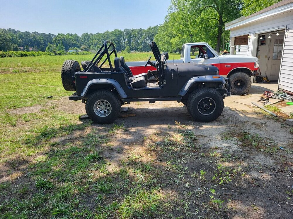

A friend @Albert77 recently traded for a 84 CJ 7 with the 304. Like most old jeeps it has some things he's like to change. I pointed him this way but can't seem to find his thread. So I thought I'd try and increase my knoledge and help a friend. First thing is he says it has a tiny electric fan and he'd like to go back to stock. It's over heating. Second is the 3 speed, which he'd like a more streetable 4 speed or maybe even a 5 speed. Plan for jeep is URE trips and camping trips with his wife and son.
Said Jeep.
