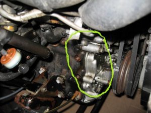

My almost stock (205,000 miles) 22re 4runner is leaking oil bad all of a sudden. Its got it all over the front of the motor and dripping off the front axle, rad hoses etc.. Oil level is full, radiator over flow is full, brakefluid is full. It doesnt smell like anything (diff fluid etc..) I need to find an honest local (Greensboro/High Point) shop or individual to help diagnose problem. Here is a few pics (green circle is where I see the most oil.)

The leak you are experiancing is the oil pump blowing oil past the sealing gasket on the front of the engine.
Oil pump is right behind the harmonic balancer, bolted with 5 bolts
Remove all belts, remove balancer, remove oil pump, clean, replace "O"ring seal and balancer seal, reassemble, CAREFULLY tighten the bolts for the pump, the timing cover can strip easily, and keep track of which bolt goes were, there is one short bolt that goes in the top hole, if you use a long bolt, it'll go thru the cover, possibly hitting the ting gear and chain.
This is a very easy fix, you want to ask for a timing cover gasket set at the parts store.

I got the timing cover gasket kit, and started to pull things apart. I dropped the oil pan and found a bunch of plastic pieces in there...that makes me really leary of what I will find. I next tried to remove the crank pulley...not happening! I cant get that thing to loosen....Ive got an appt. to have it checked Monday morning...I guess I wimped out on this one.:gay:
ok, for your oil leak, you DO NOT have to pull the pan or the whole front cover. just the balancer and the oil pump.
BUT, since you have already pulled the pan, what you have found are what remains of the Timing chain guides. NOW, does your engine have a rattle to it at idle ? similar to nails in a coffee can ? If so, you'll need a timign chain set, we'll get to that after you check it out.
Pull the valve cover off, look down the drivers side of the chain, you should see a guide there, IF the guides have been replaced, it is possible the pan was not pulled to remove the debris, not uncommon, and usually causes no issue other than make the guy who pulls the pan off and is unaware of this issue kinda nervious. ( factory pan is sealed with grey sealer, if this is the case, your engine may never have been apart before, not unusual)
at 205k, I would think the guides and chain have been replaced at least once. If you are hearing no rattelng noises, don't get real concerned.
DO check the guides, maybe the previous owner was smart enough to replace the plastic guides with rubber faced steel guides. if so, no worries for awhile, though I would keep an eye on the chain. ( they do wear and stretch and break)
As for the balancer bolt, 19mm short socket, long breaker bar ( 1/2 drive preffered)
put socket on bolt, lay breaker bar against the drivers side frame kinda wedged by the steering box. be sure truck is in neutral, set parking brake, PULL COIL WIRE from cap or coil ( you don't want the engine to start, especially with oil pan off ), get in and TAP the key to turn the engine over, this will break the bolt loose.
remove bolt, balancer should slide right off, be sure to keep track of woodruf key, it may fall out.

Got the engine cleaned up enough to find that it was leaking from the crank seal. Replaced seal and went ahead and replaced oil pump seal, water pump and belts...seems to be doing fine...Thanks for your help!!!:beer::beer:
