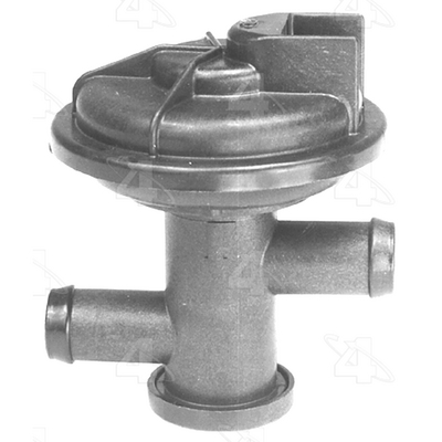

There should be a valve in line with the hose for in coming water to the heater core, check to make sure that valve is in fact open and not packed solid with, mud, rust, sealer..ect. btw the valve will be under the hood, not sure on that year if it is vac. Operated or cable
Should look something like this...
