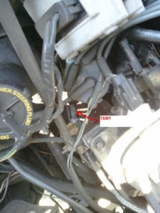

do you see it in this picture?

From your picture, I don't think that's the module. I will look u a pic for you... hopefully. On a side note, I also had a plymouth sundance with this problem. It turned out to be a hairline crack in the distributor cap. It might be a good idea to replace the whole dizzy and see where you go. Back in a moment with the picture, maybe.
Took it out. Module is there. New tfi module in tomorrow. We will see. Thanks for the advice.
