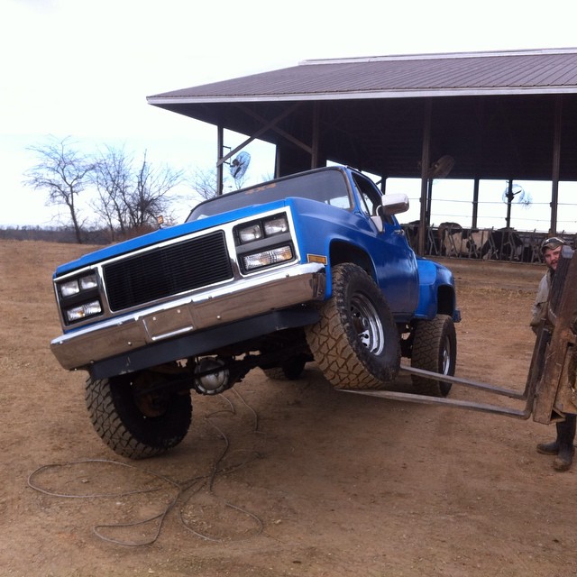

i bought a 86 gmc k1500 with a built motor guy told me battery was bad. i put a brand new battery in it and last night my headlights got dim and went out on my way home. i replaced alternator tonight and charged battery made it 2 miles up the road and lost everything again anybody have any insight on my problem? picture of the truck

Below 13 runnin . but everything tested good. im stumped. and yeah thats me peeping lol. and ill try it and take negative off
