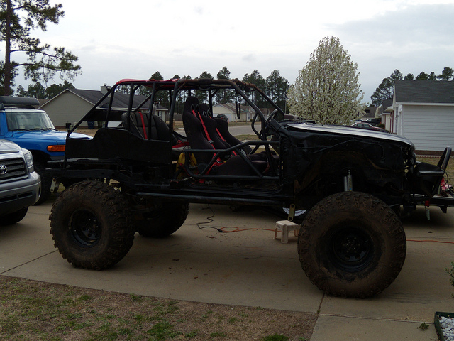

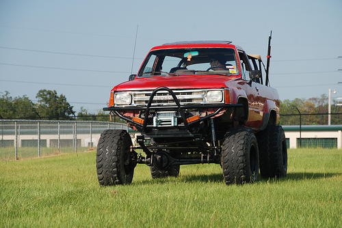

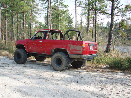

This is my 4runner build, from start to now has been about 3 years. Picked it up from a neighbor for $1500, its a 86 4runner with a stock 22re, it had a 3" BL, 33" Super Swamper TSL, and Rancho suspension when I bought it.
First things first SAS

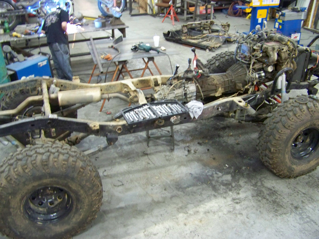

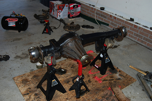

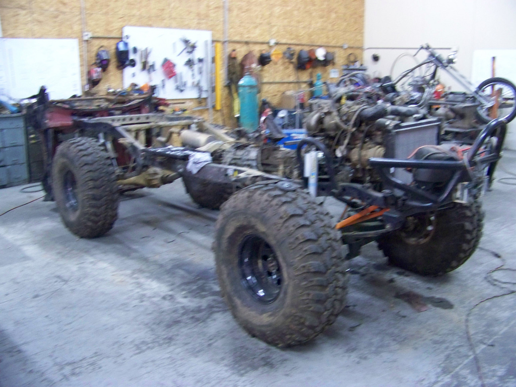

SASed with the All Pro kit and All Pro springs all around

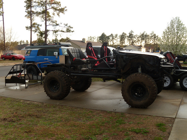

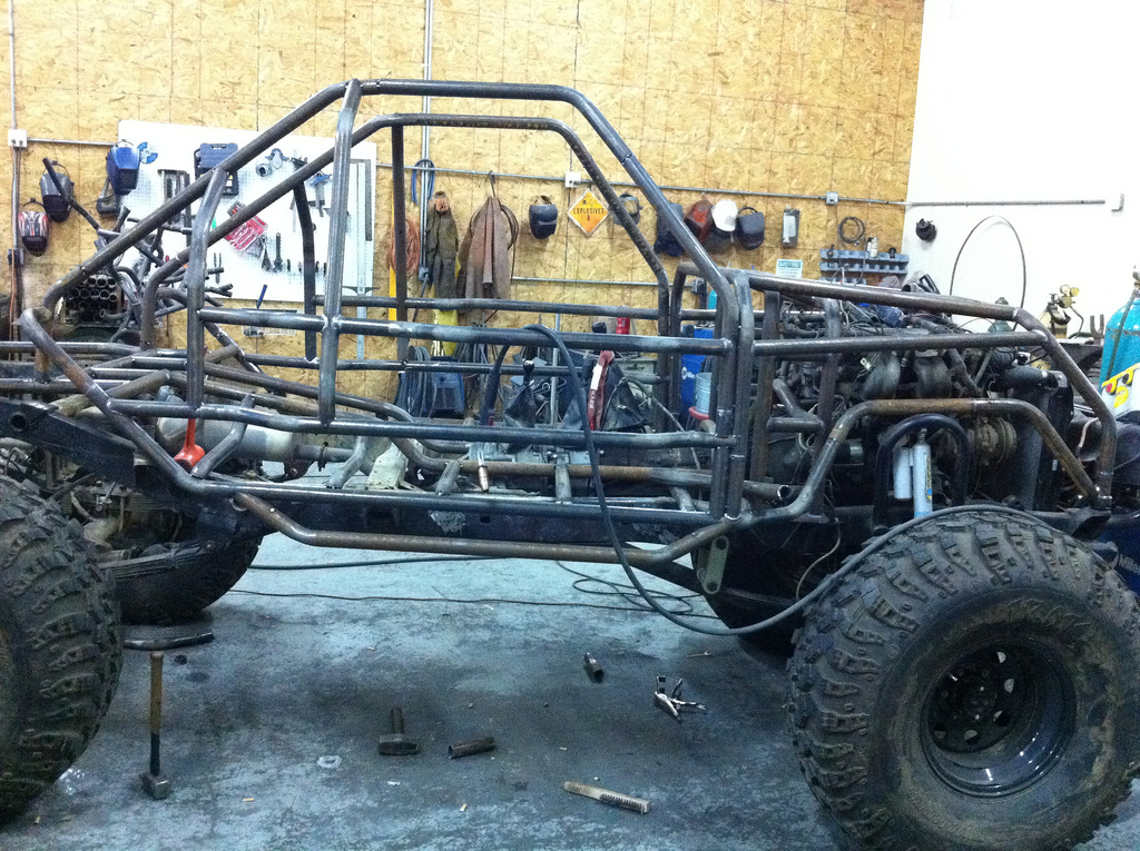

Internal cage ready to go in

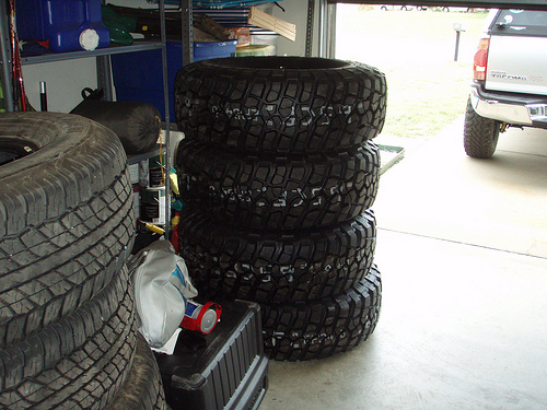

New shoes 35" KM2

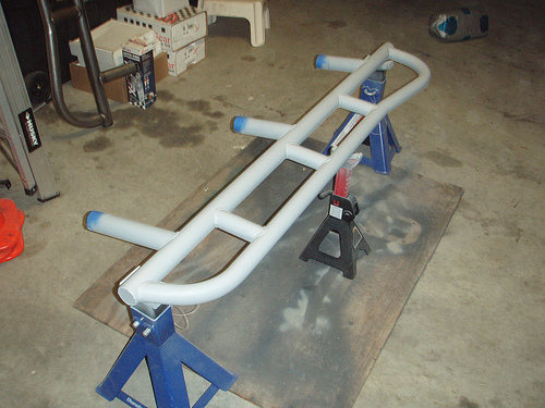

Sliders

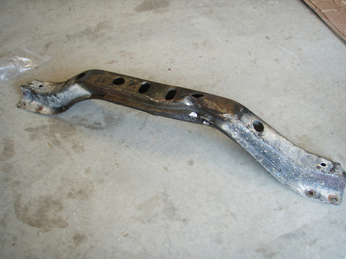

Old beat up cross member
New cross member

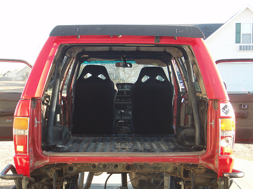

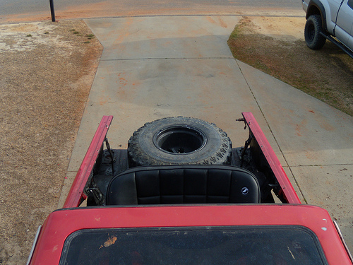

New seats

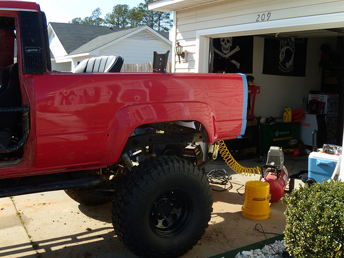

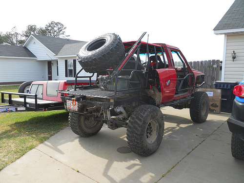

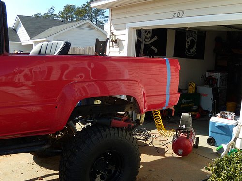

Bobbed
Dove Tailed

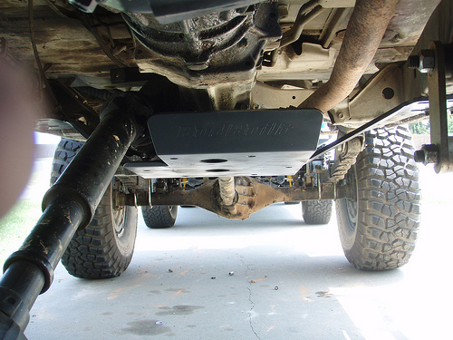

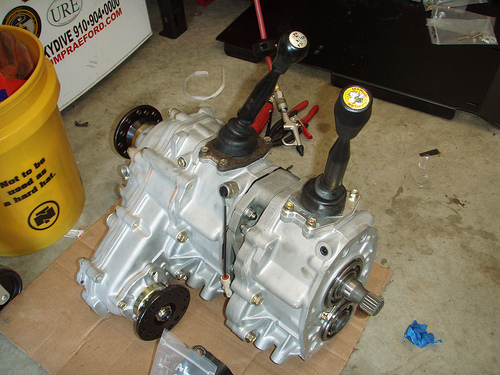

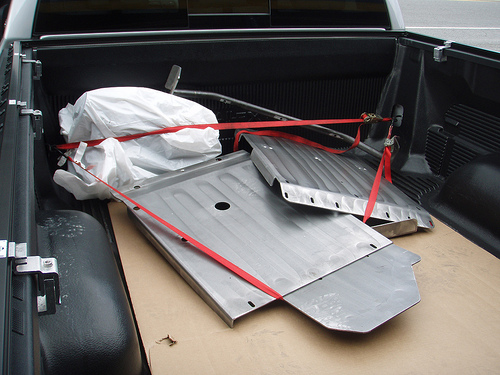

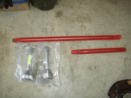

Took the crawler hauler over to Bud's to pick up full FJC skids, and the mystery bag.

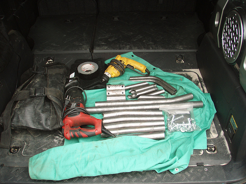

Mystery bag contents

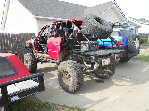

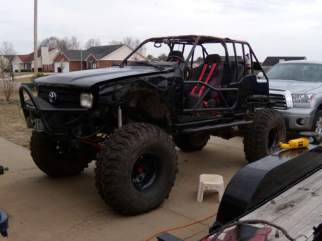

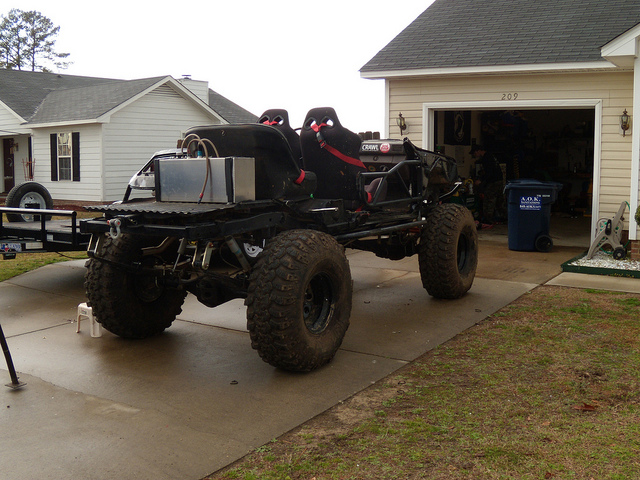

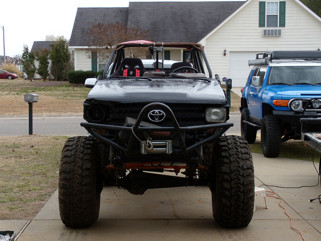

This is how it sits now, 4.88 gears, Detroit locker F/R, and rear cage
More to come :flipoff2:
Awesome looking rig. Looks like you could run at least 37's in there, though.

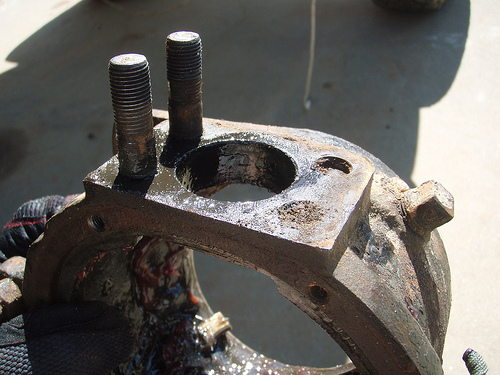

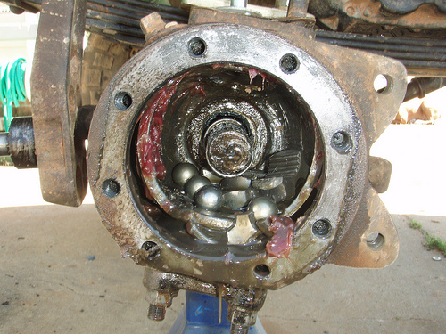

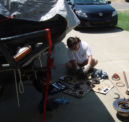

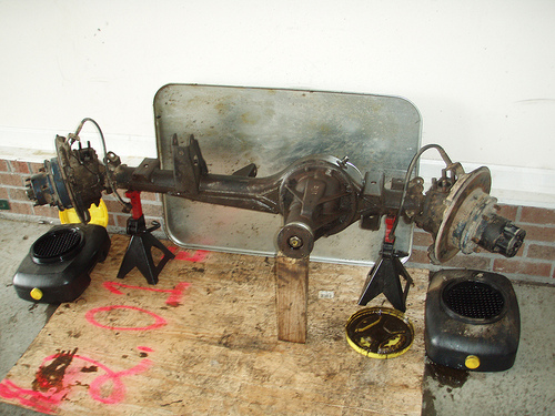

After my last run in URE I discovered I needed to shave my inner axle balls a little more for the dirty 30s. When I turned hard passenger or hard drive I could hear the crazy metal on metal rubbing, so I broke down the passenger side and got to grinding while my wife broke down and shaved the driver side.
thats awsome your wife is helping you.

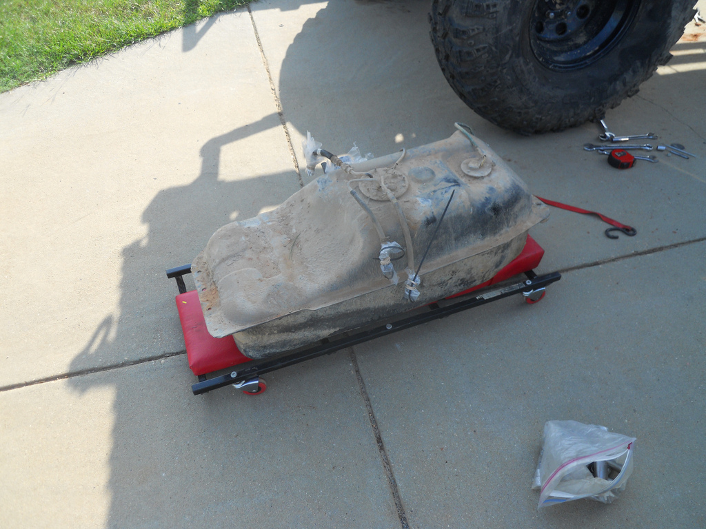

Got this guy removed and relocated to the back, no more rock magnet.

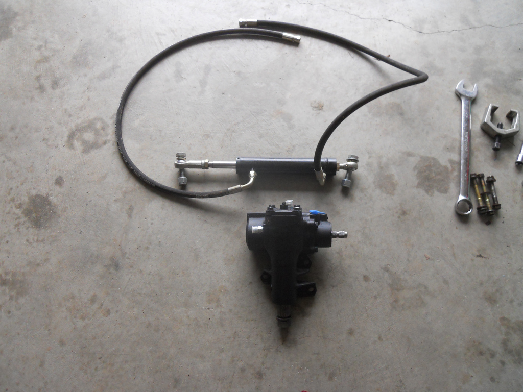

Hydro assist brackets welded up. Pump, lines, and tapped box ready for install.

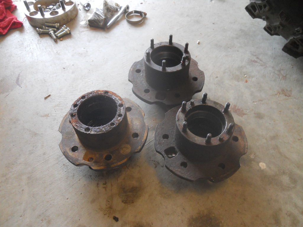

Replaced my passenger side axle hub after breaking it in Harlan. Thanks sgtbriangreen for the parts.

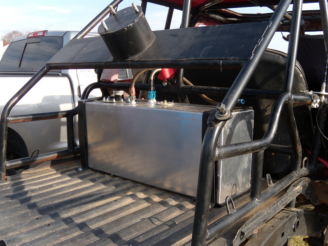

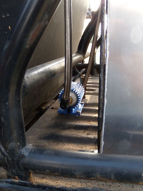

New fuel cell
Got a new 15 gallon RCI fuel cell, and a new electronic fuel pump. This looks a lot better than having the stock tank in the bed held down with ratchet straps.
