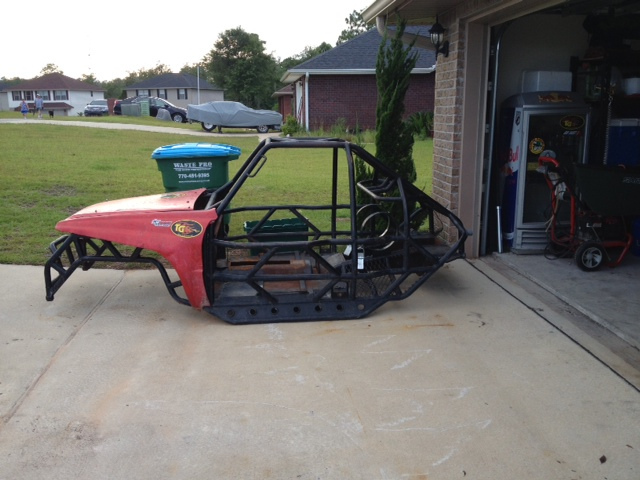

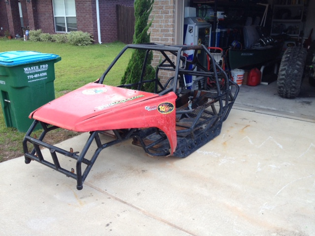

Anyone want to buy a Toyota buggy chassis?

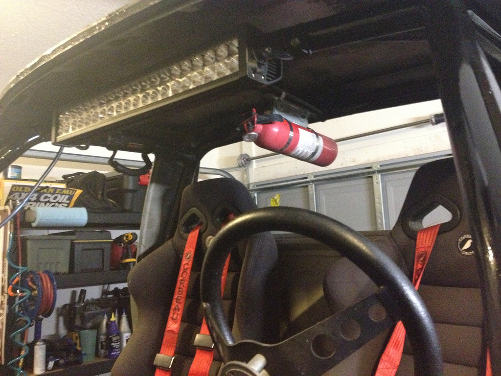

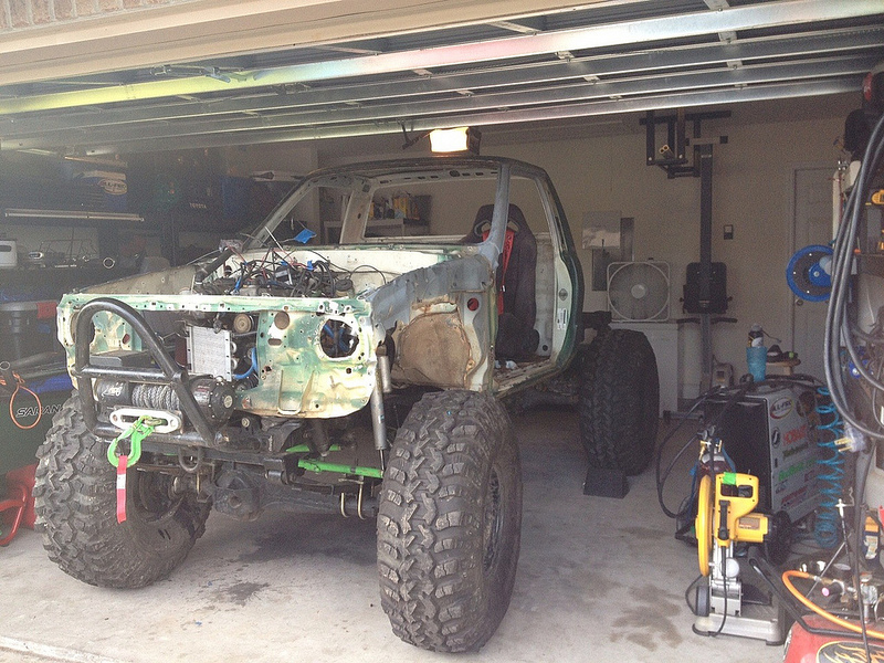

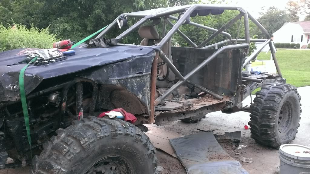

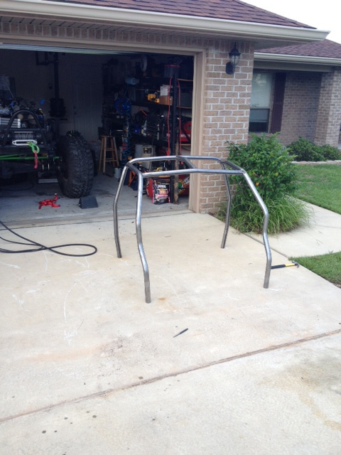

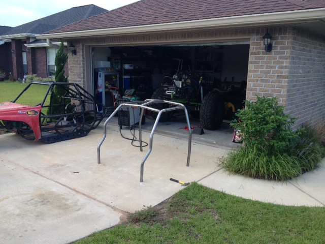

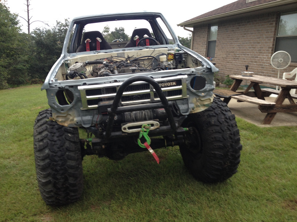

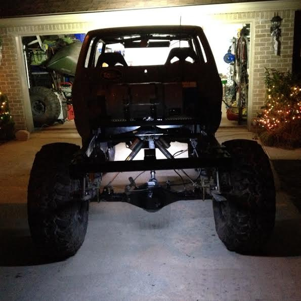

My new internal cage being tacked together.
The cage is the 4xInovations regular cab internal kit. I will be adding a dash bar, 2 front spreader bars and a rear cross bar to attach my 4 point harnesses.

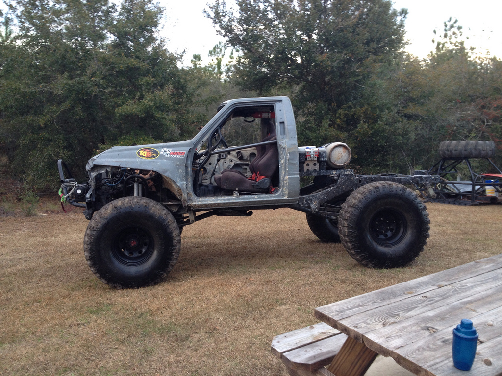

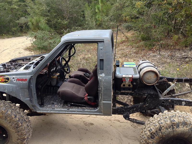

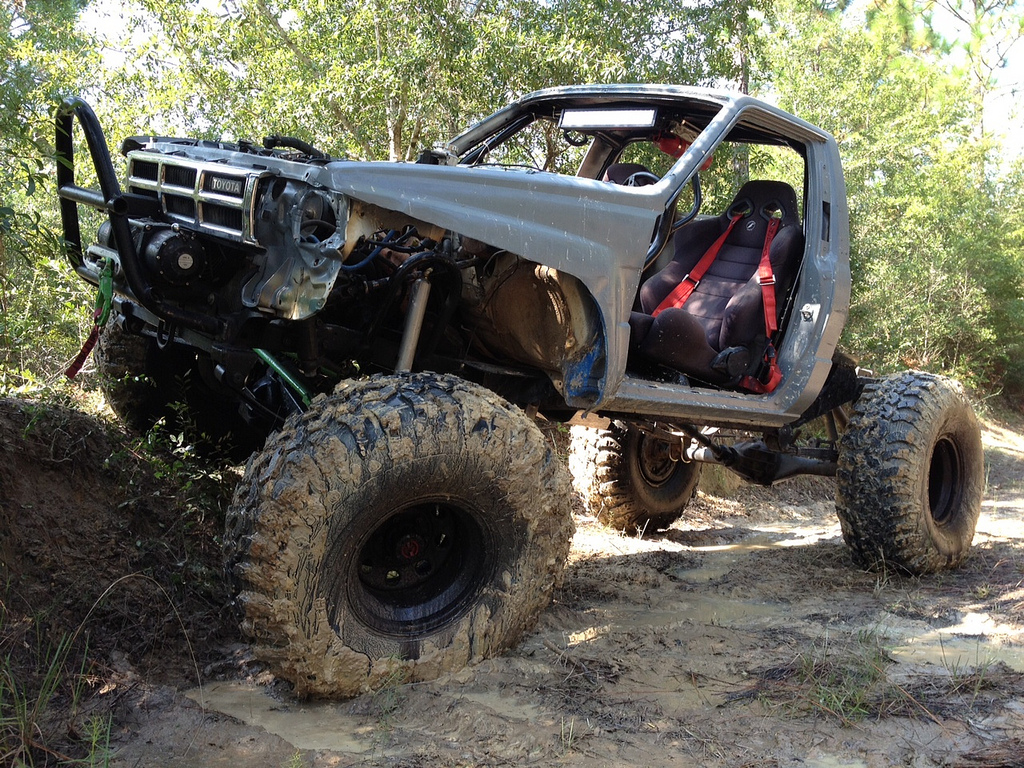

Why going back to a cab? Tired of getting wet, lol?

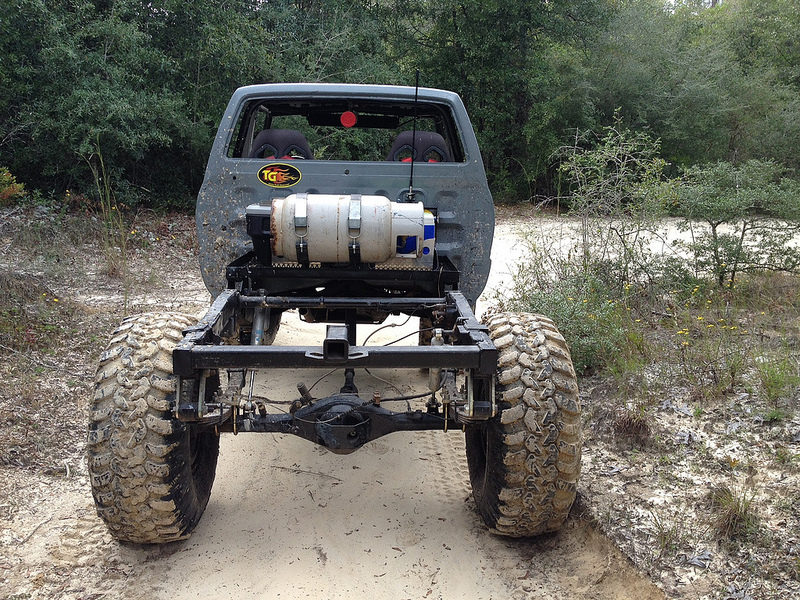

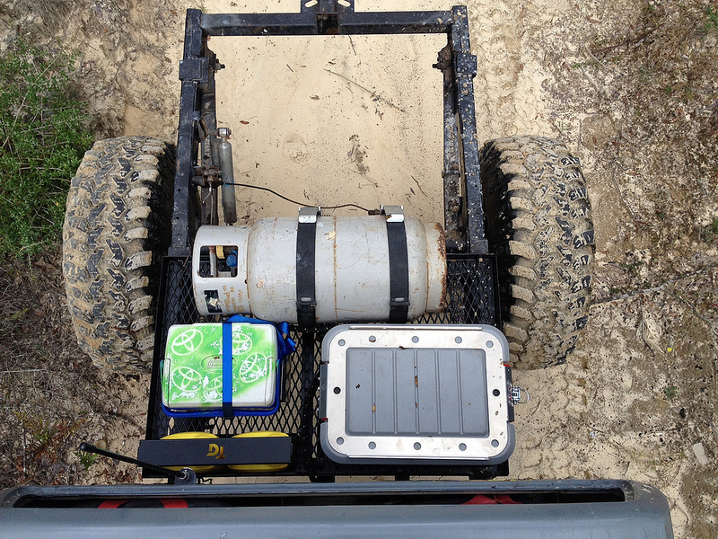

Yea, it rains a lot more here in Florida than it did in NC. Now I am working on getting the cage in, the seats mounted, wiring hooked back up and building a mount in the rear for the propane tank, along with a bunch of other little stuff.

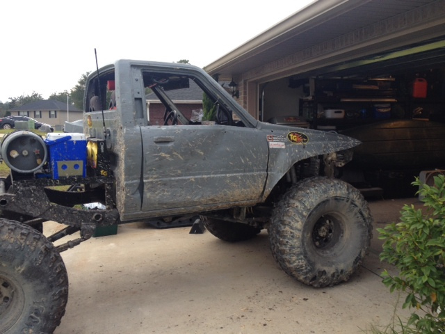

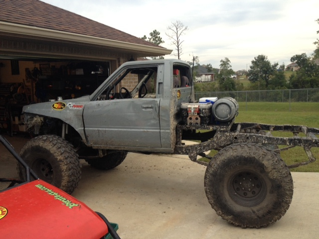

That's what I'm dealing with... My advice is start like it will turn into a buggy...if you don't it will look like 3 different designs in one. Nothing will match( style wise). Here's mine when I bought itai1052.photobucket.com_albums_s455_orv_design_fab_DD1BE680_FC0dd9aa5ca05f0f75b36ca328e98e9e1b1.jpg
And now I'm dealing with cutting all the sheet metal out and making new lines on the buggy to match existing lines.

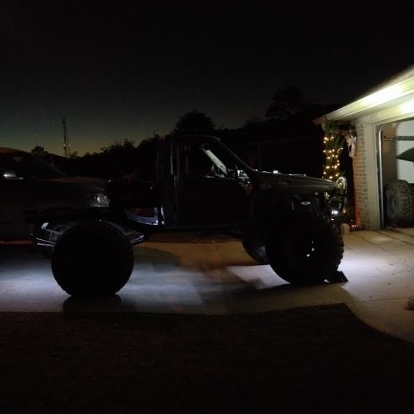

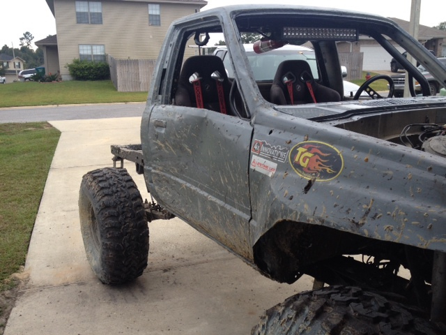

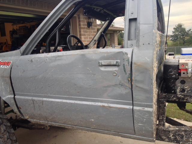

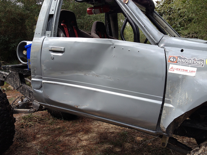

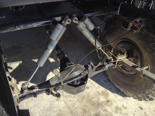

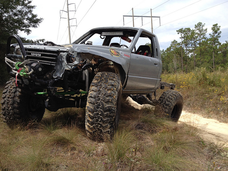

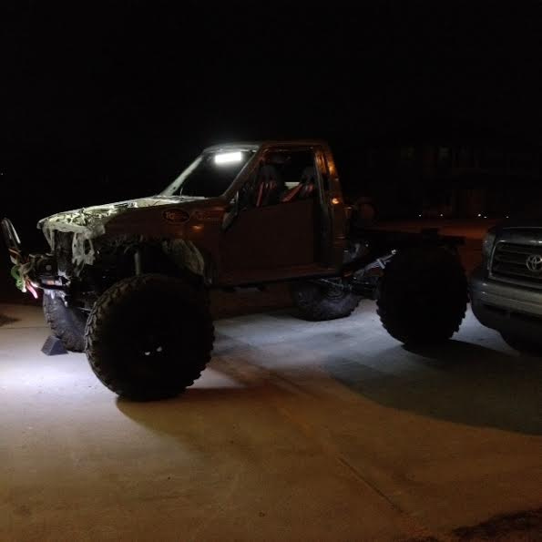

Stock doors didn't work out too well so I added some tube and a little sheet metal. Also finally got around to relocating my rear shocks and putting rock lights under the truck.

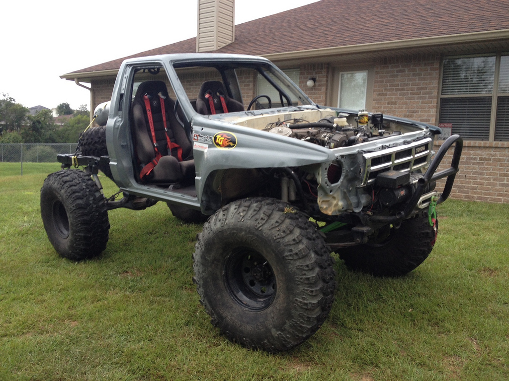

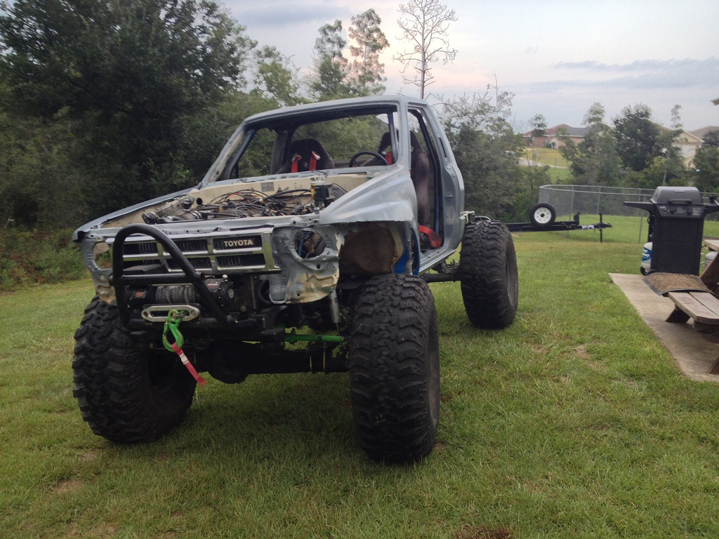

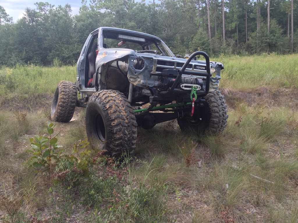

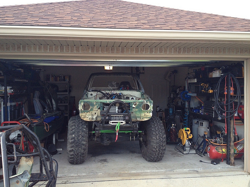

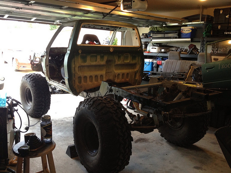

I like it, all the body mounts line up or was there some cutting and welding going on. Been want to swap an ext cab body onto mine.
I had to cut and move the middle 4runner body mounts back about 5" to match up to the rear truck cab mounts. Other than that everything lines up nicely.

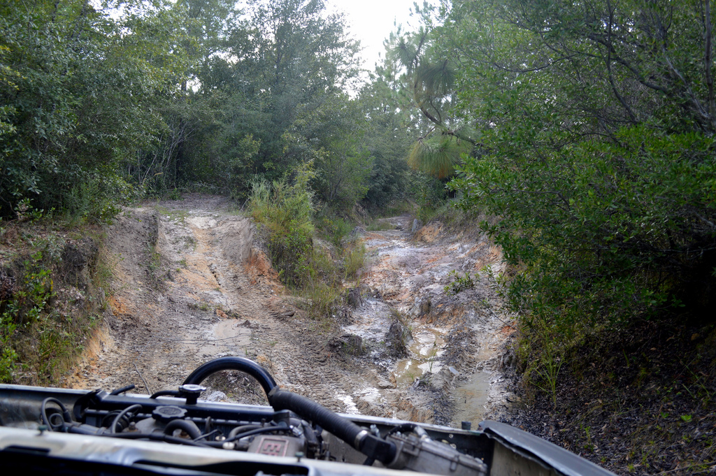

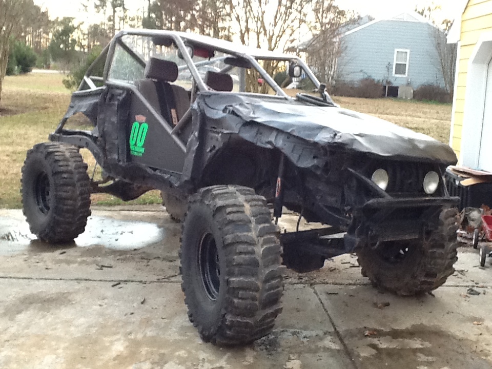

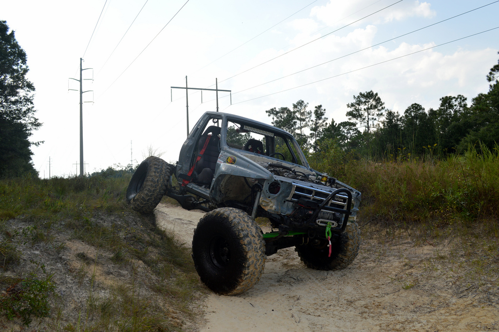

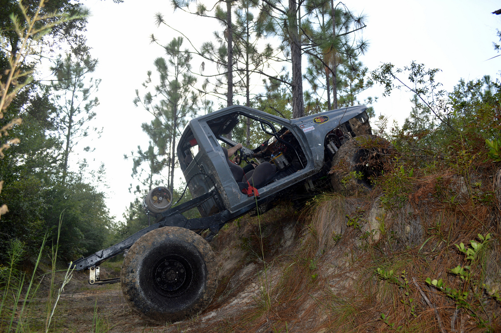

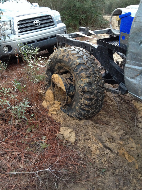

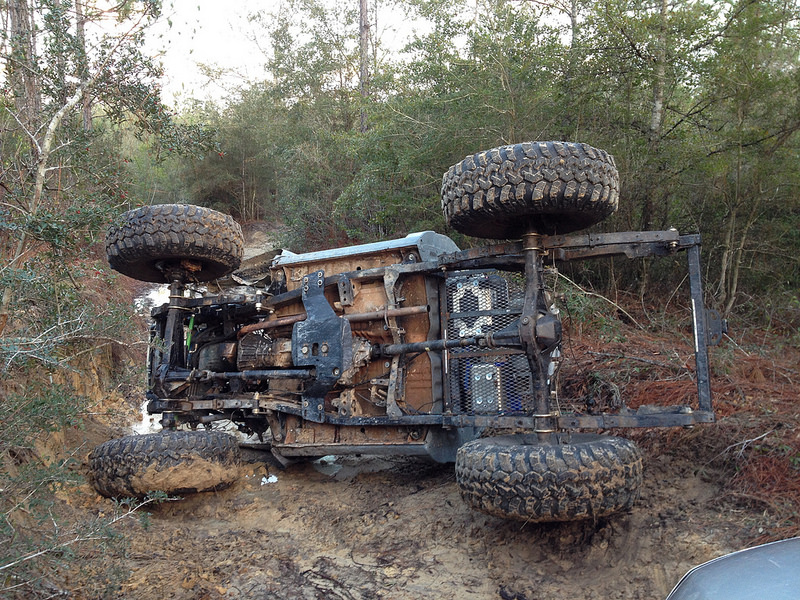

oops :shaking:
Flopped it back over and while I waited for it to settle I used a little bit of started fluid to get the tire situated. I let the truck sit for a few hours. Tried to start it, it took a second then fired right up. I will post some more photos as soon as I get home.
