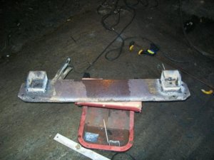

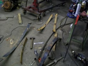

058.jpga picture of the rough fr spring hanger

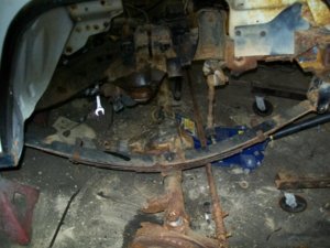

060.jpgmaking hybrid springs to get proper height

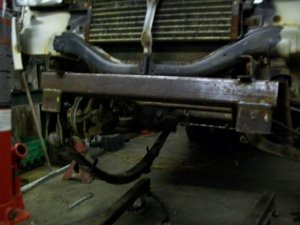

062.jpg front spring hanger and getting the proper arch on my springs

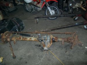

my rusty dana 44 and sliding under truck for first bolt up
068.jpggone be laying the wire brush to this one but th internals look ok

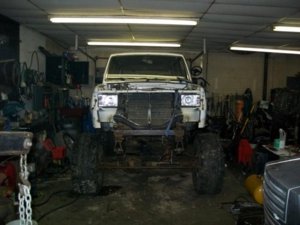

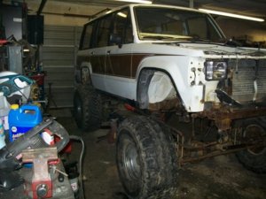

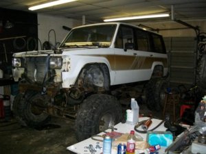

a little taller than i expected . those are 38's
