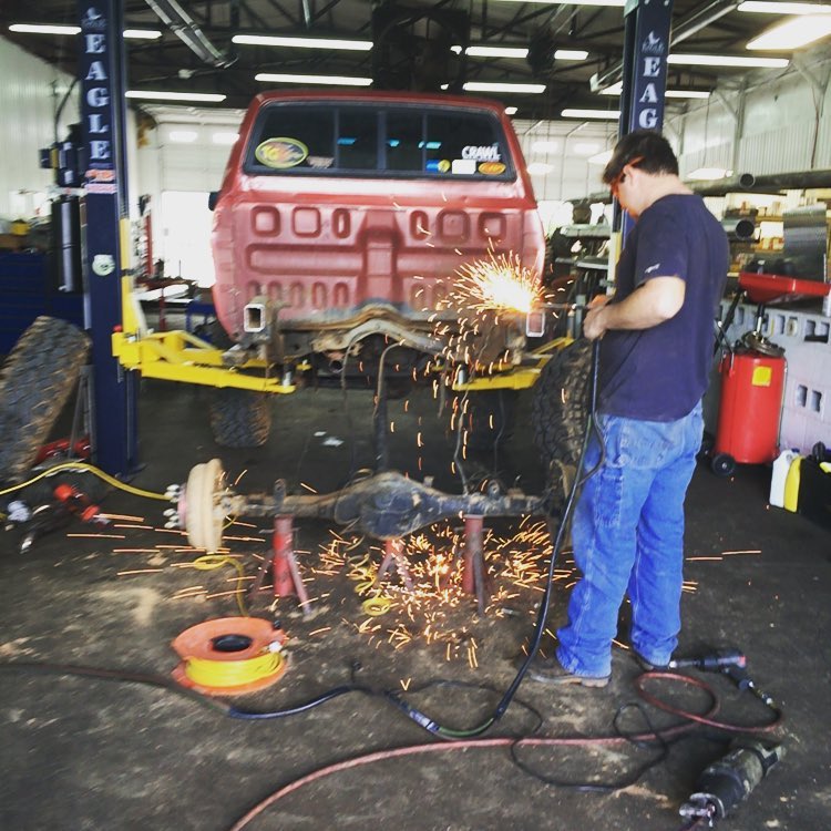

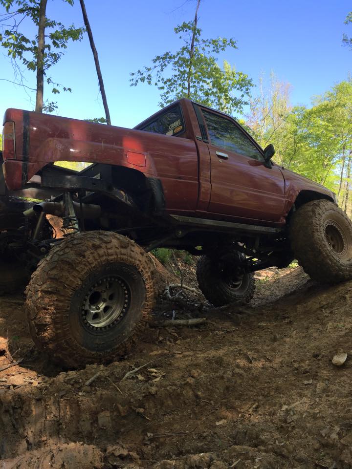

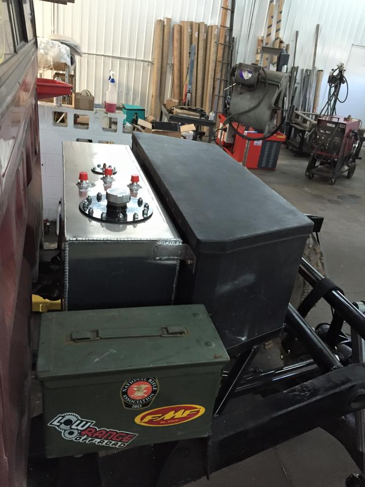

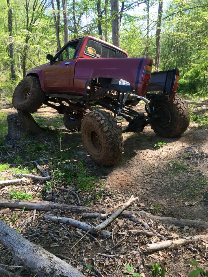

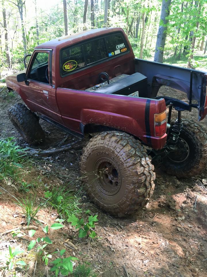

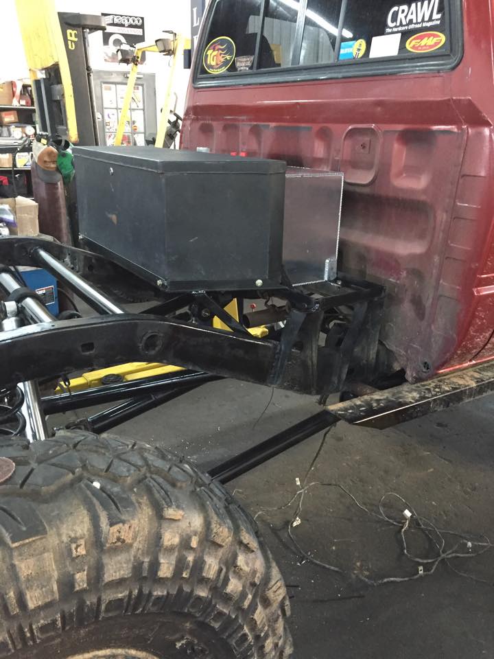

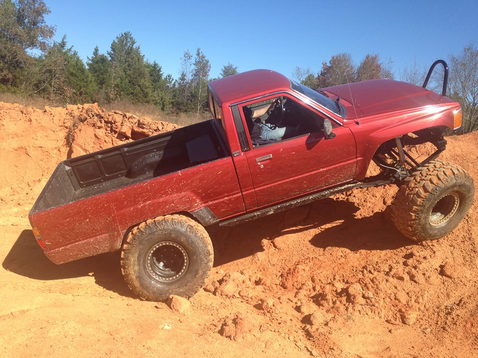

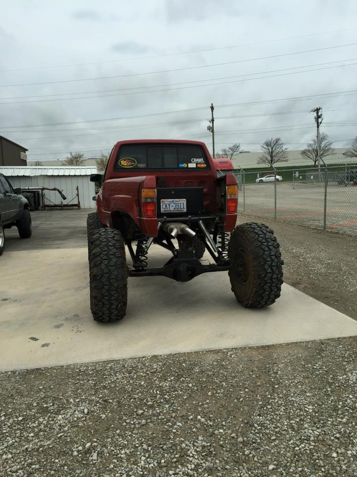

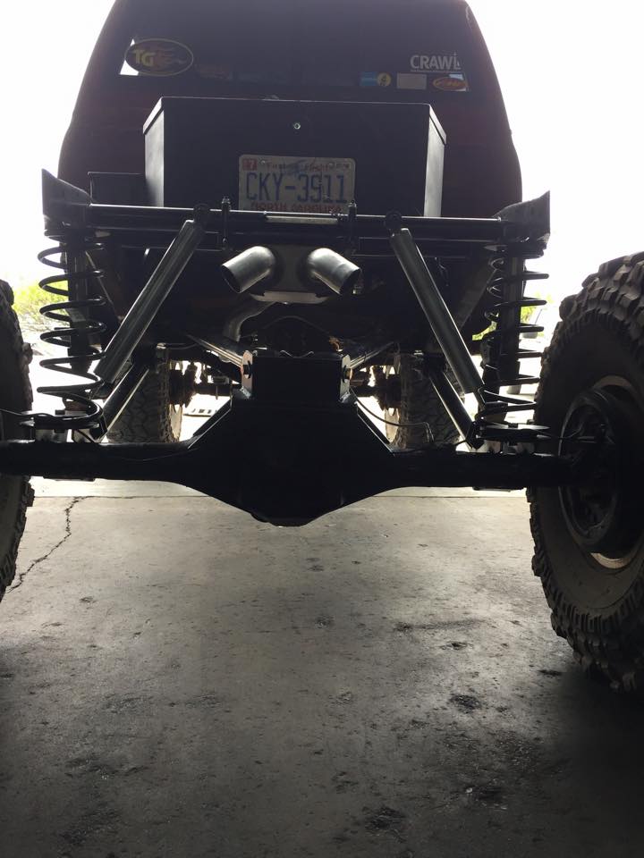

the build actually started in June of 14 but heres what happened so far...

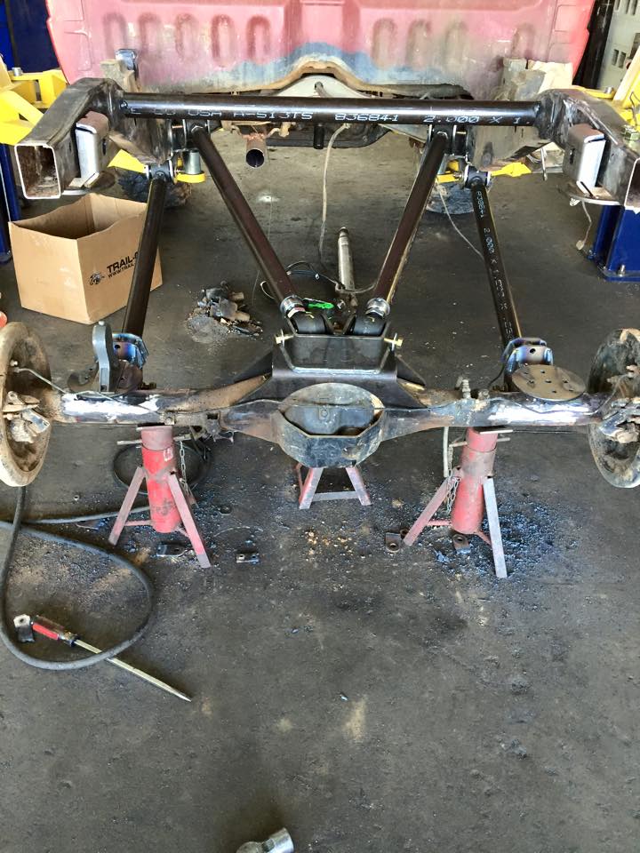

started out with a 88 cab and bed, 88 running works 22re with a top shift case, some one had all ready swapped a 84 frame,frame suspension and a ifs rear axle... all ready had a stock straight axle...

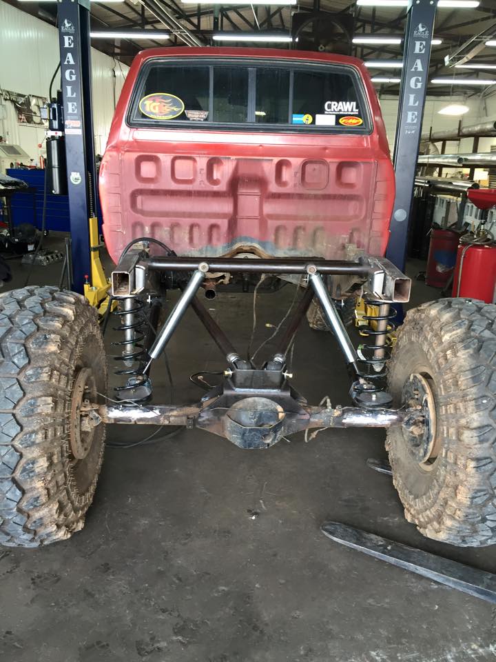

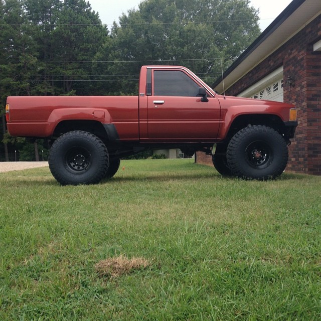

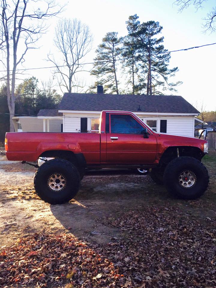

ok so here it is when i first got it, at this point i had already put 63" chevys with a double shackle, and triangulated the shocks... on 31" bfg all terains

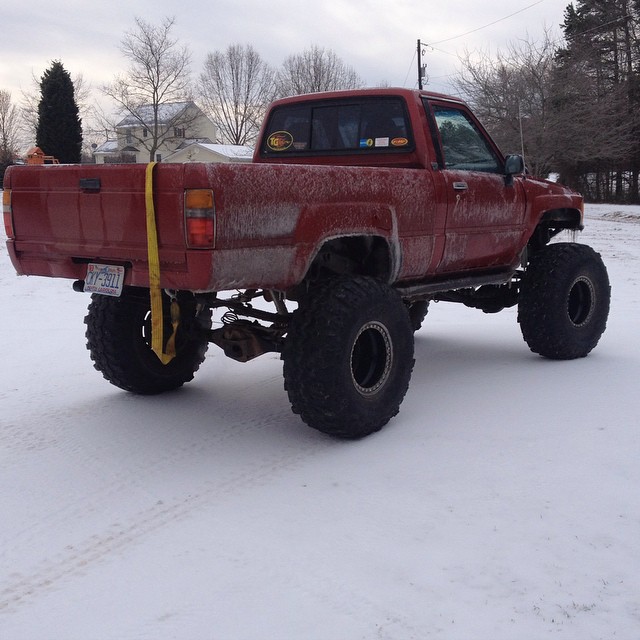

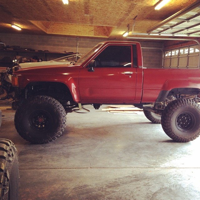

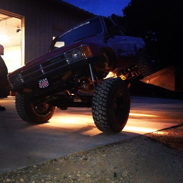

here it is when i got 35" km2s and put trail gear shackels up front

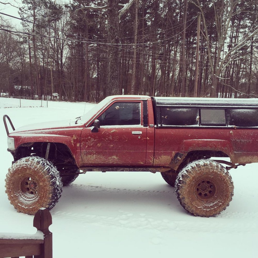

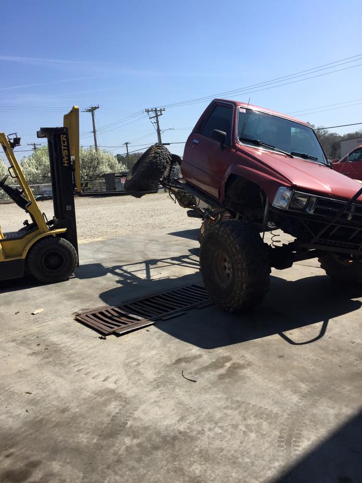

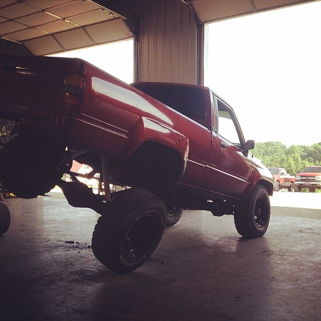

added 3" block in the rear, moved my rears up front with a add a leaf, ifs box and high steer, 5.29s and welded diffs

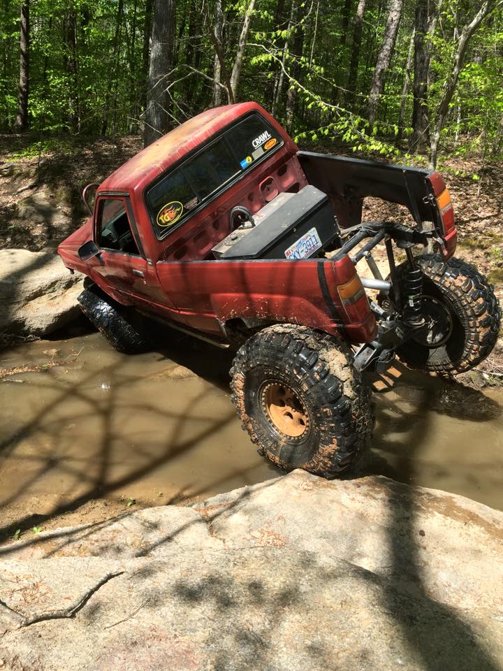

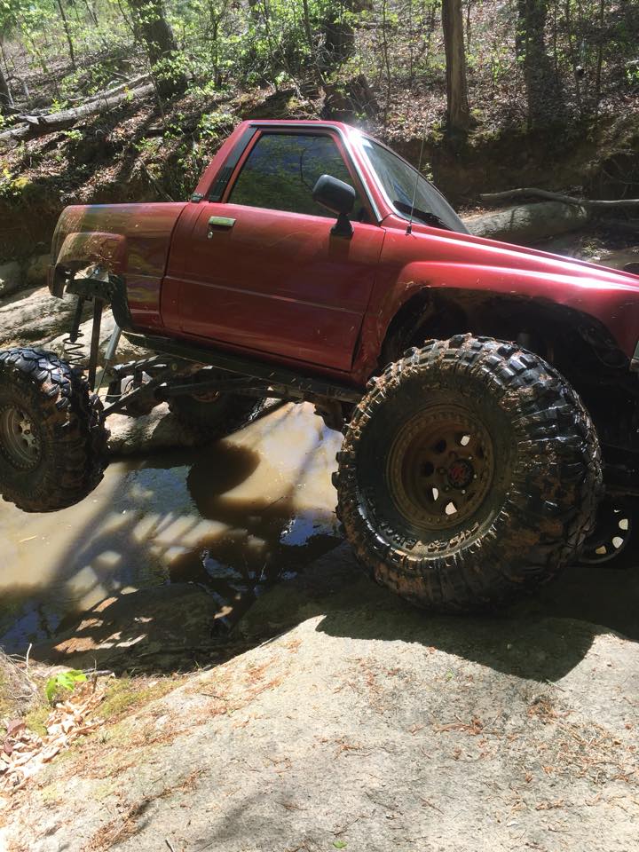

Flex test with the new setup

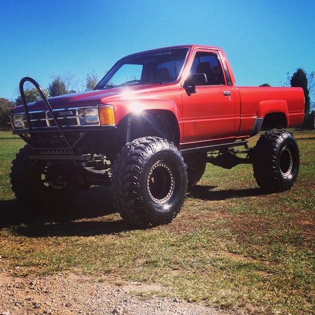

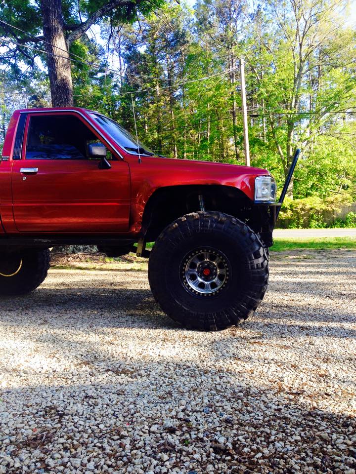

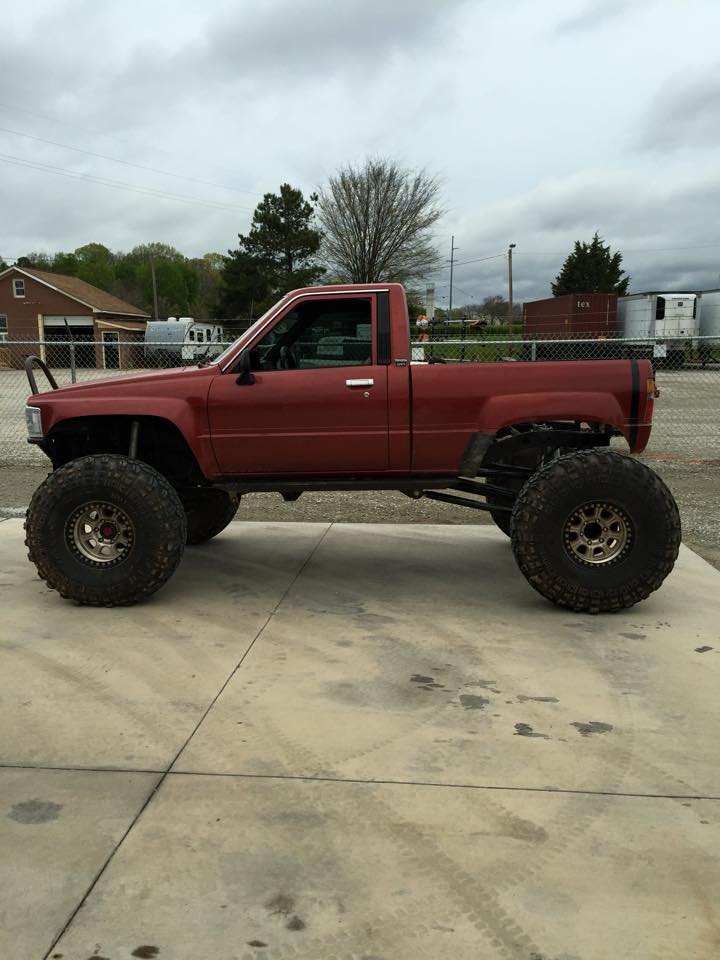

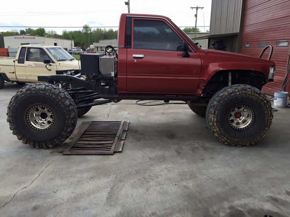

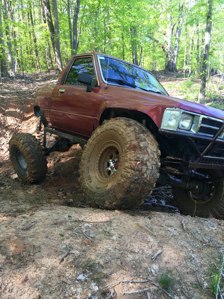

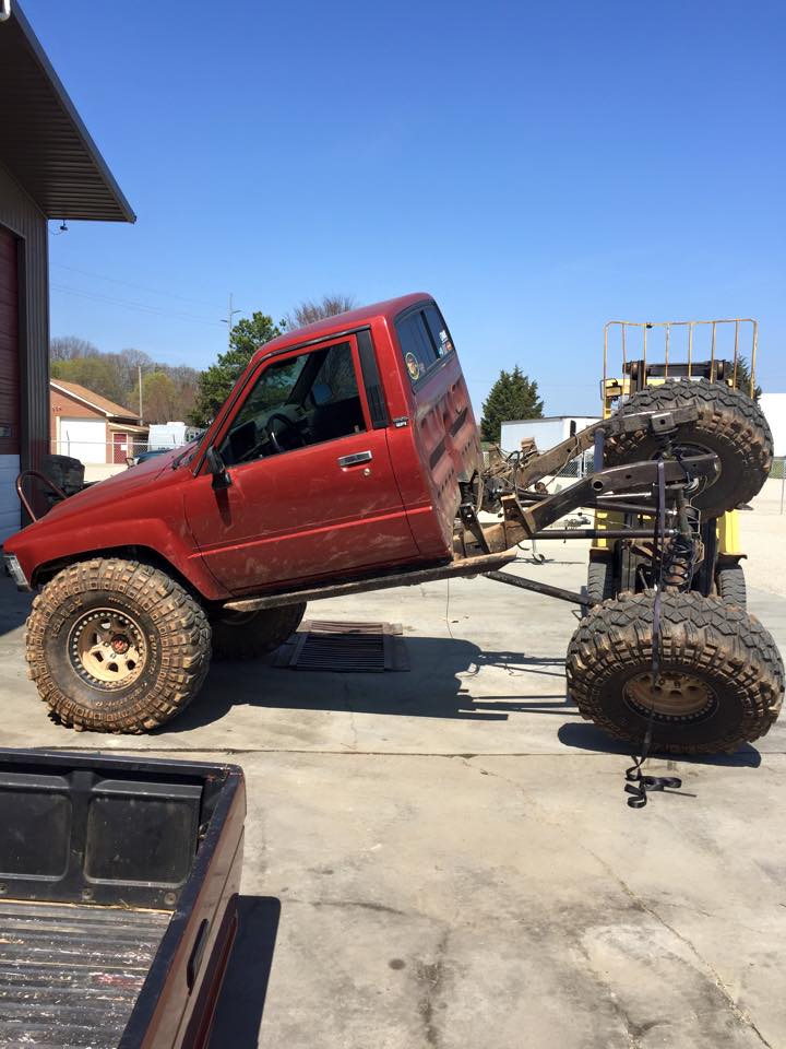

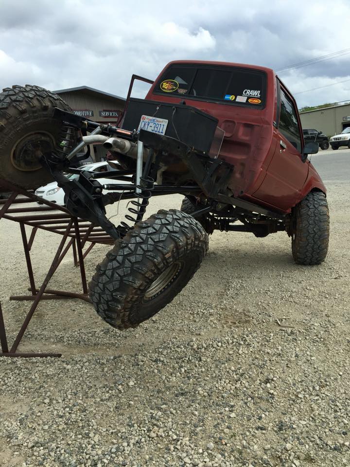

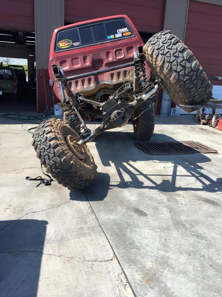

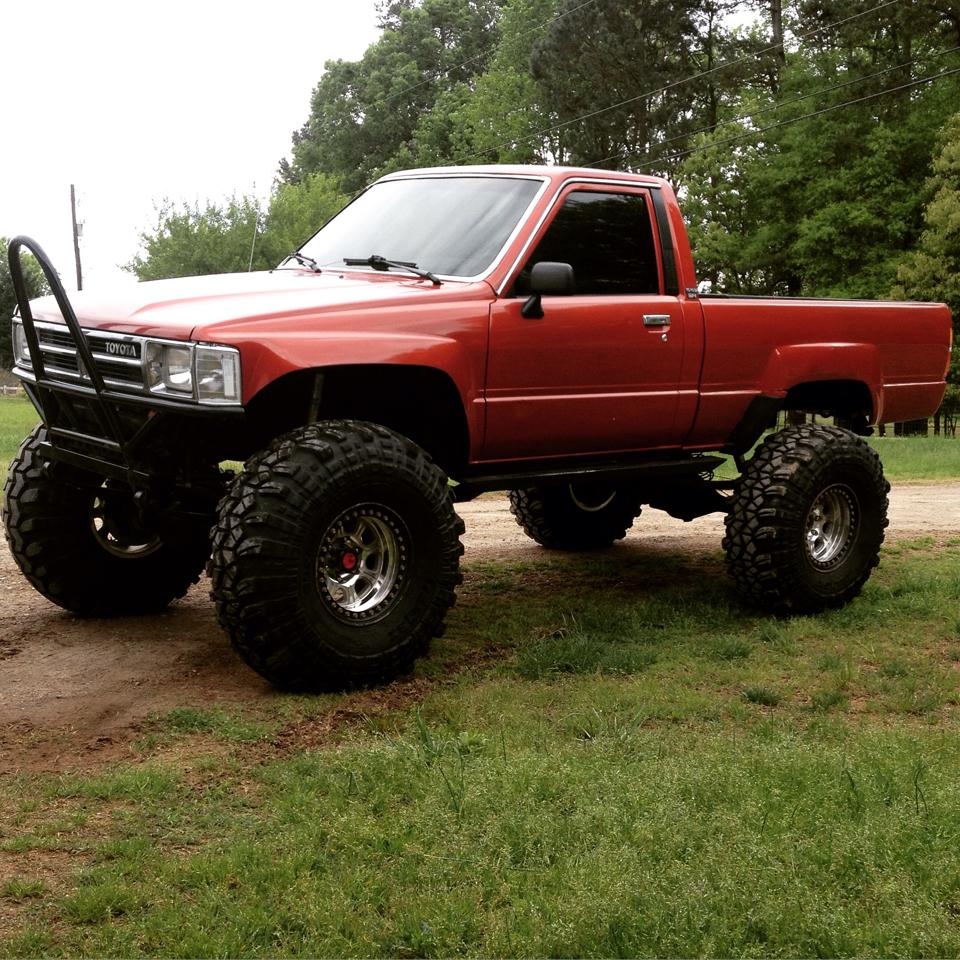

went to a set of 36" iroks on allied beadlocks and built a bumper and sliders
