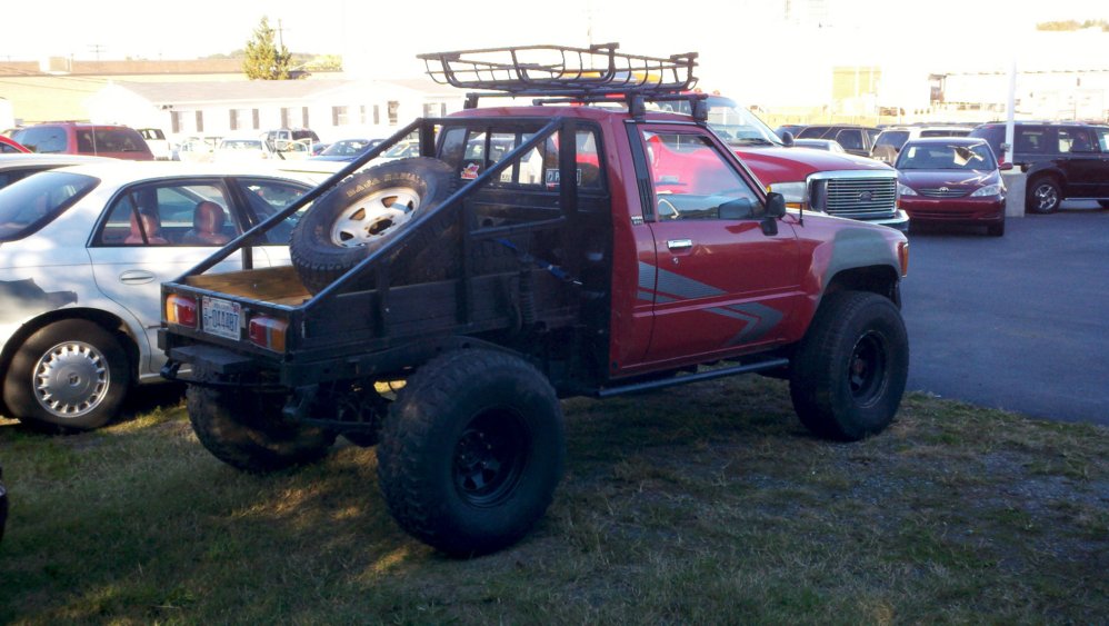

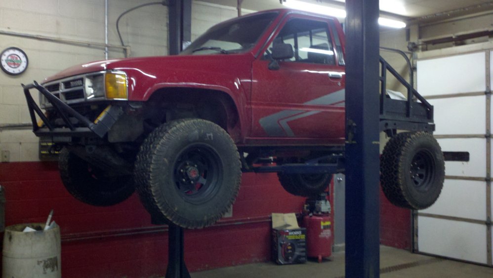

Got the truck about two years ago bone stock minus the so called fab work the previous owner did which consisted of a "flat bed" an some "rock sliders" been building on it in my spare time since I got it figured I'd start a build thread an catch y'all up to where it's at now thanks enjoy
What it looked like the day I got it

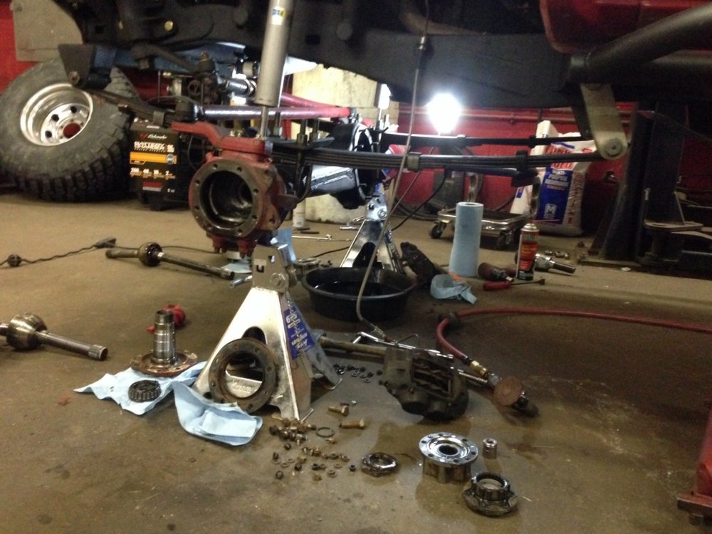

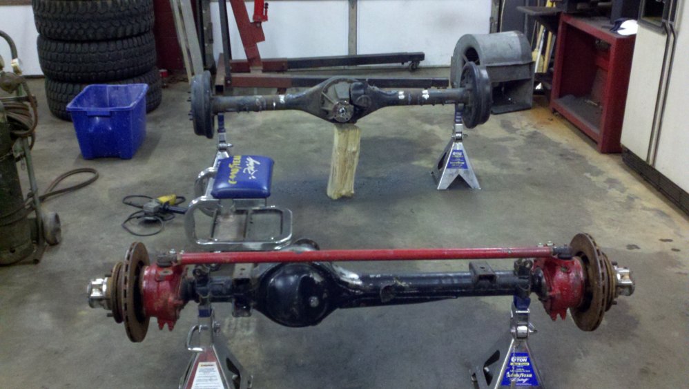

Got the axles from the parts section on elocker rear an front with ifs Hubs an hysteer stock shafts an open diff for now
That front bumper an bed has got to go ASAP

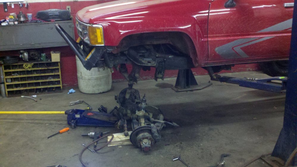

Got all the ifs brackets cut off

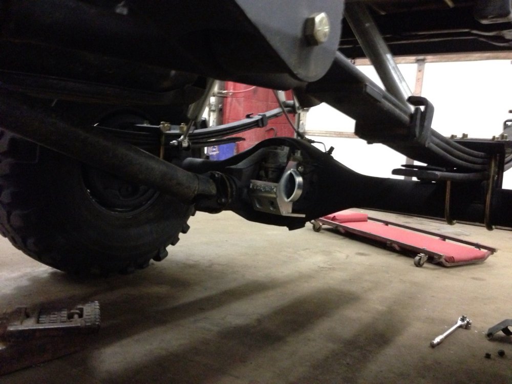

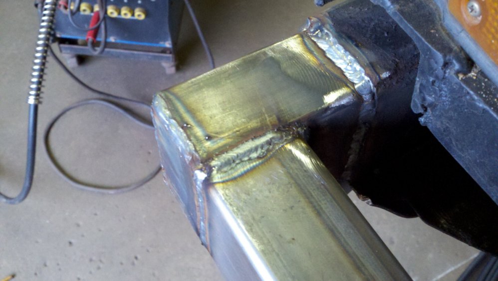

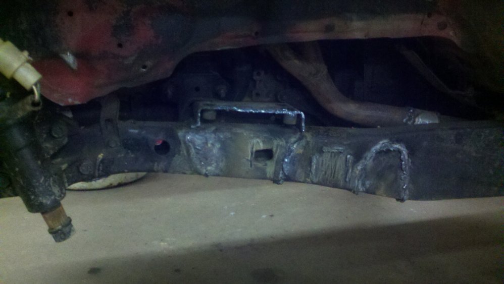

spring hanger welded on front an shackle tubes in frame ruf springs with a few leafs added
Boxed in the rear an got the 63 Chevys in an elocker 4.30 gears.

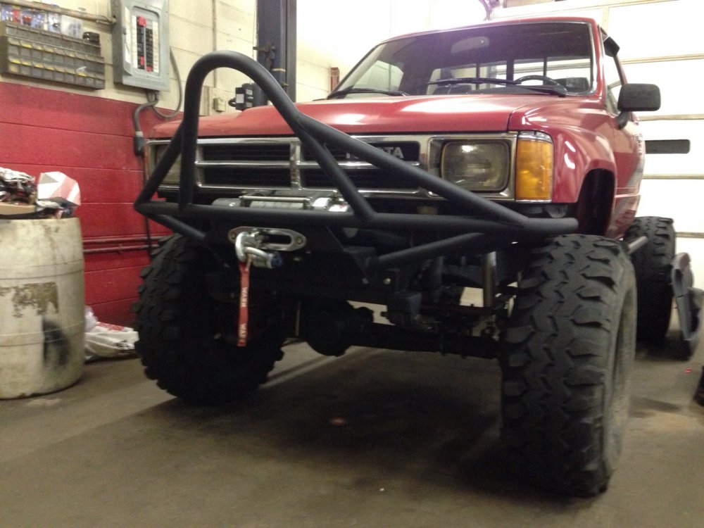

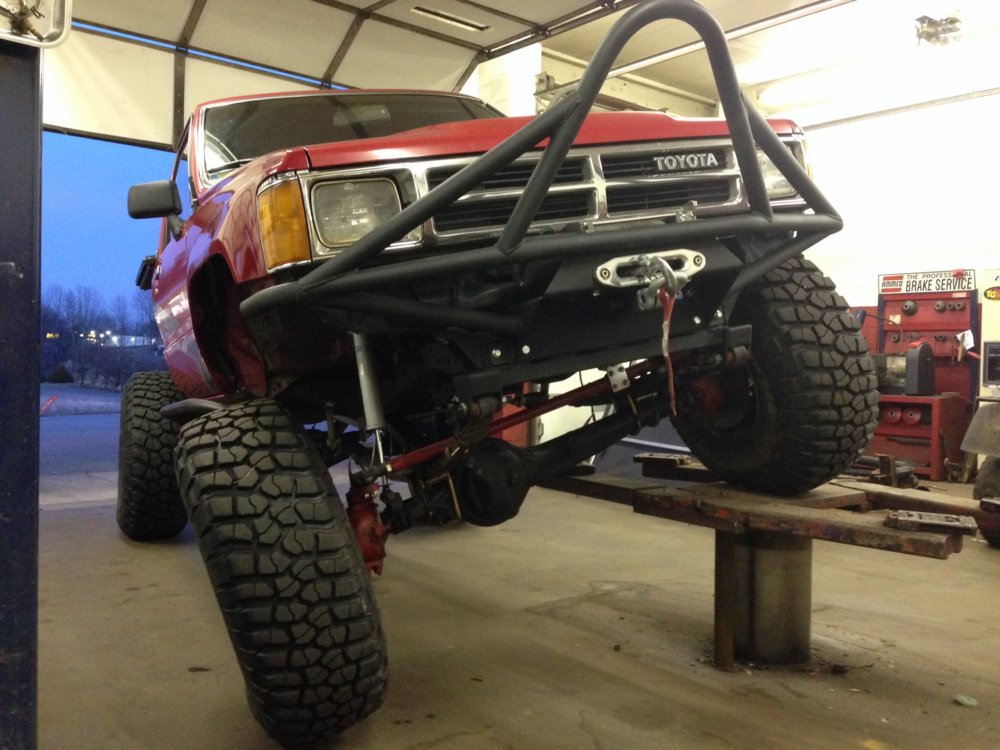

Tube bumper put on an warn winch bolted on gonna put solenoid underhood later on

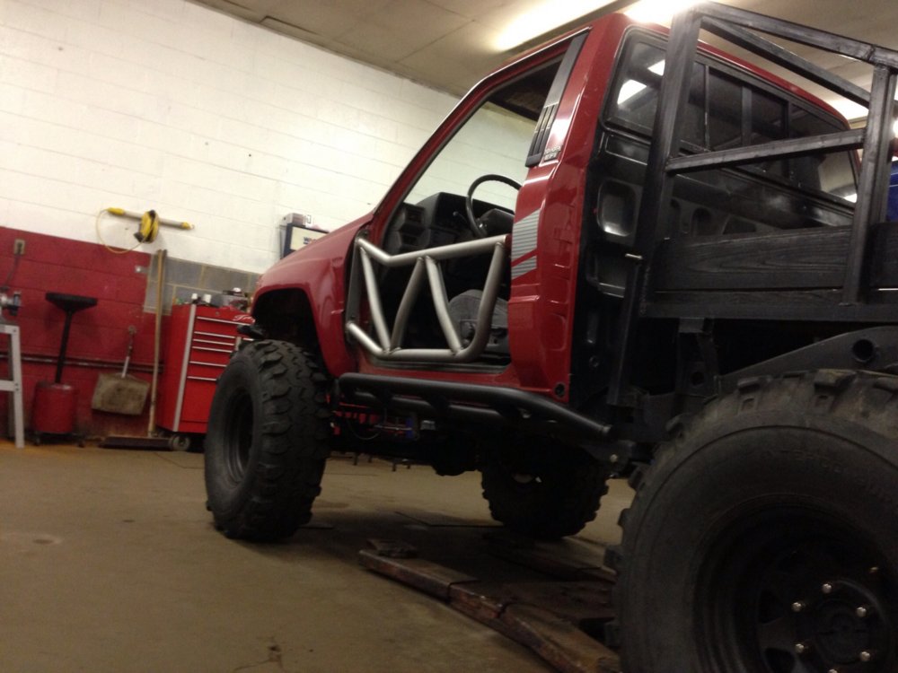

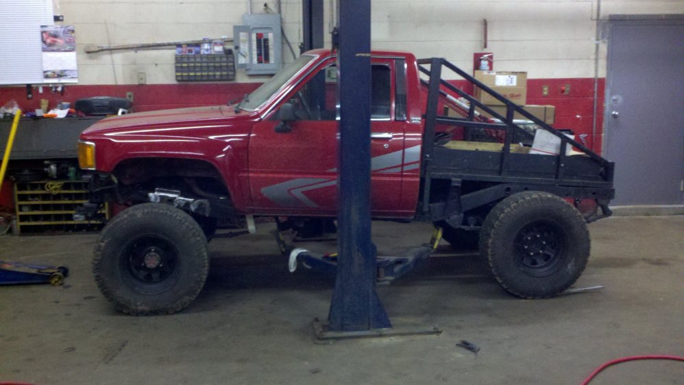

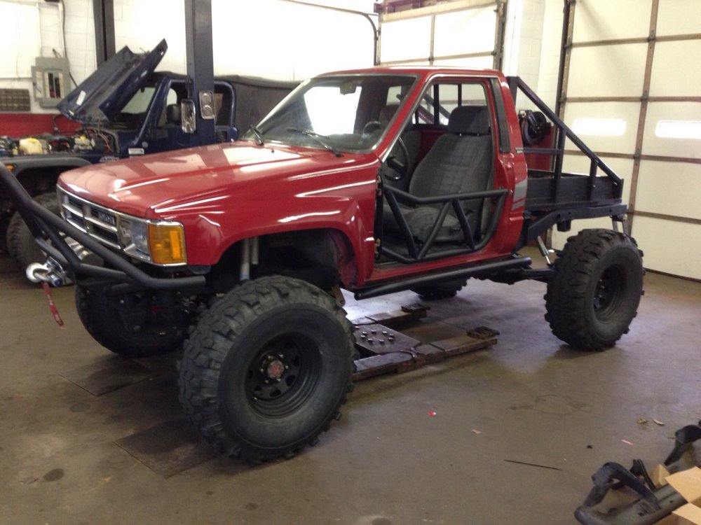

Again let me say I didn't build the contraption on the bed it was done previously haha I put on a set of sliders an some tube doors for summer no ac dang it oh well also put some sr5 4runner bucket seats in I stole off clist

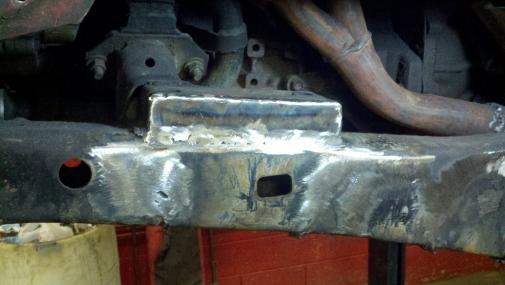

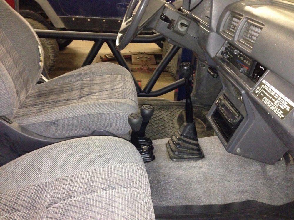

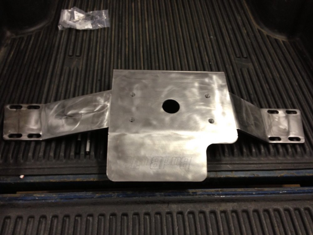

Got the twin sticks put in gonna run a single case with 4.7 gears that will be installed later also got buds crossmember picked up

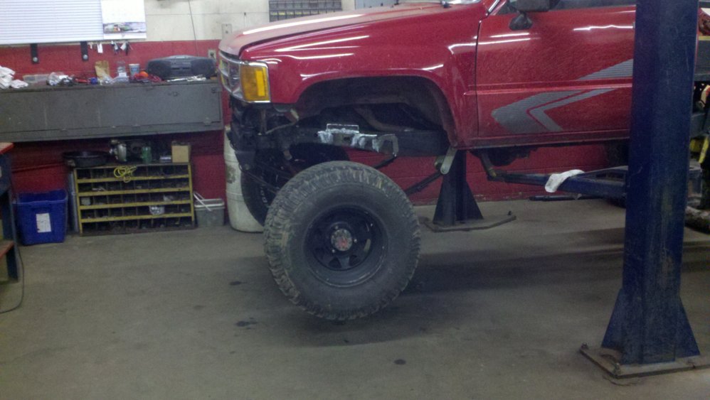

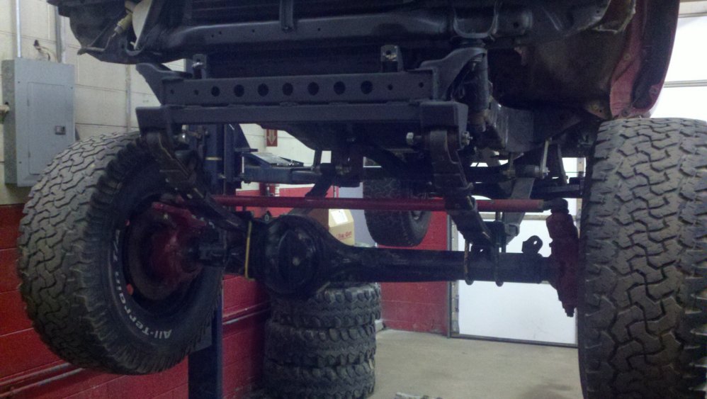

Got some bfgs that are good on the street since it's gonna be streetable rig chrome mods came with them prob put the black wagon wheels on them. Just flexing it a little to see what needed what ended up moving the steering box forward 2.5 in an changed the front third to a 6cyl 4.30 to match the elocker front is gonna be open diff for now

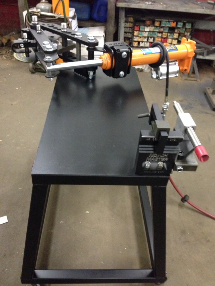

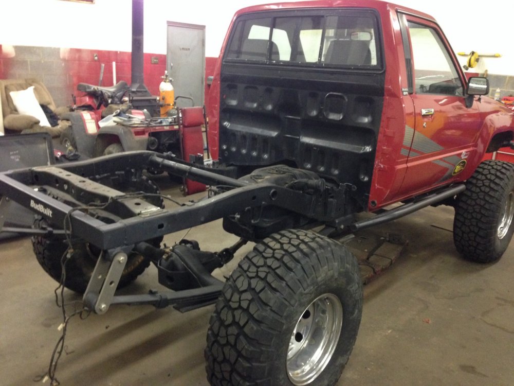

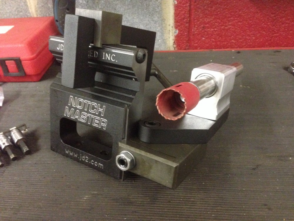

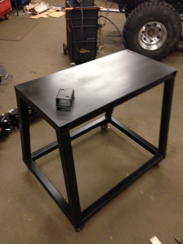

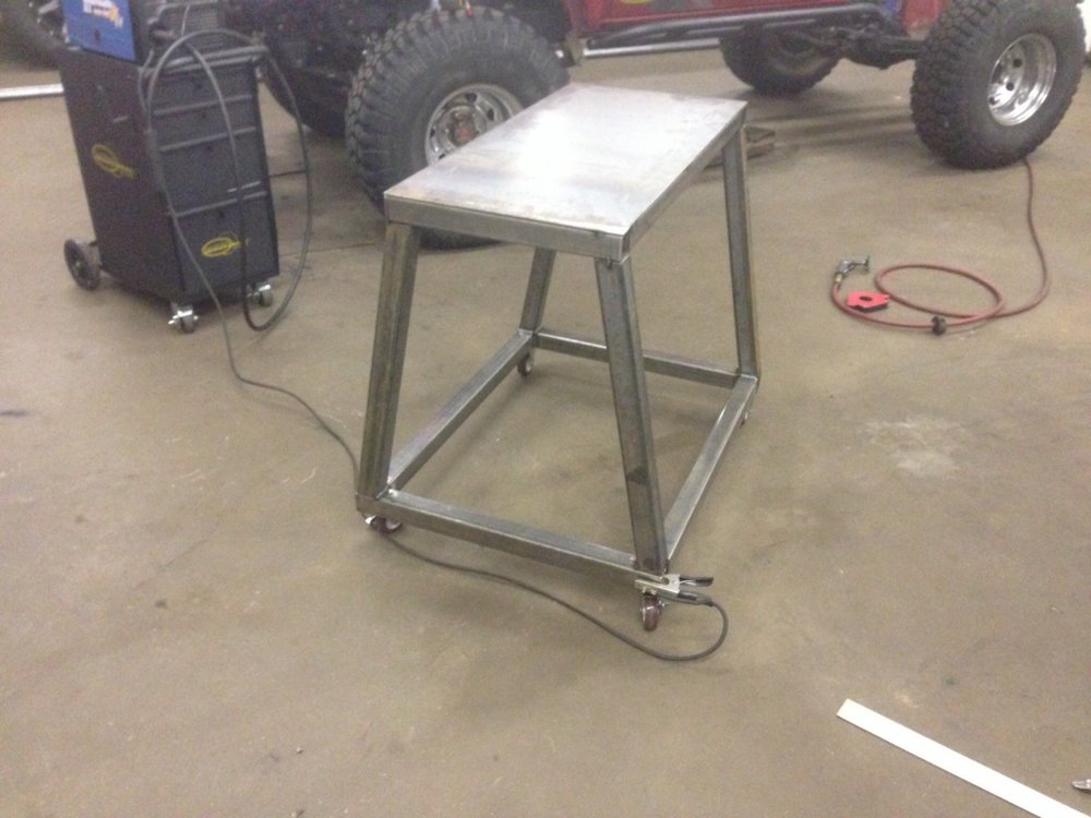

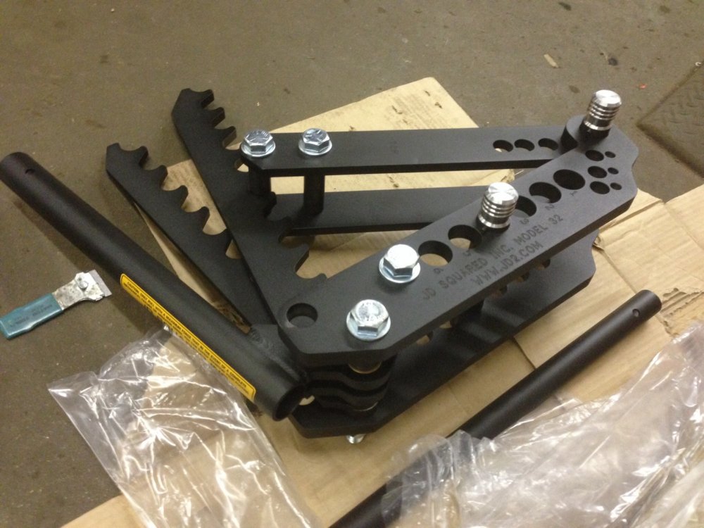

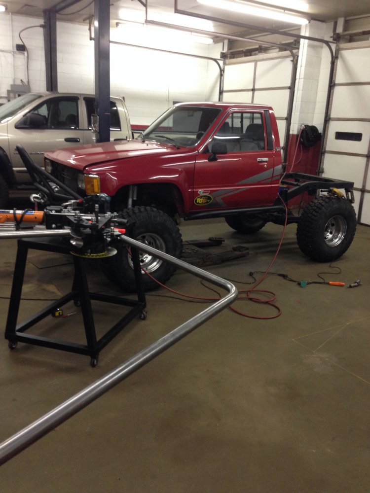

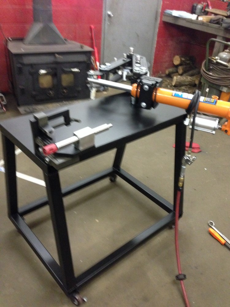

Couldn't stand to look at the bed that was on it any longer so I ordered a couple new toys from jd2 an cut the old bed off for scrap metal now just gotta build a table for the notcher an bender

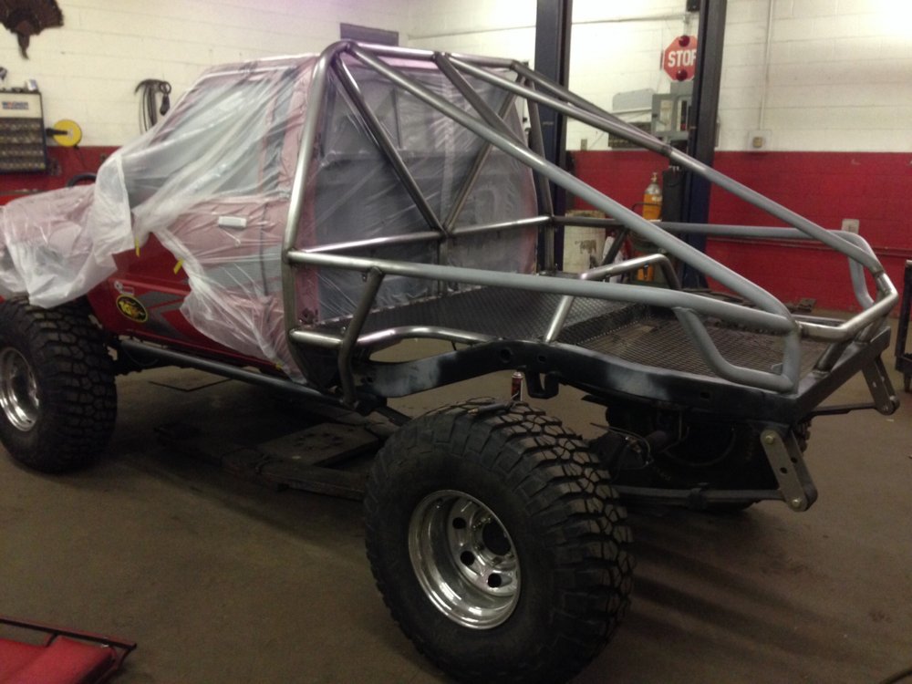

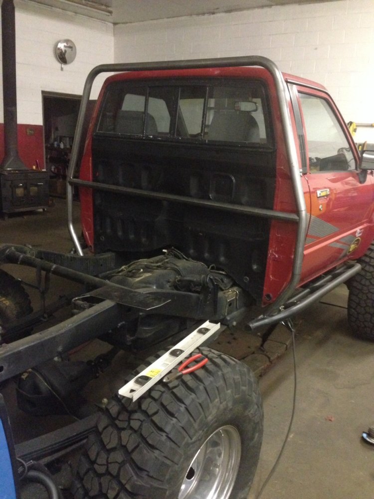

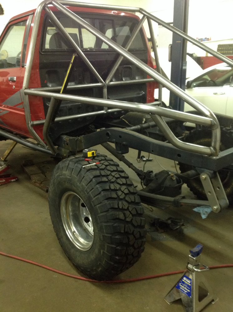

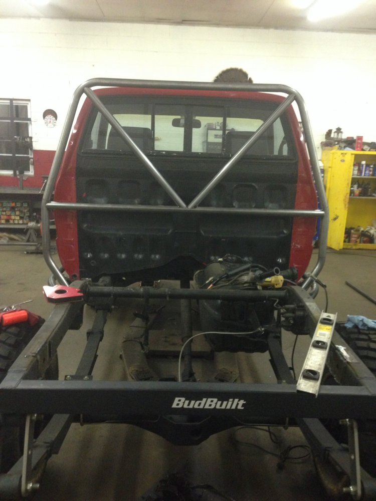

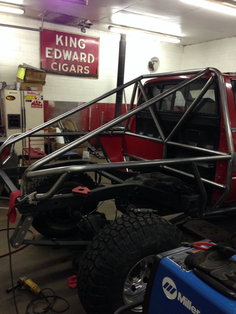

Table worked out nice got the main hoop bent up I used the floor to lay it out an find the angles worked out nicely. Bend tech not needed when u can use a framing square an a piece of chalk ha woulda been easier though

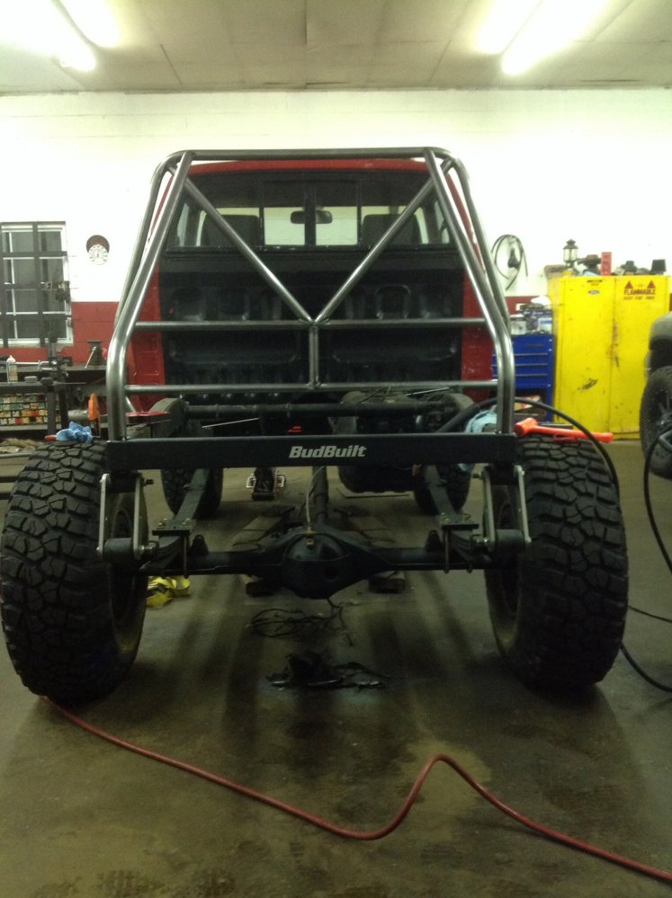

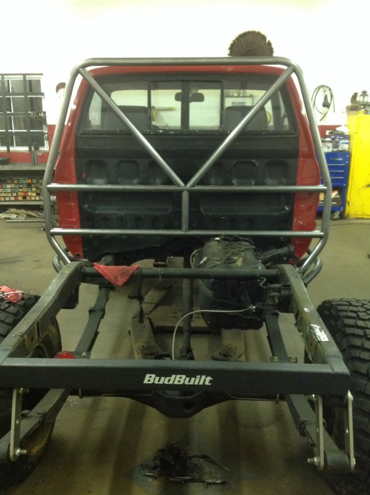

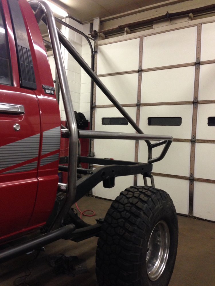

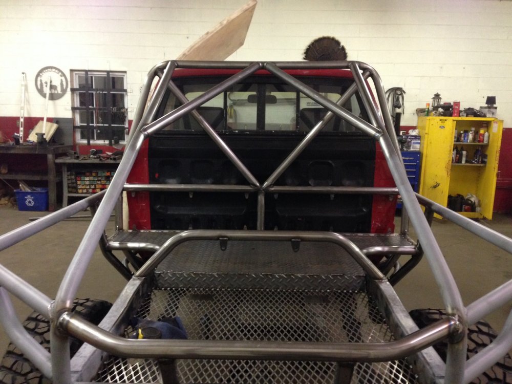

Got the main hoop bent an notched to the sliders gonna tie into frame later. Just tack welded it in till I get the rest done so I can pull it off an weld it up easier

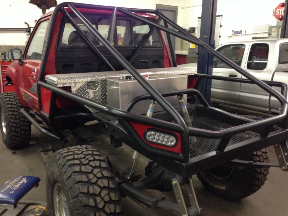

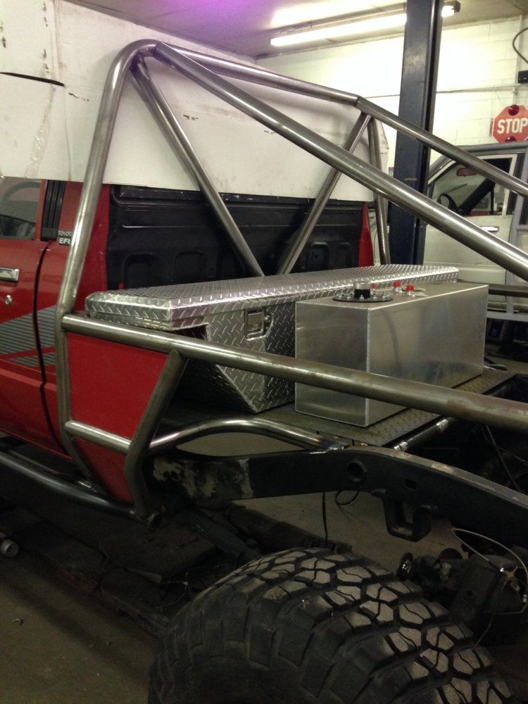

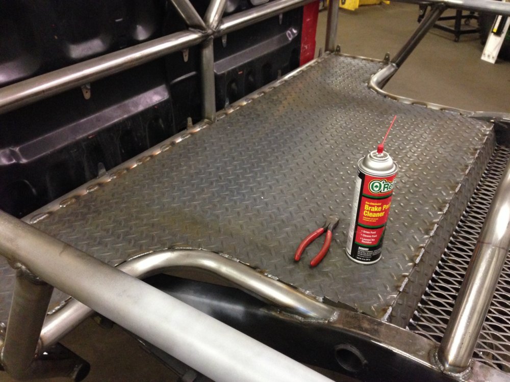

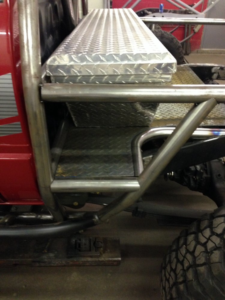

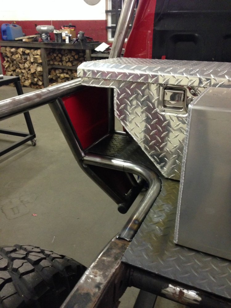

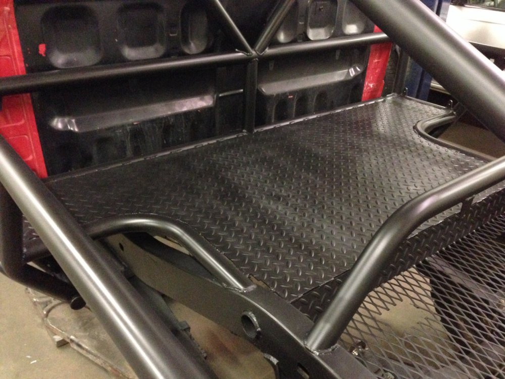

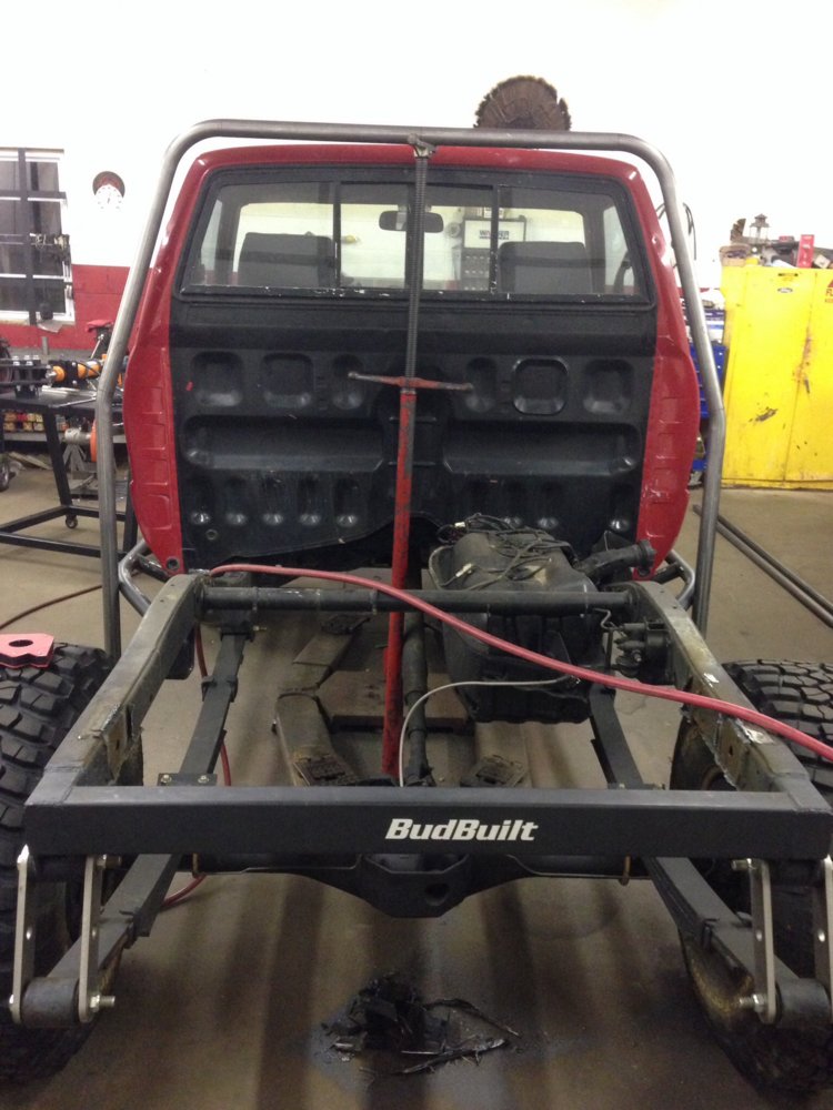

Got the rock anchor "gas tank" removed an started on the inside work of the bed. Bent two 90s an tied into the frame an cut out a piece of diamond plate to fit so I'll have somewhere to mount the tool box an fuel cell

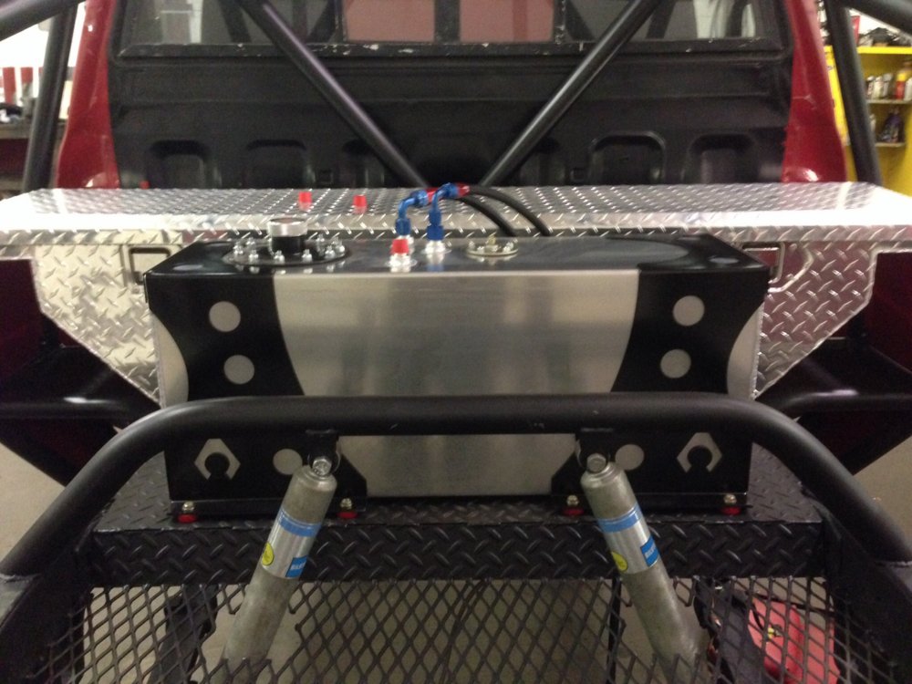

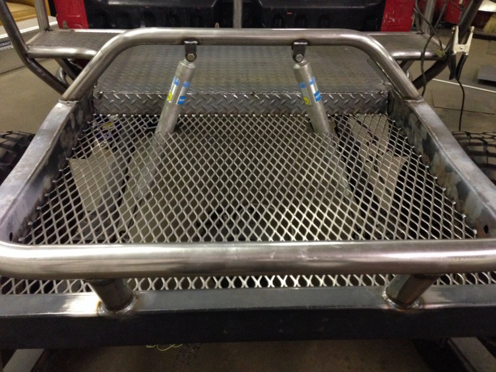

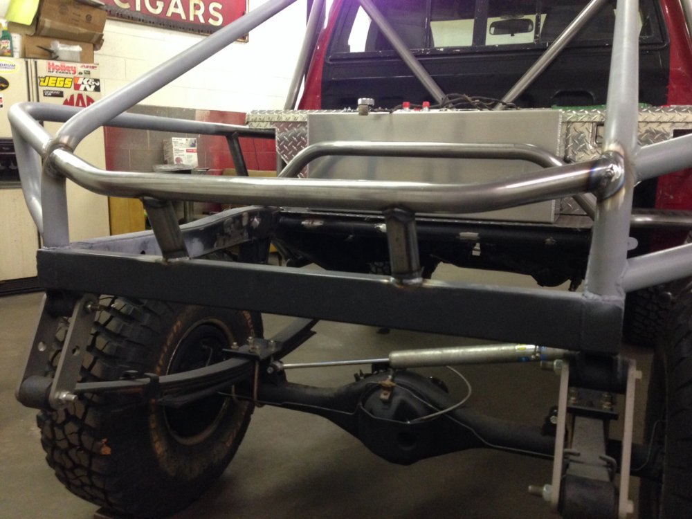

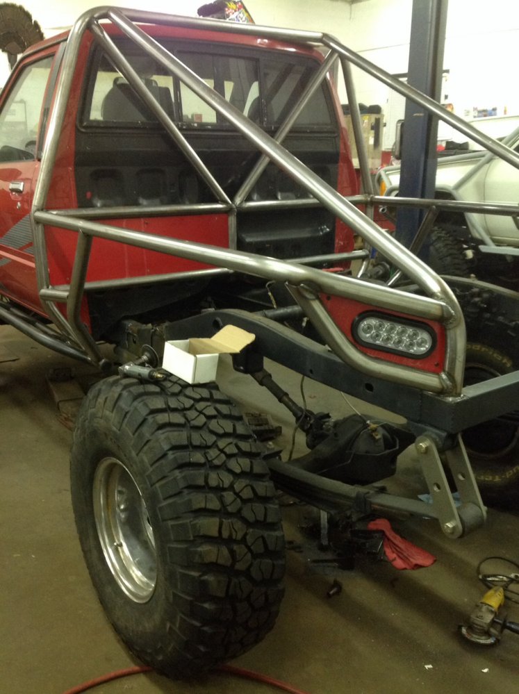

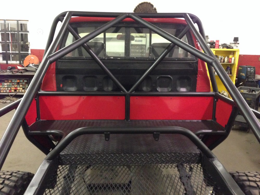

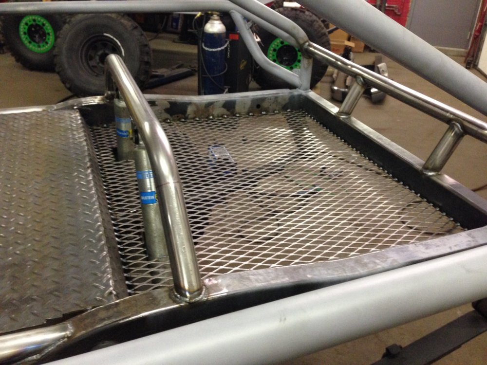

Shock hoop made an put in cut some shock tabs with the plasma an finished up the rear bars. Got the mesh put in the back worked out really good it's finally starting to come together
