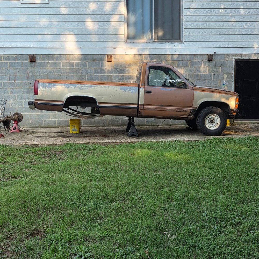

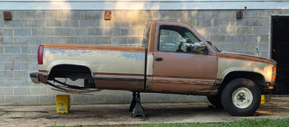

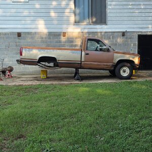

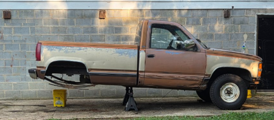

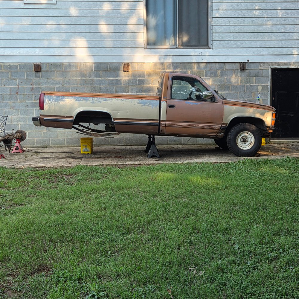

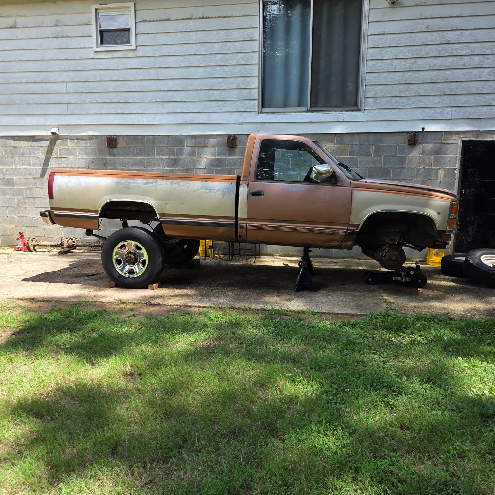

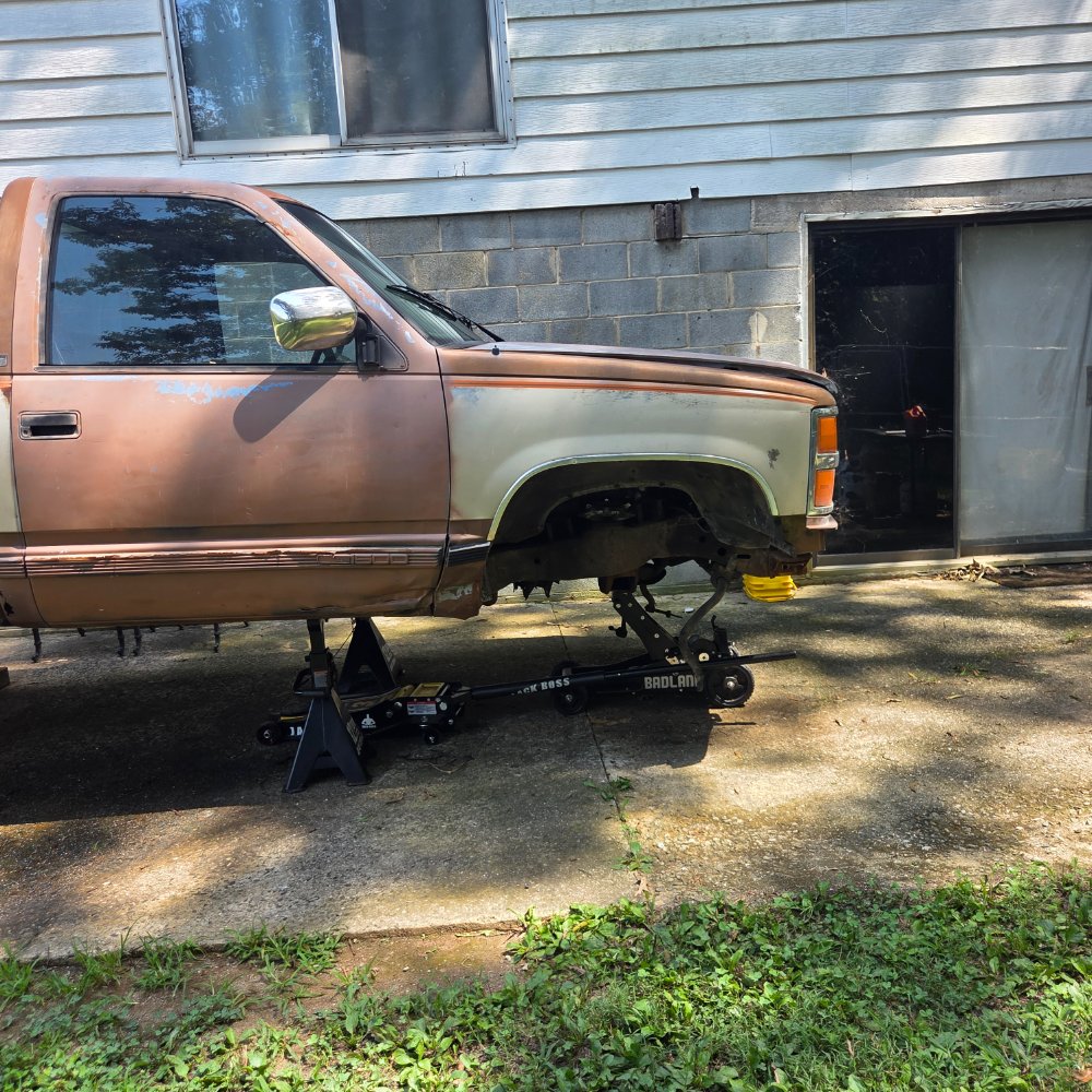

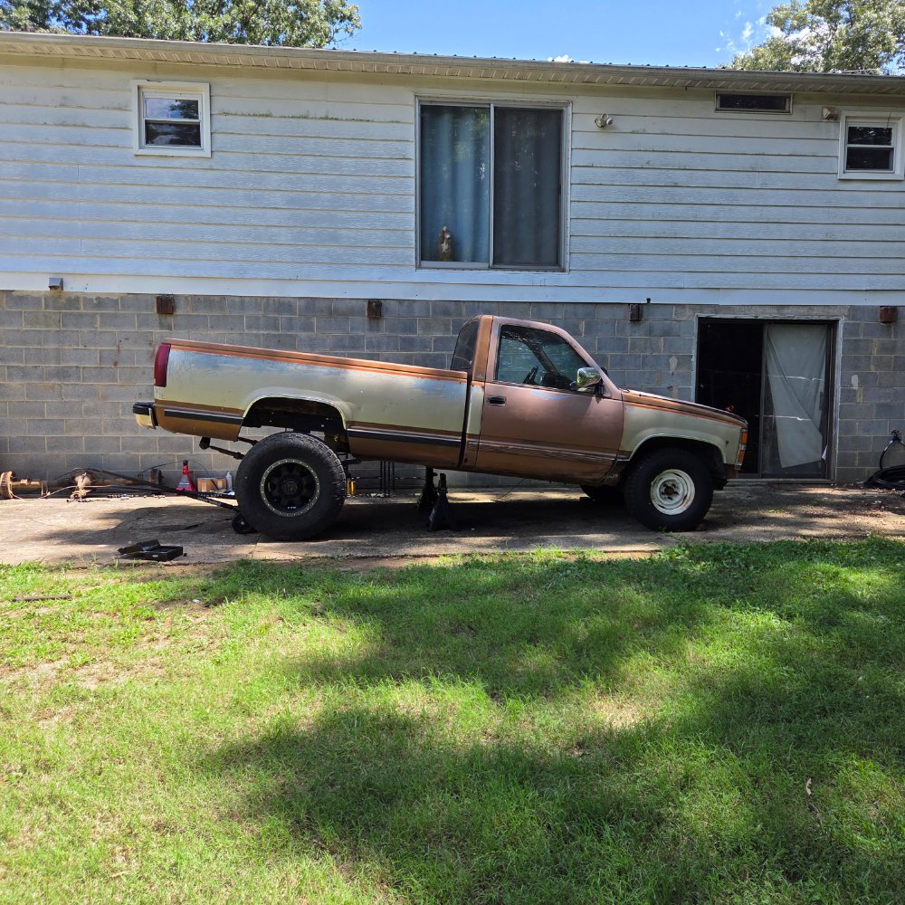

Started the SAS swap today...er, with the rear.

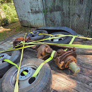

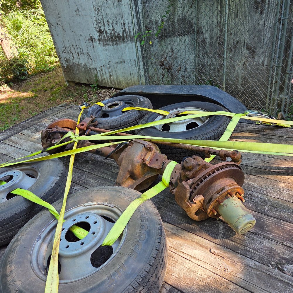

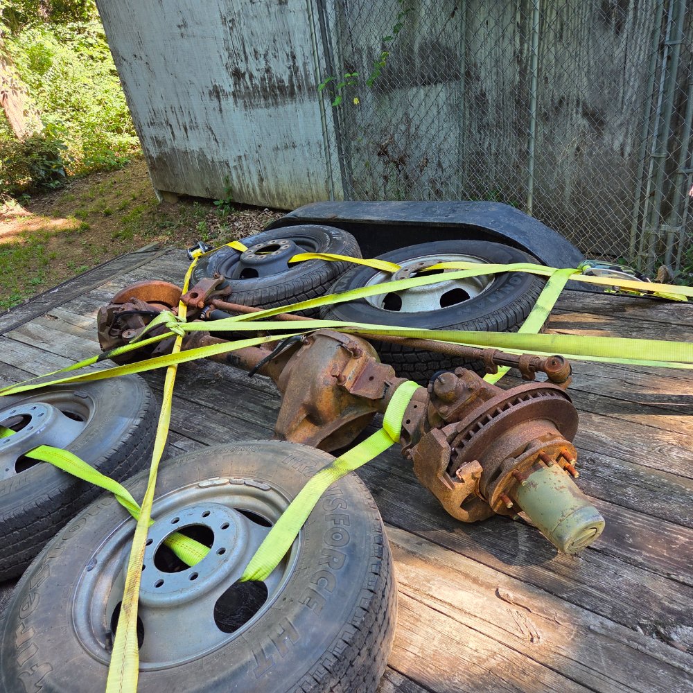

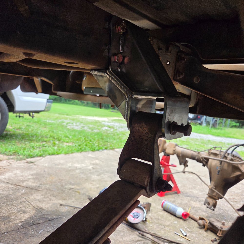

I have a OBS dually 14-bolt (I like the wider rear track) to swap in with Sky shackle flip & zero-rates to slide the axle back.
Front will be a GM Dana 60 with ORD SAS mounts & crossover steering w/ 4" leafs.
37x12.50x18 tires on Dodge stockers...
Basement & shop are full of parts, tires, wheels, etc.
Will update as progress crawls forward, slowly.
