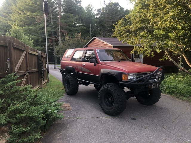

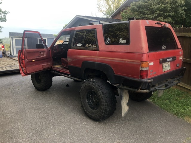

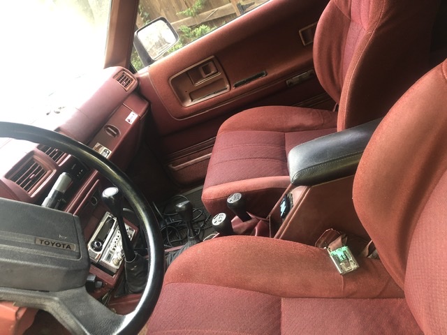

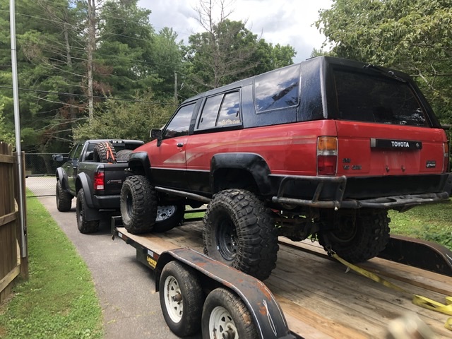

About a week ago I picked up a fairly well built 89 runner with a sas. Old build with all kinds of Marlin crawler goodies from southern Cali that spent a few years in Alaska then TN via a previous owner being in the Air Force. Basics: 4:88 gears on v6 diffs. Detroit lockers. Marfields. High steer, dual case with rear 4.7 gears. Factory V6 with marlin clutch kit. 9500 winch with marlin front, rear bumpers, rock sliders and dual case high clearance skid. Tom woods long travel driveshaft even. Everything works even the AC. It came with two seats of tires 36 SSRs on aluminum wheels and some Bart steel wheels with 33 inch Street tread tires.
It needed a new steering box and seals on the rear case and rear axle. And full exhaust as the exhaust is rotted and partially missing from rear case on. All the shocks were dead to. Driver seat and belt are broke in that 30 years of use kinda of way.
So my plans are to make it the family rock wagon like I used to have before we had kids but need now with with kids. Odd to come full circle. I have a steering box and ram kit enroute from trail gear along with seals and diff straps. Bilstein shocks headed in from marlin. I plan to add a removable steering wheel set up and suspension seat for driver use and ease of access. Harnesses for all the seats. I’m a fan of disk brakes in the rear so I’m doing the cheap disc swap on the rear when I reseal the rear axle. Hit the trails next month.

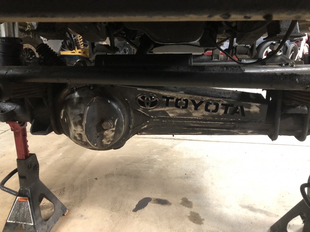

Headed out in the morning for exhaust. No more exhaust in the cab! Also going to go by car wash and pressure wash the axle housings to get ready to tear down and reseal them. The liner coating on the top and cab roof turned out decent to so that is a bonus.

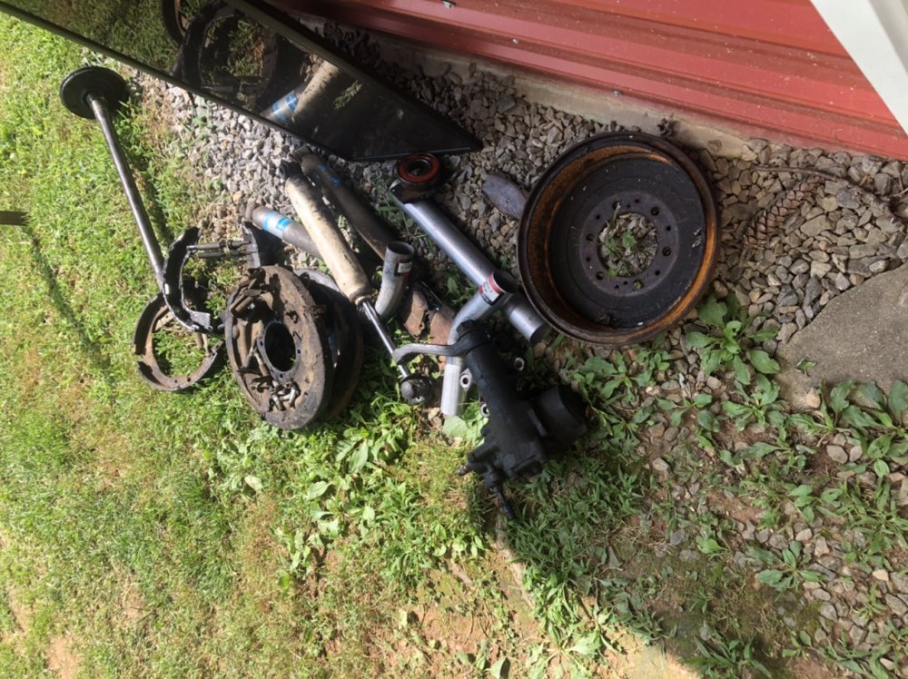

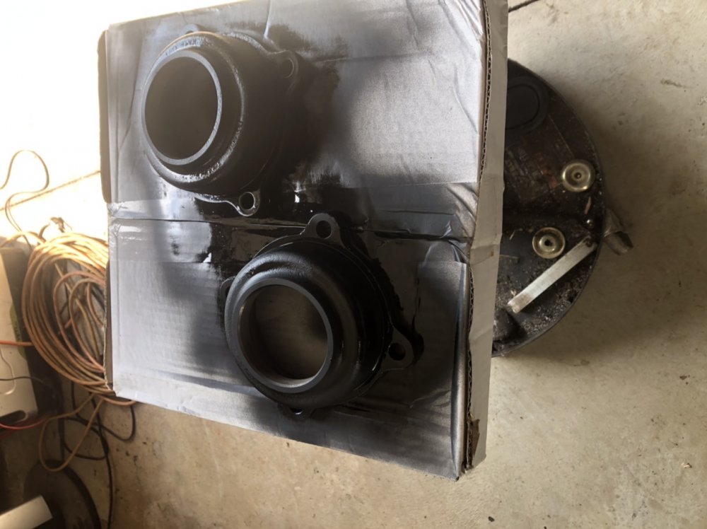

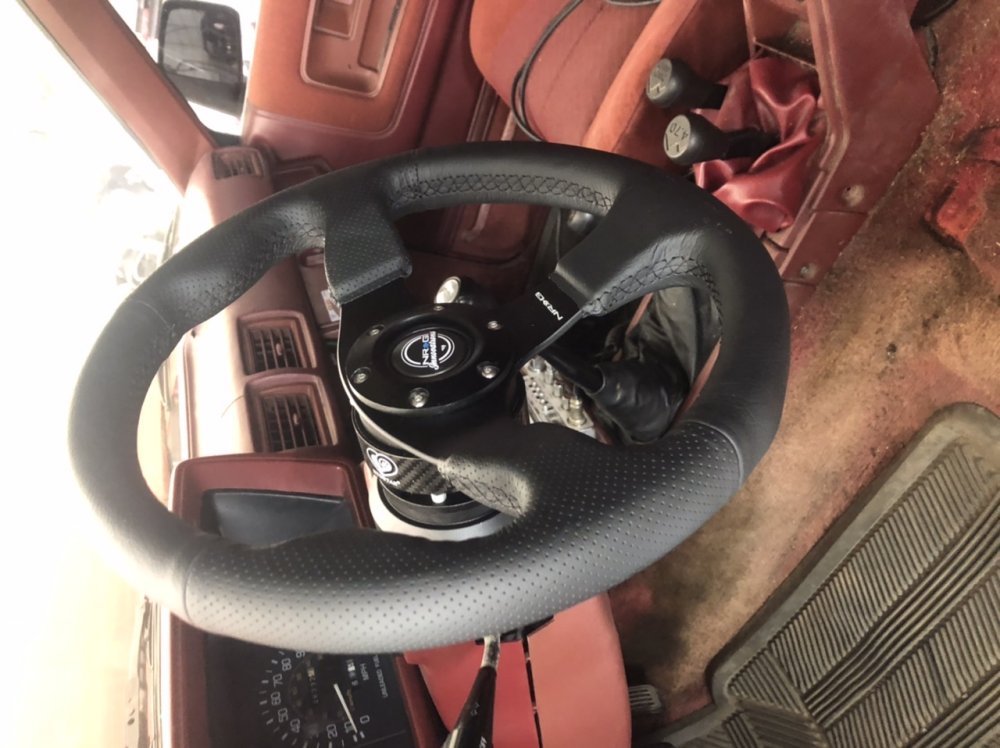

i got the exhaust fixed. Quick disconnect steering wheel in. Rear axle torn down cleaned painted. Ready for seals axles and disks if they ever make in. Found a shot axle bearing so replacing both. Pics coming. Waiting on parts to pile in but box is a ways off. May buy a stock one from parts store and just tap the damn thing.

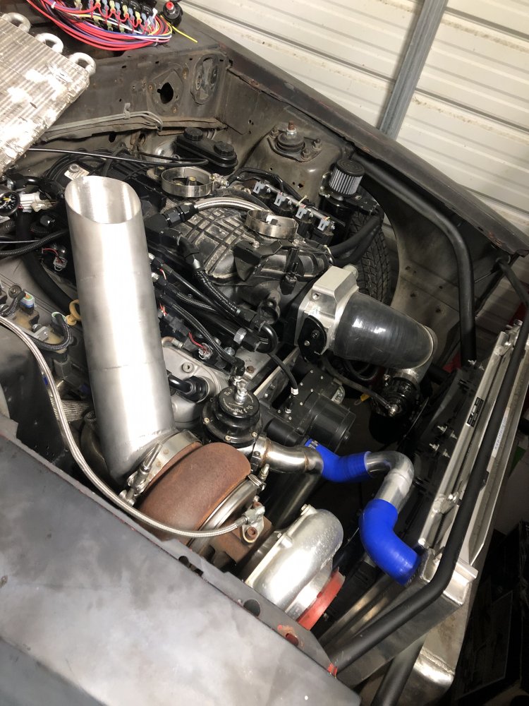

Buddy brought by exhaust for my fox though, looks pretty sweet....

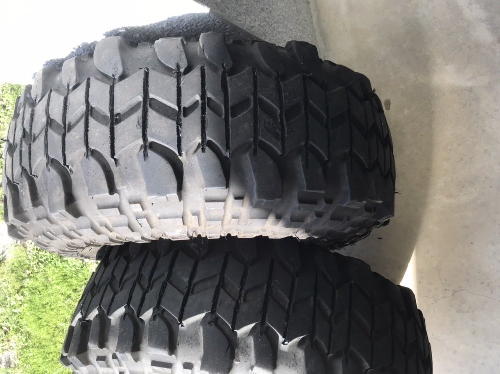

Grooving the tires a little to get a few rides out before getting some new ones in 38 flavor.

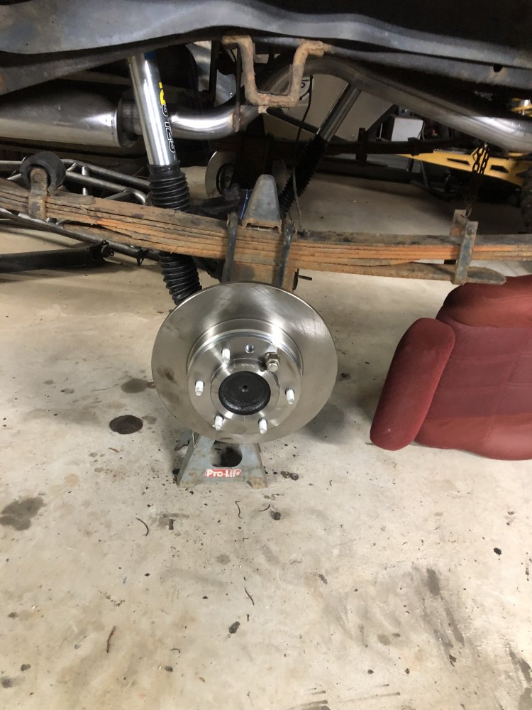

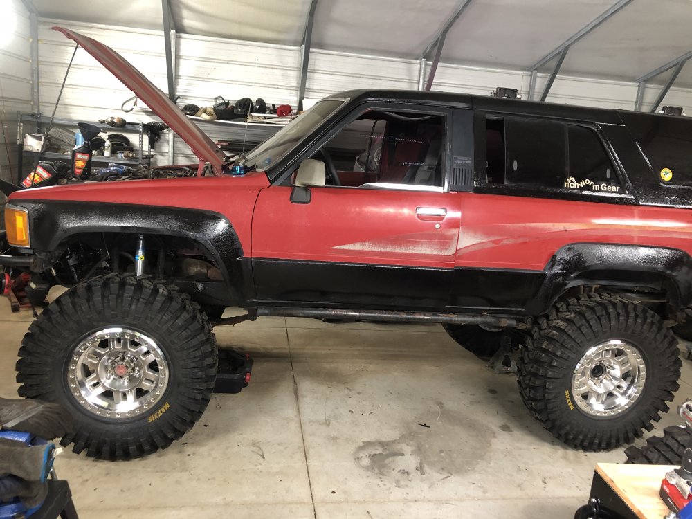

Progress. Getting close to being ready to ride. New chrome mo,y rears are in with new seals and bearings. Diff was out and cleaned. Disc brakes are on. Hopefully get time to mount the calibers and hook up lines tomorrow.

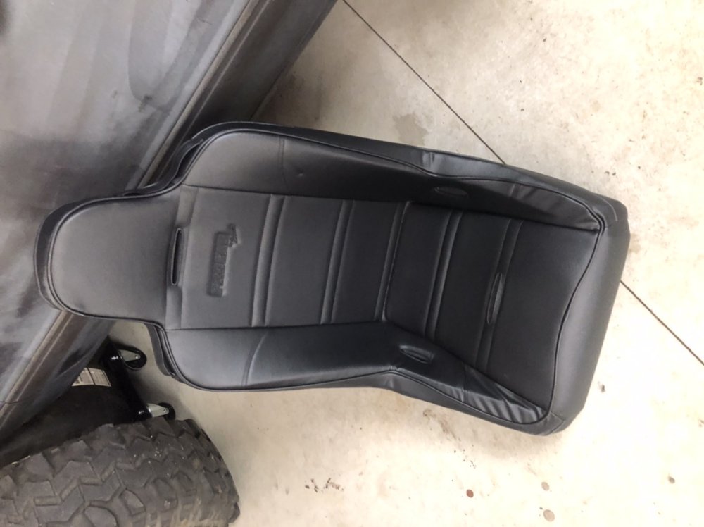

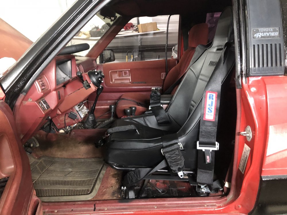

New 20 inch wide jugs suspension seat and harness is in. Used a new slider and made some mounts to cross breed the seat to the mount. Very happy with the removable steering wheel and seat set up. Getting in out is much easier and the seat and harness are a nice upgrade over the broke stock seat and busted factory belt latch.

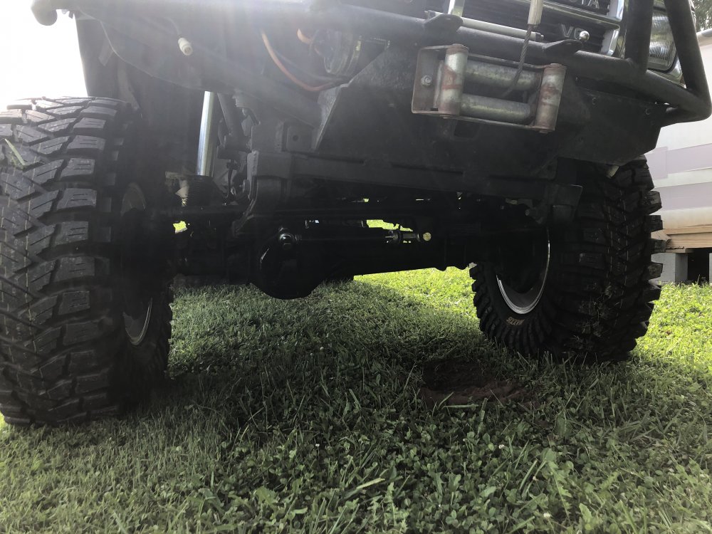

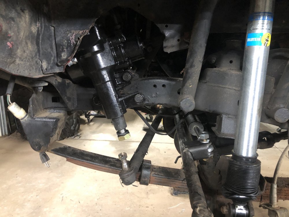

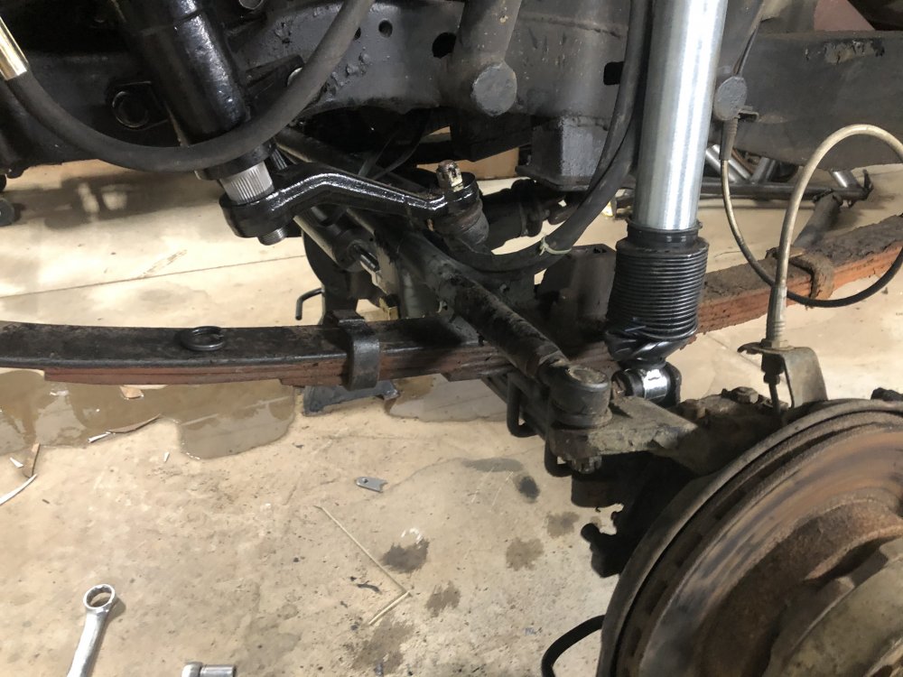

Steering steering steering. Box is in and ram is mounted. I ended up building new mounts for it and mounting it lower due to interference with the oil pan at front stuff. I welded in a diff strap and built off that. Braced it up and will build a guard ramp type bar shortly to protect it fully. The 2 inch bore will be great I’ve run the tractor farm supply version full hydro in the past but this one with chrome moly heim joints makes mounting easy anywhere. Hopefully get the thing bled out tomorrow. Still need to make a 3/4 inch thick stop for passenger side turns, got the material on the lathe just didn’t punch it out but plan to after work tomorrow. Getting close!

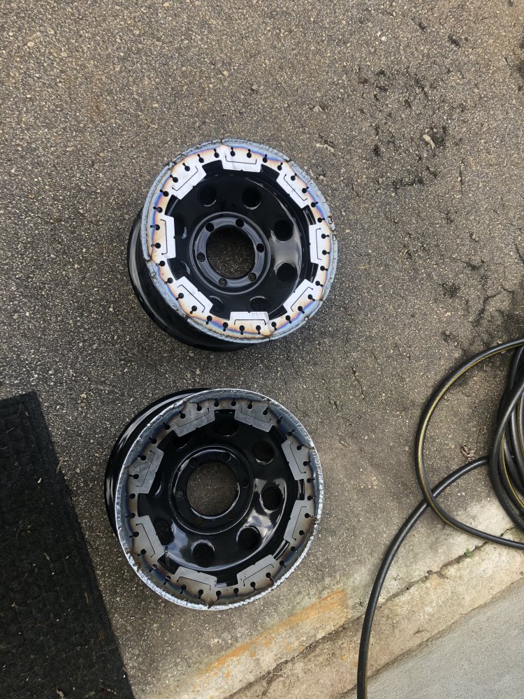

Beadlocks are done. Just need the new shoes. Finished up the ram was bleeding the system and found a leaking rubber return line so hope to finish that tomorrow. Installed the rear calibers and found a bad thread from plating so had to order a 12 by 1.25 tap to clean the threads out. Monday on that one. I plan to finish up the rear end tomorrow and install the new rear output seal and driveshaft then weld in the diff strap. Add gear oil and it will be done other than the one caliber and bleeding the system. Hoping to be on the trail next weekend. Dropping off the HP housing and goodies with Treadway Monday so it’s all coming together slowly...
What sliders did you use? How much throw do they have?
I put Carbou RS folding seats in mine, they are comfy but too tall. Head clise to the ceiling, and im only 5'9". Id rather use buckets but was worried that rear access would be too bad.
https://www.summitracing.com/parts/csu-c22023l?rrec=true
like the reviews said I had to open the holes or slot a couple to make it work. But works well with minimal effort. Clearance on the head is similar to stock. Moves more than stock depending on how you set it up on the holes, more back or more forward. I got it since the stock seat was toast and the belt latch was broke so I wanted a nice comfy seat with a five point harness. My passenger seat is still stock but I think it would still be able to move enough to replace the it to if you set it forward with less room. I’m 6 foot so I still feel it sits high.
Excellent, thanks. Didn't know they had "bolt ons" for corbeau for OEM. I fabbed my own but it ended up high. Part of it is the Carbeau seats have thicker bottoms so they end up taller too.

They did come through with it. Mounted and ready to go. I actually called to just swap the order for an orbital a couple weeks back to be told it shipped that day so it was on the way and I just went with it. Took like 15 mins to install and I was done a few days later when it arrived. Still wish I had done full hydro but I’m retarded and may do it later anyways after this winter. Who knows.

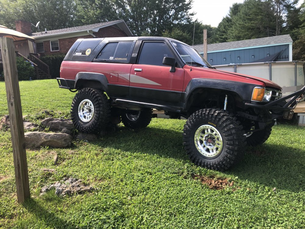

Out of the shop roaming the yard! Ready for its first trail run. I am for sure moving the battry to rear though to make room for the power steering filter. Also going to go to rod ends on the tie rod over the 80 tie rods in the high steer. It does allow the the wheel to return to center due the slop. I did find a popping sound backing up with the wheel cut full passenger so not sure if it has a cracked birf or something diff related. Treadway here is building me a high pinion front in the next couple weeks so I’ll tear it down then and find out but until then I want to try it out on some trails anyways.
I have to give Goforth Tire a shout, these tires and wheels are awesome and the price was great, so much cheaper than I could get either, and they arrived assembled!
