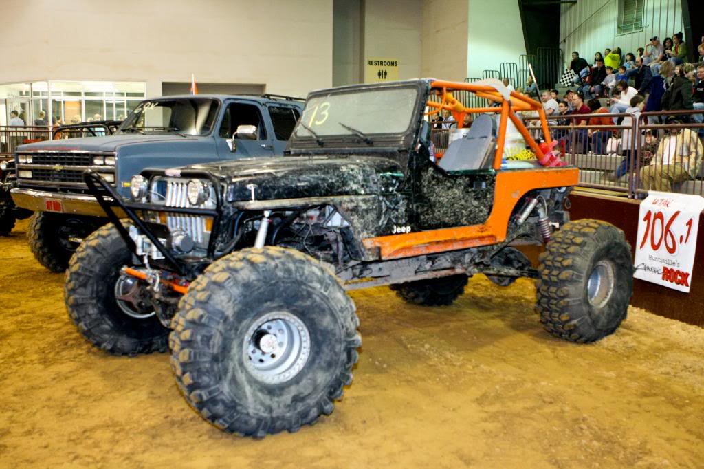

128 inch wheel base 60 front 513 detroit 35 spline chromies 70 rear detroit 513 35 spline chromies 44tsl cut 408 chrysler stroker stack 3 speed monster box poisen spider rock sliders and crush corners 4 think front and rear 1.25 himhs 16 rancho coilovers custom shafts 1410 joints in rear 1350 in front
