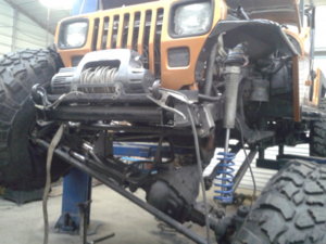

Well after paint I thought I really had to have coilovers and stretch the wheel base another 10 inches or so. I was at 102 before I had OLD JEEPS work his magic.
Scott 3 linked the front and re did the back 4 link. I with with FOX 2.0 air shocks on the rear and FOA coilovers on the front with triple rate springs. Scott did a mad job on the linking and is a great fabricator. I highly recomemnd anyone to take their rig there for work!

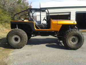

I am sitting on 42"pitbull rockers and 16" coilovers and 14" air shocks

I'm in the process of linking and ton swap on my yj now alsoand have a few questions for you. What's the wb at now?
There is a cross member running across. I still need to add the supports, but I will post some pics as soon as I can. I had some surgery on my elbow and down a little with limited work time on the Jeep. o_O
Jeep looks awesome man, glad those shocks worked out for you. You sure didn't waste any time getting to work on that!
What color is that?

Rod you have done a super job on that thing and have been very persistant. It has come along way in a very short period of time. I'm just glad you finally settled on a paint color.
The way your spelling you better slow down on the pain meds. :flipoff2:
Sick rig, love the color choice.

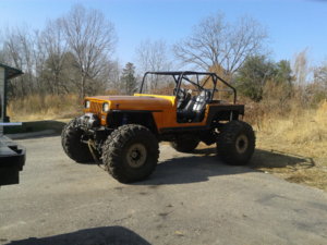

Thanks guys, I am about one weekend away from it going out for its firsh ride since the rebuild and 3 linking and coilovers.
Well i got to work on the Jeep some. I got the front drive shaft out and ready for the new one. New brake calipers and lines mounted. I took it out around the field for a short drive, got it washed and now its ready for the speaker pods and amp. Pic coming soo.
