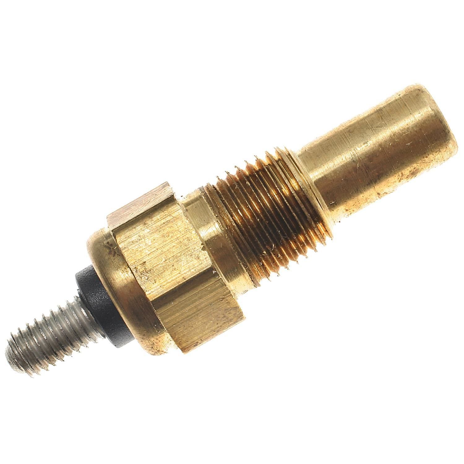

Your XJ has a sending unit on the back of the head. It provides a ground for the gauge to work.
The ZJ and XJ both have the ECT sensor in the thermostat housing. They each use its signal for PCM strategies. On the ZJ, the PCM sends the ECT signal to the BCM and cluster for gauge operation.

It's a single wire connection. I had the unit in the head loose the plastics. You could be over looking it if the plastic is gone. I have seen both styles in XJ's before.
One is for gauge and one is for "dummy" light (low option XJ w/o temp gauge
