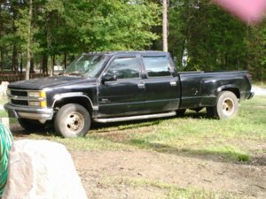

Plans are black grill, lights and hids, dually rockstars, (sas) 6" lift then planning to swap the 454 with the 12v 6bt, built 727, 205 tcase that i already have. leaning more towards selling the 727 and 205 for a 47rh. havnt decided on what tcase to go with. heres some pictures of it.

Depends on what front axle you're going to use. It'd be kinda handy to find a Ford 60 to use and keep the 241 DHD or DLD behind the 47rh.
that 727 is going to completely suck behind the 12V - no OD or lockup converter...and could be even worse with converter and tire choices
