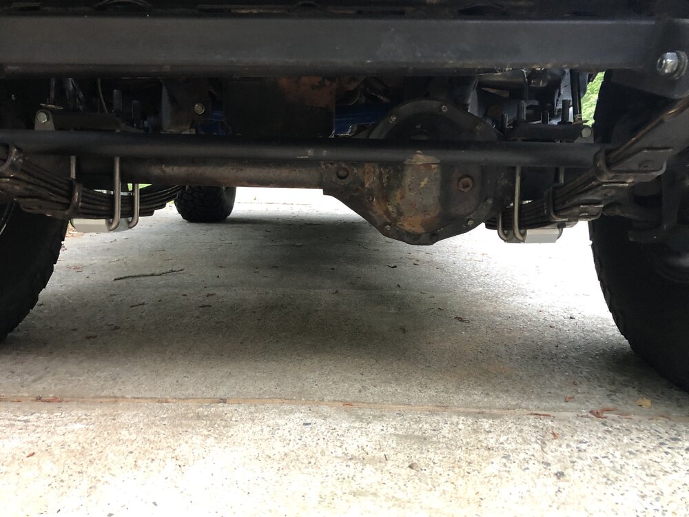

Hey everyone.
I haven't even wheeled my pathy yet since getting it off jack stands, but after driving it, something is off. I feel like I measured correctly, but somehow the passenger side shackle is 1/2' farther back than the driver side causing the shackle to be angled forward. The truck was in a fairly substantial front end wreck before I owned it and if you really look at it you can see that things aren't 100% right. It was the passenger side front that I always had problems with tire wear and that UCA took a longer bolt and a ton of washer to get the alignment (caster and camber) even close. I am not surprised that between that and my own human error something is not right and needs to be redone.

Frame probably is not square if it was in an offset collision. This is a tough one to measure with a fully assembled vehicle. Does the vehicle sit level side-to-side? If not check for a stiff shackle bushing; if it does not swivel easily it could "jack" that side up somewhat. Measure the compressed length of both springs eye-to-eye to ensure that they are both identical as well. If one is either longer or softer than the other it would result in a slack shackle angle.
funny you mention the springs they were new 44044, but they sat outside at Jed's place-- I think on the ground for a good length of time, and there was a bunch of scaling rust between a bunch of the leafs. I cleaned it up best I could, but I have thought about getting new springs too.
I would spend more time under the truck with a tape measure comparing things before replacing the springs. I know how beer gets consumed during build sessions...

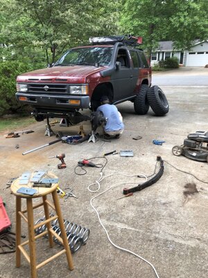

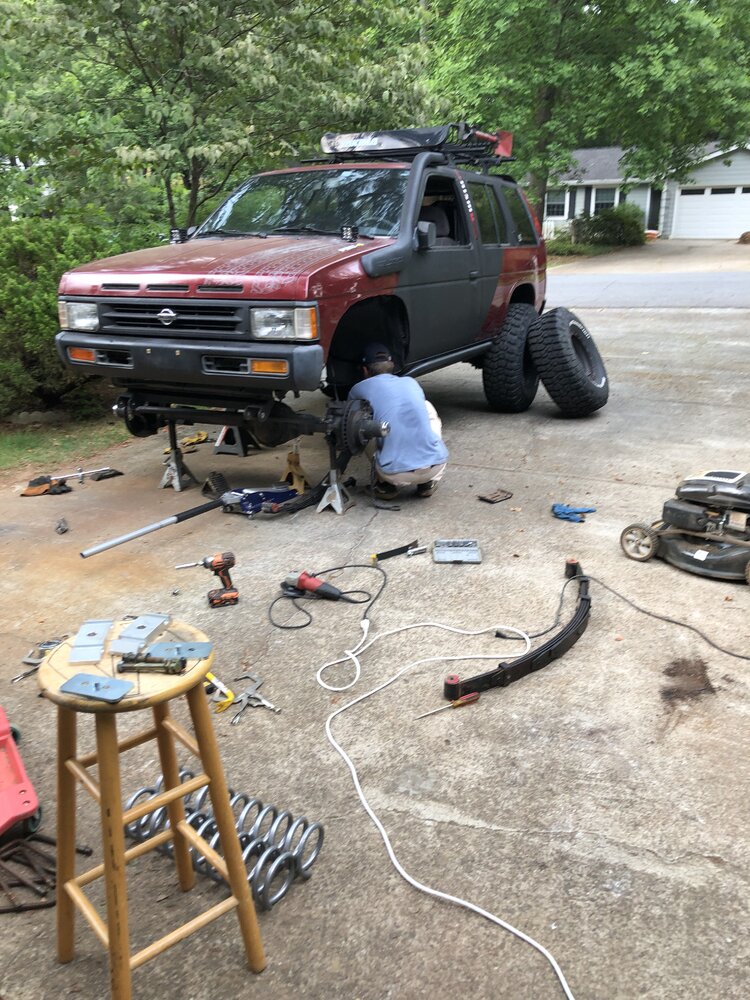

No a whole lot new here. A pile of parts that need to get installled. Been working on wiring recently - lights, push button start, radio.
Prior to that I was chasing a misfire - plugs wires, cap, rotor.

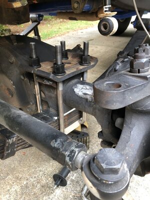

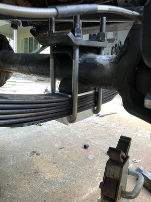

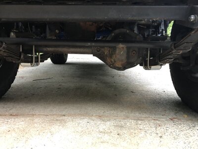

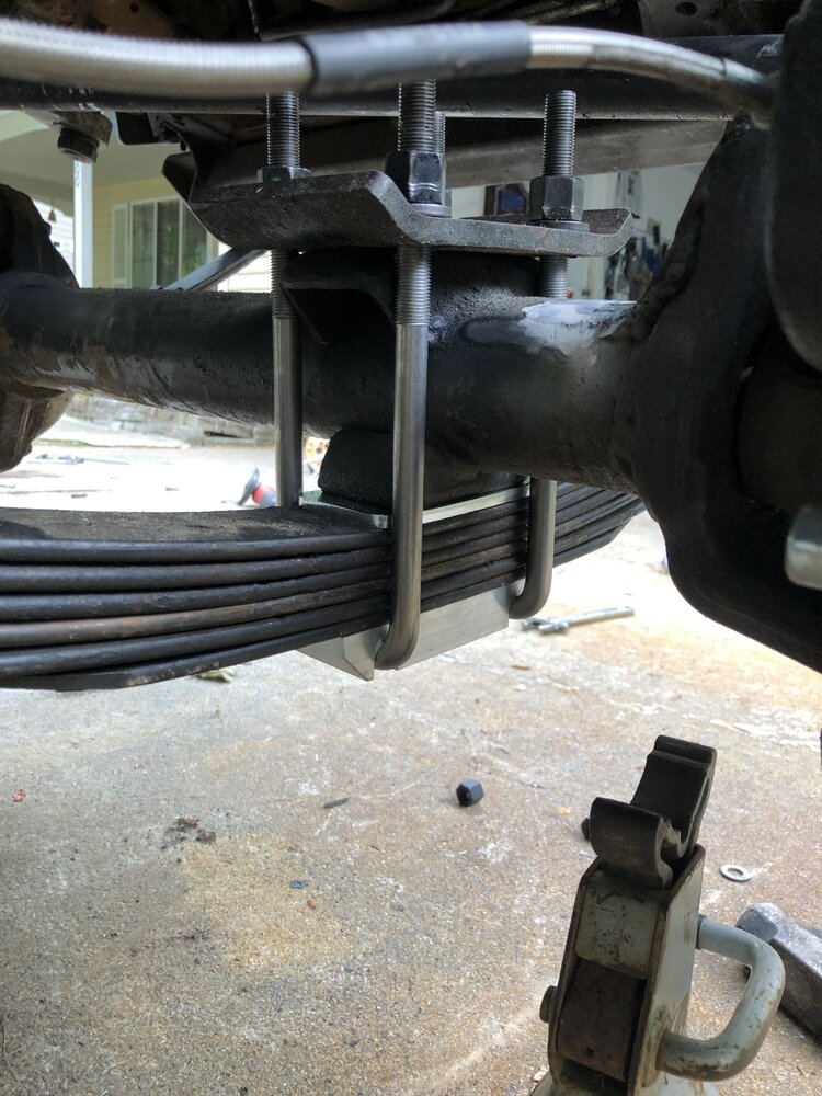

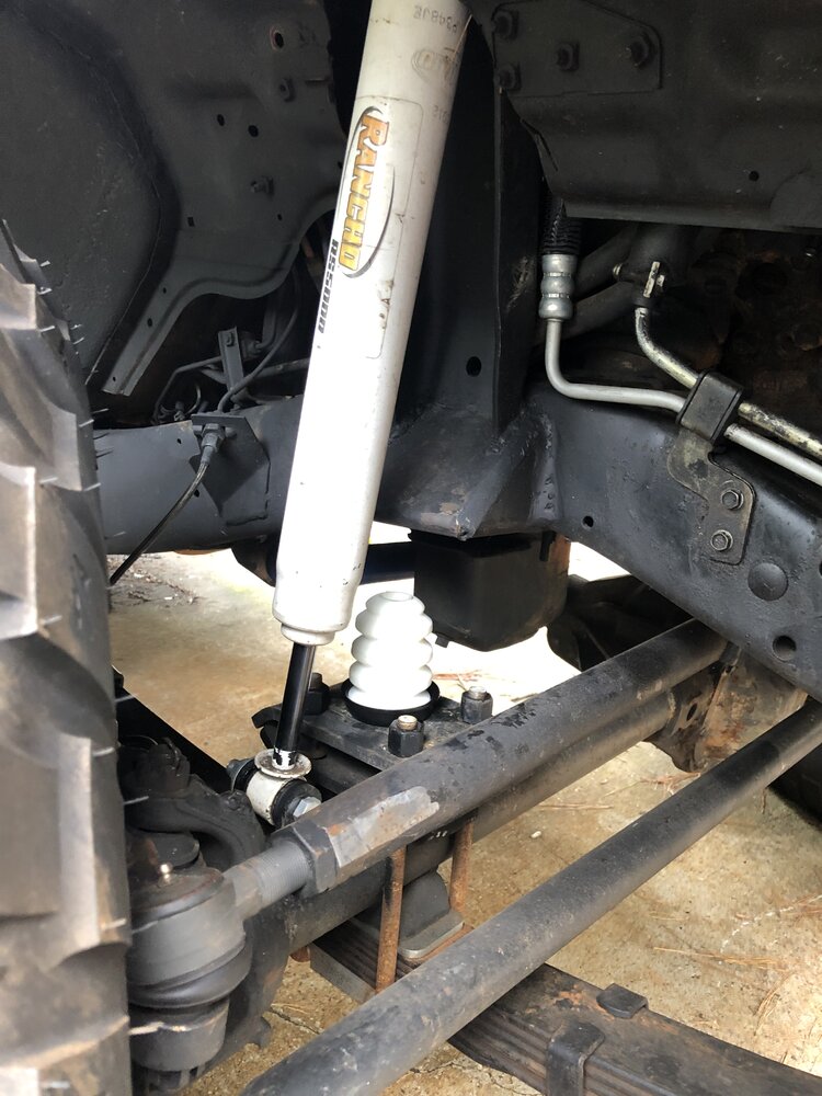

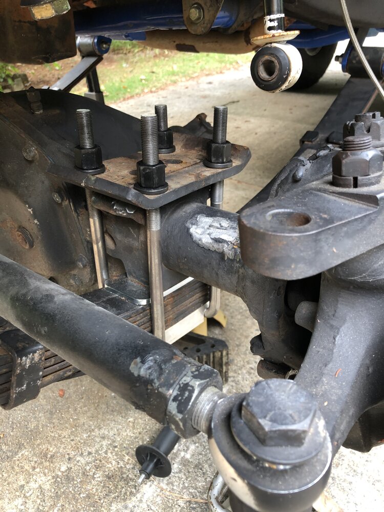

next is to add the 3rd spring back to the 44044s since I have 4” lift springs for the rear, move the front axle forward 3/4” with a relocation plate, add bump stops and get the slider boxes installed.
Looks good nate! Hope we see you at Hollerwood in a few months.

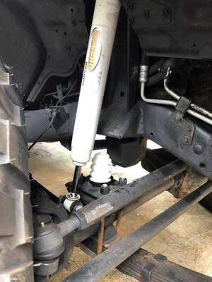

Front is done with adding in the 1 leaf, moved forward 1” and with the ubolt protection. I’ll weld on the relocated shock tabs tomorrow
Then figure out how to put the new rear springs in w/o a lift or spring compressors.

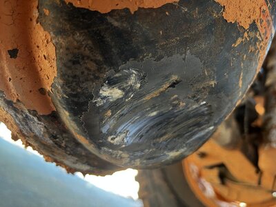

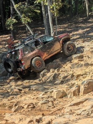

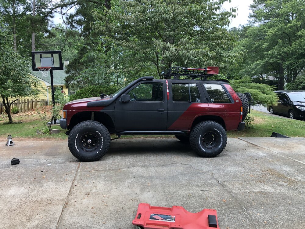

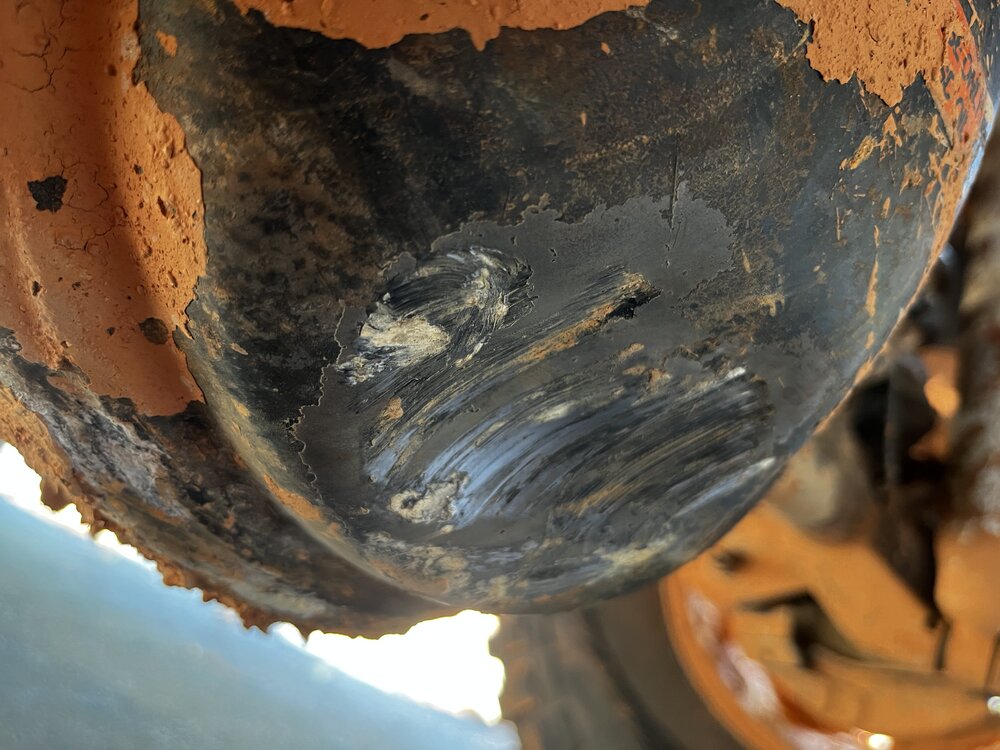

Long overdue update. She did good. 5hr drive, wheeled 6.5/10 Nate - drive 5+hrs home.
Fixed the exhaust on trail in a few minutes after it cooled down.
Dented thecshit out of the H233b, which ain’t easy to do. It’s not touching the ring gear, but it’s gotta be close.
