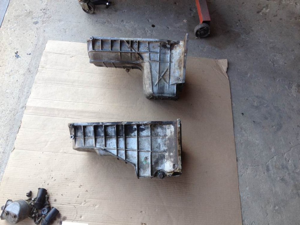

Are the oil pans different between the 2wd and the 4wd 4.3 different? I think I just found the answer out the hard way. Just set the motor from a 2wd down in a 4wd and the motor mounts are close to lining up but the oil pan is hitting the front diff.
Yes they are different.
Here is a pic. 4wd is overall deeper. 2wd is shallower but slopes down more.
4wd has drain plug on bottom pass side of pan facing rear. 2wd has drain plug on driver side facing the driver side.
