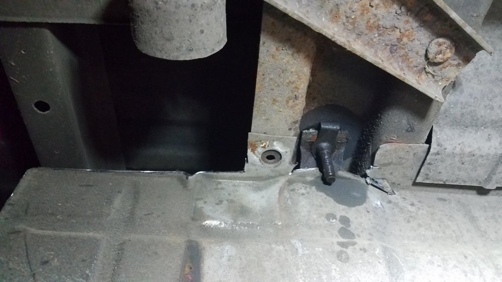

Anyone dropped their saddle tank without pulling the bed? I have to repair a rusted brake hard line and it is in the way.

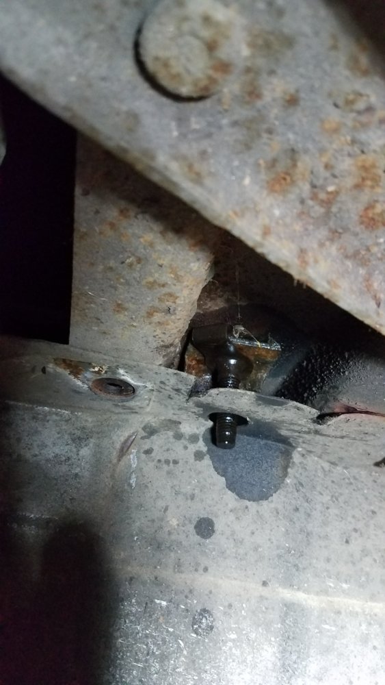

I dropped the skidplate to find that the bolt for the rear strap on the tank is accessed from above. I may be able to finagle it out between that bolt and the heatshield kwhich is accessed from above as well), but it appears that it is going to be a bitch.
Wasnt sure if anyone has been through this or not. I am rather perplexed. Wtf was ford thinking

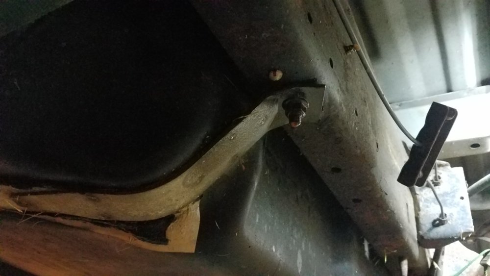

The strap bolts should be accessed from the bottom. Look above the driveshaft for either a bolt going up, or a stud coming down with a nut on it.

I agree, they "should be"....ford decided otherwise. One of them was from the downward side. The rest are on top with nutserts on the bottom. The same went for all the heatshield. Cut away some of the heatshield to shorten up the bolt on the rear strap so i could clear the bed with bolt. Was able to get all the heatshield bolts out, awkward but i got them.

I feel ya there, definitly thought about it, but i am going to take advantage of the situation and mod the vent so i can fill the tank faster. And also would like to go ahead and clean the pickup screen. Truck has 400k on it and has been sitting for quite a few months since brake line blew out
I'm betting that someone else has had the tank out in the past. Probably for broken straps. The clips and bolts are too clean for on, and I have never seen a Ford gas tank strap stick past the frame like that.
