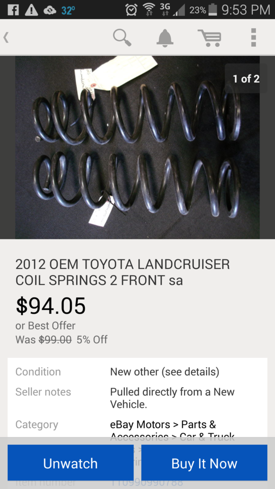

Fj80 Front coils on the Rear of you 4unner will give you anywhere between 3-5 inches of lift depending on what spring it is.

Would these work?
