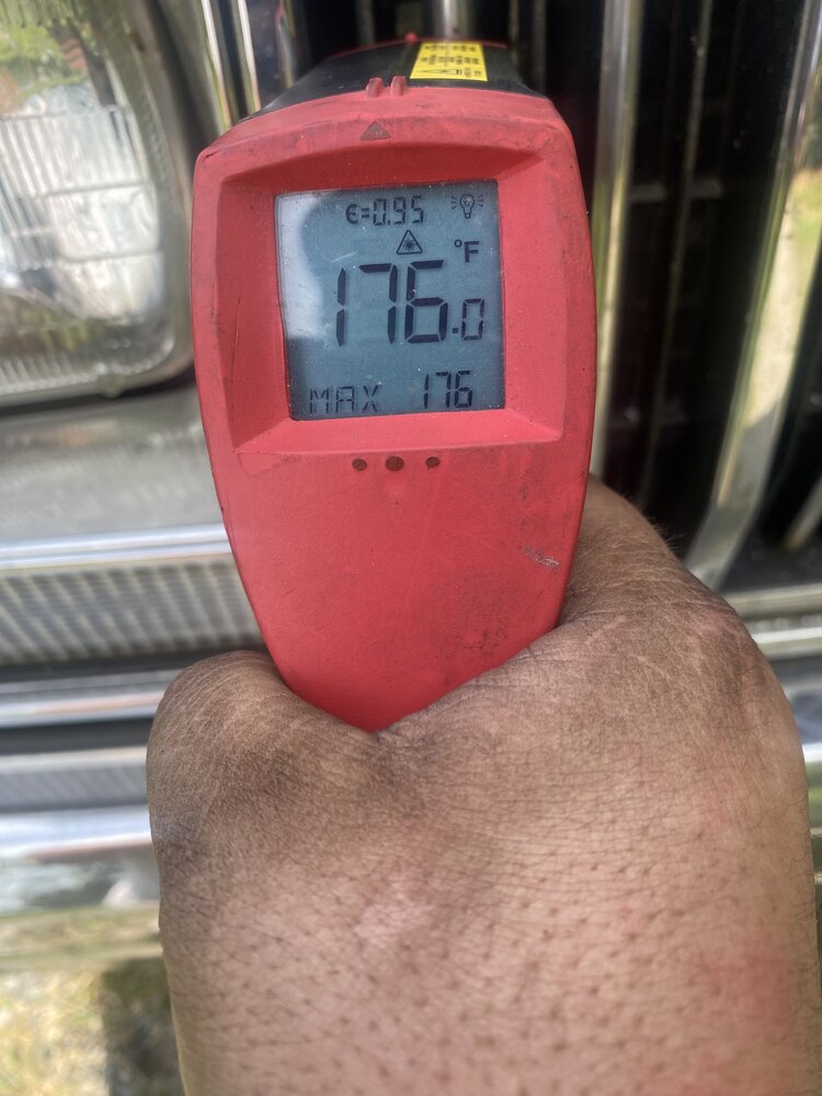

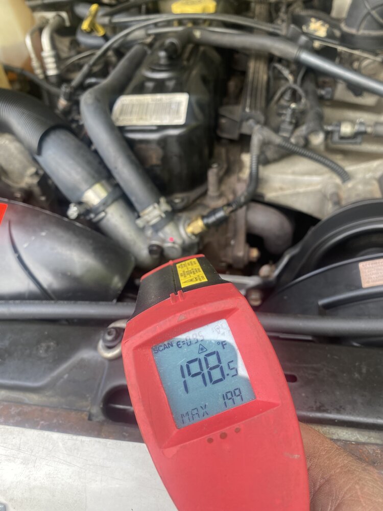

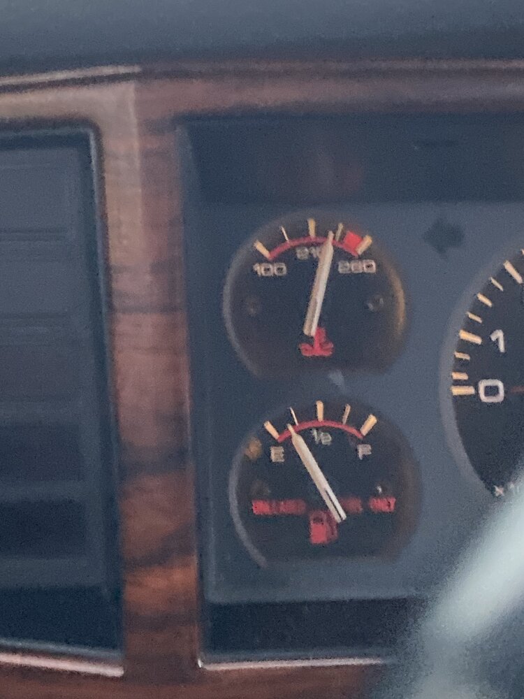

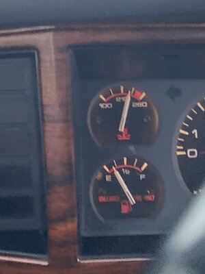

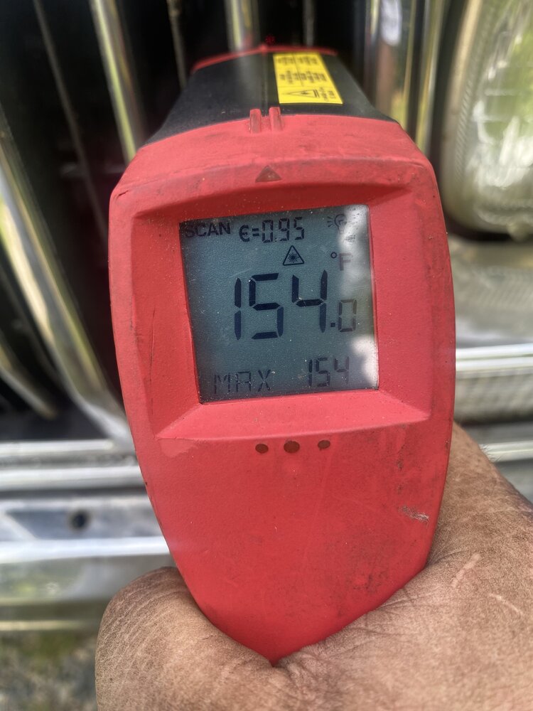

Temp reads normal when first crank Jeep from sitting over night. But as soon as I hit the road it jumps up to 240. Which I don’t believe it is. So I changed the sensor in back of head. Didn’t change anything. These are my readings after driving for 45 mins straight.
198 at thermostat housing
176 on hot side of radiator
154 on the return side.
No signs really over heating besides the gauge on dash. Any suggestions ? before I run a auto meter gauge to check accuracy.

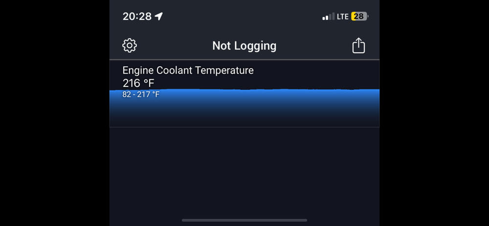

Sending unit in the thermostat housing goes to ecu, back of the head sending unit goes to gauge. Got a scanner you can plug in and see what the ecu is reading?
This.
Also there are 2 different sending units for those. One for use with a temp gauge and one for an idiot light. The wrong one will cause this as well.
First you need to see what the PCM is seeing like Mr @grapehead said.
Data from My live feed scanner on way home from work. 45 min drive. Highway then backroad.

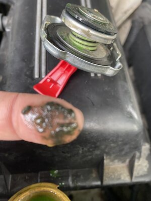

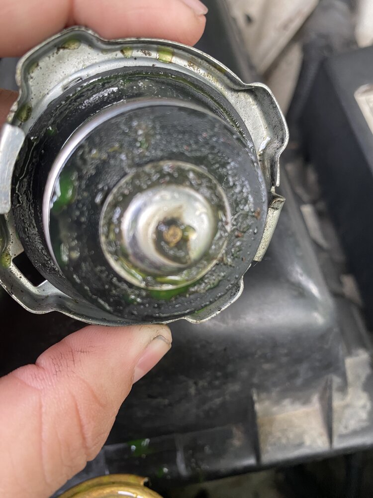

Maybe check for exhaust gases in coolant. Just for peace of mind. What condition/age is the coolant?

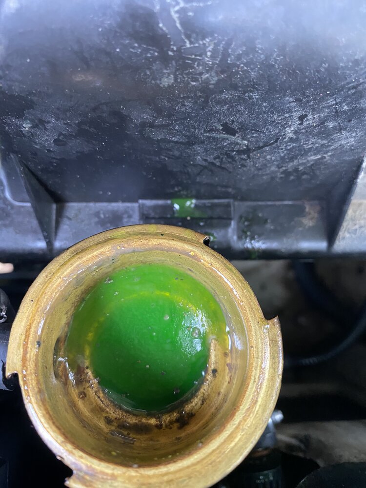

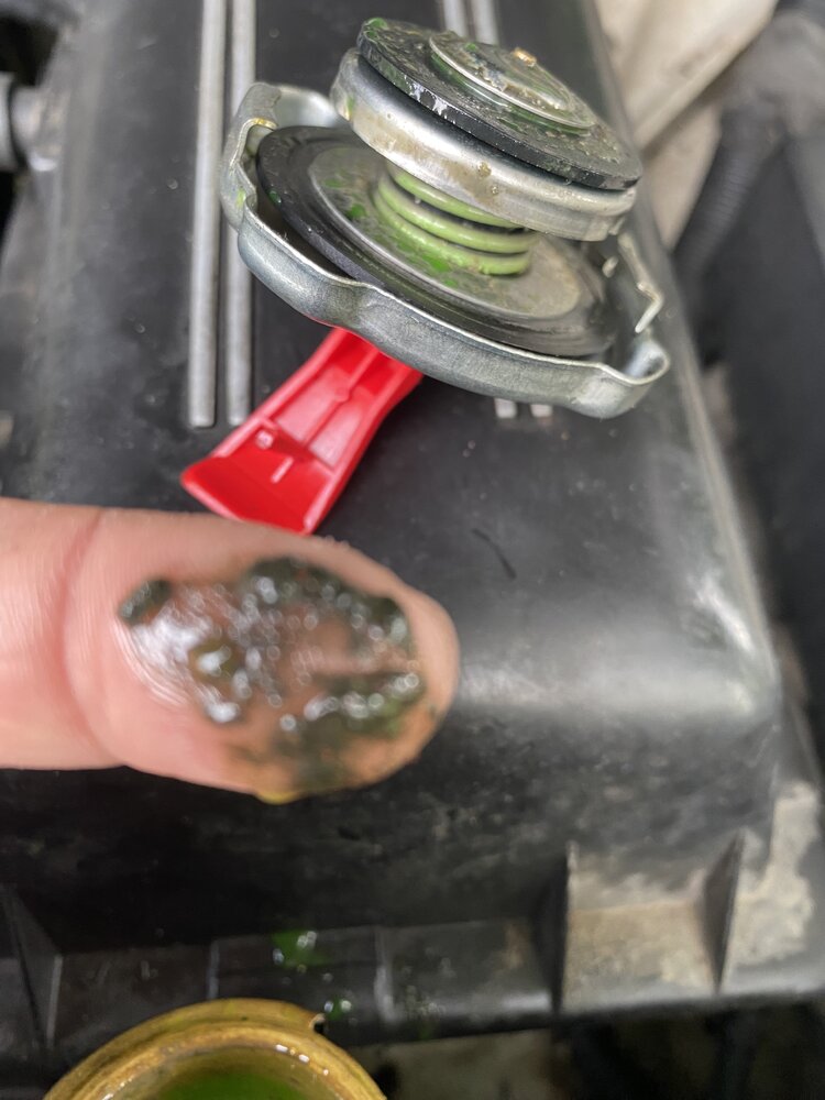

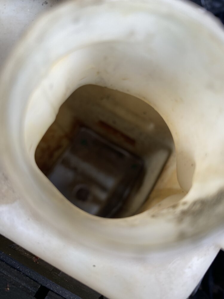

just did a flush and went back with new coolant less than two weeks ago. Off today so went to check it out. Found this I’m sure it’s the head gasket
