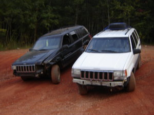

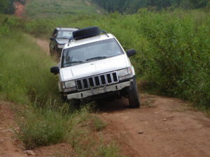

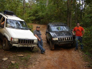

sooooo, this is my turd, Ive been buildin it, wheelin, and destroying stuff on it for about a year now. Started out as a decent looking DD with a salvage title that i picked up for $450 from a couple in charlotte. They used it to pull a boat halfway across the country and fish, and well, drive it. Had a bad wrist pin knock on #3, that was the main reason I got it so cheap.
First hings first, I orde the motor till it popped a rod (got about 400 miles out of it) and replaced it with the motor and trans out of a rolled zj that I had already purchased with the intention of fixing it. I can't located any of the stocker pictures, it seems they're on the hard drive of my other computer which wound up having a short in the motherboard.
But this is where it sits now, stock/rebuilt D30/D35 combo with 4.56 gears and trutrac limited slips front and rear, cheap ass 3.5" rough country lift (boy do I regret that now), 33's, 2X6X1/4 rockers, hurculiner interior, power leather seats, and lots of dents.
Some stock pics from about a year ago::driver:

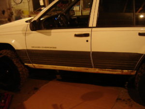

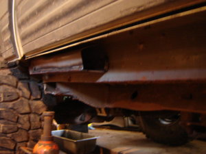

After I cut the fatory rockers off, keep in mind, I did the drivers side back about last february, and just yesterday finally got around to doing the driver's side. working full time and goin to night class will kill your time!
Seeing biggoofy's build is what brought me to do this, although i went a different way about doing so, and used different size tube to gain a little more protection on thge sides, and it would give me more room to tie in tube fenders or whatnot if i decide to later. Not only that but it was much much cheaper to buy salvage steel than new, and this is what i could find and it served the purpose well.
I tied the panel into the unibody be using angle iron to tie the pillars in and then using plug welds to tie the tube (notched for the angle of course), the entire thing is assembled by plug welds, so why not keep it going?:rolleyes:

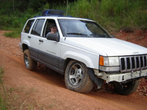

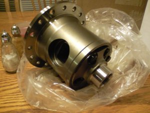

trutracs, well worth the money and they work very very well on the street and handle surprisingly well in the snow. installed a 4.56 ring and pinion set for the first time, ended up ruining one rear gear set, but I got it right the second time. It's a total pain, but i saved a ton of money and learned alot in the process. couldn't be happier on this setup with 33's

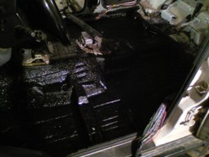

carpet started to smell awful, so out it came, and then came the hurculiner. Seems the stin was coming from a standing pool of water where the AC drained into the floorboard for some time. Had to fix about a 6"X10" rust hole. Got that taken care of, and then installed a junkyard leather interior that I scored for $95.
hiding the wiring on a ZJ is a common problem, so I improvised bu using pvc pip as a conduit, gathering up elbows, and then splitting the pipe and using conduit clamps to attach it to the side of the floorpan. TJ rubber floor plugs worked in place of the factory steel ones.

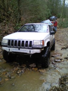

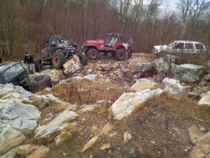

some photos from a trip with some friends to lake houser a while back. this gives you an idea of where it's at now.

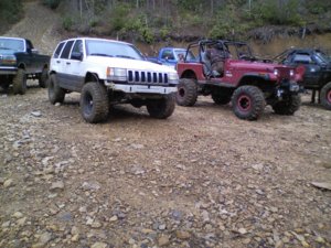

Moutain city back in february
