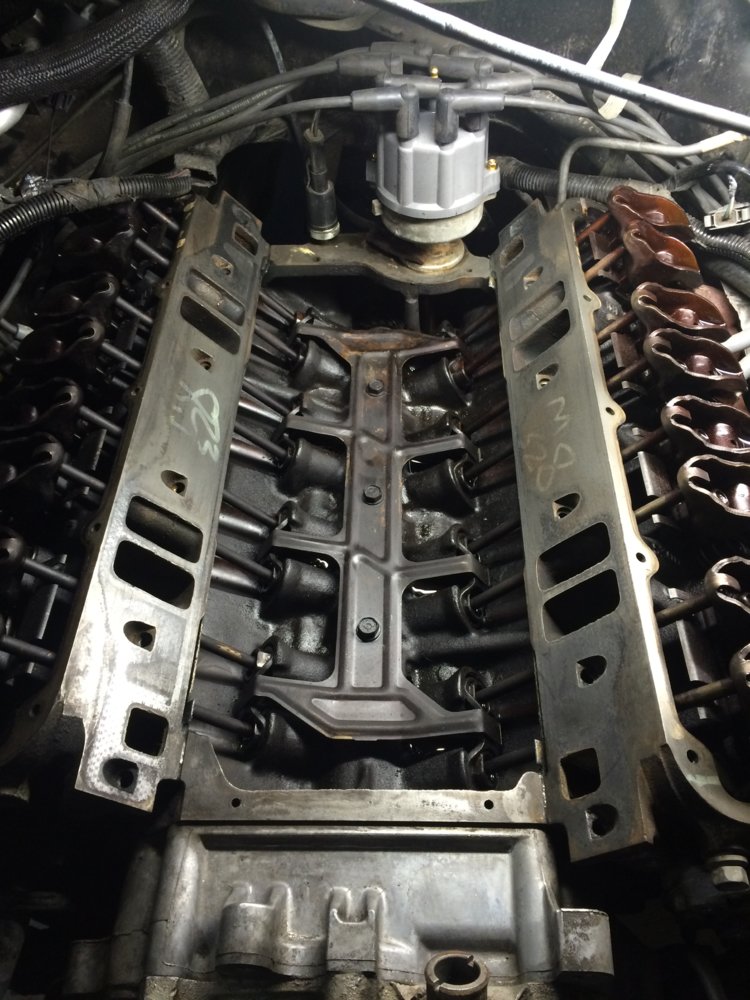

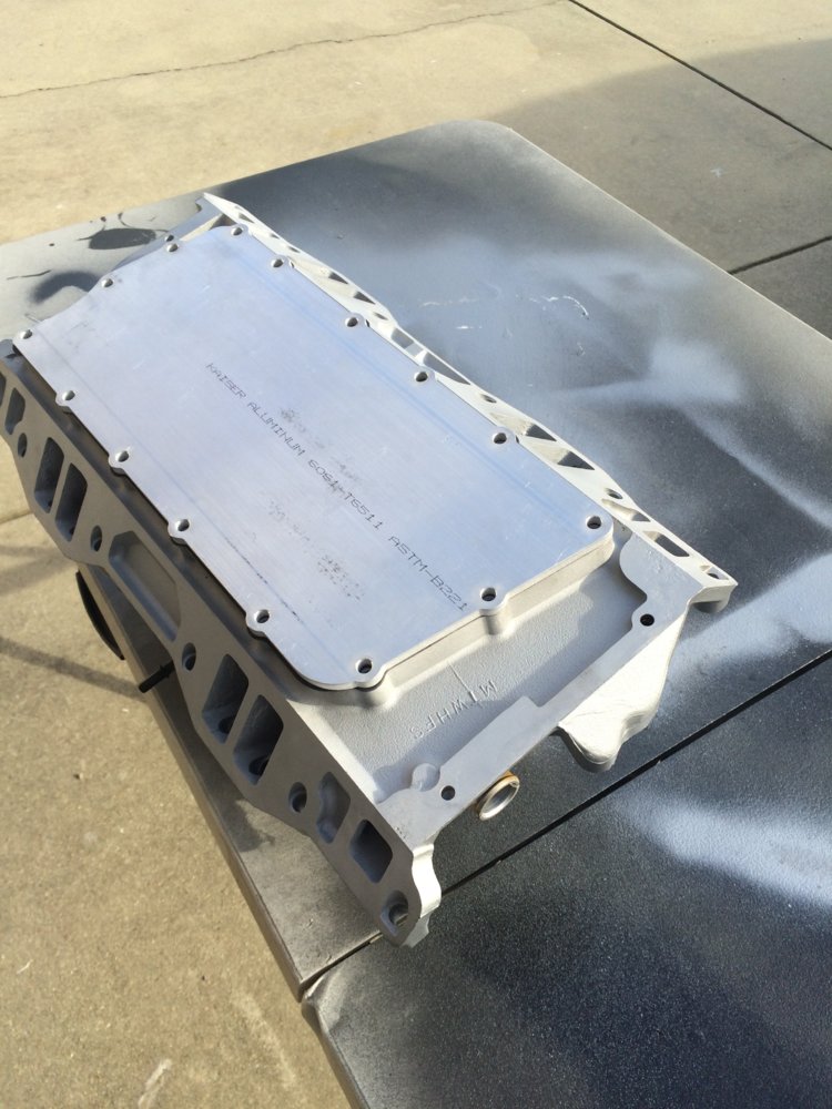

This. I did my 360 at about 190K. It had already been done at least once. I made my own AL plate on the plasma table. Most of the dodge forums say go ahead and do the timing chain and water pump while you already have it apart. Plenty of DIY guides around.
While I had mine off I had the machine shop hot tank and bead blast it to get rid of all the oil residue. Gave it a quick shot of engine paint and it all went together like butter. The results were immediate. Improved idle, throttle response, and fuel mileage.
Spark knocking and a general miss is always the finger pointer. My 360 would drink two quarts from Hickory to Sanford pulling a 16 foot enclosed to race harescrambles on a weekend....Put that intake on the tear down table and you'd thought I spilt a quart of oil.
