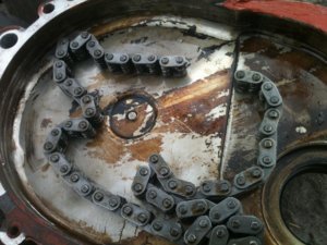

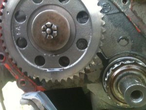

and thats why i didnt have spark...

Found another problem with the block.. When the chain snapped it smackevthe block and put a hole going to the push rods... So of course I'll be rebuilding this... Got a block comin to me later today. I should be able to reuse major componets. But will be swapping when needed... I may just go 30 over an make it a 4.7... Currently it's at. 4.5... All that would need to change would be the bore... Decisions decisions lol..
