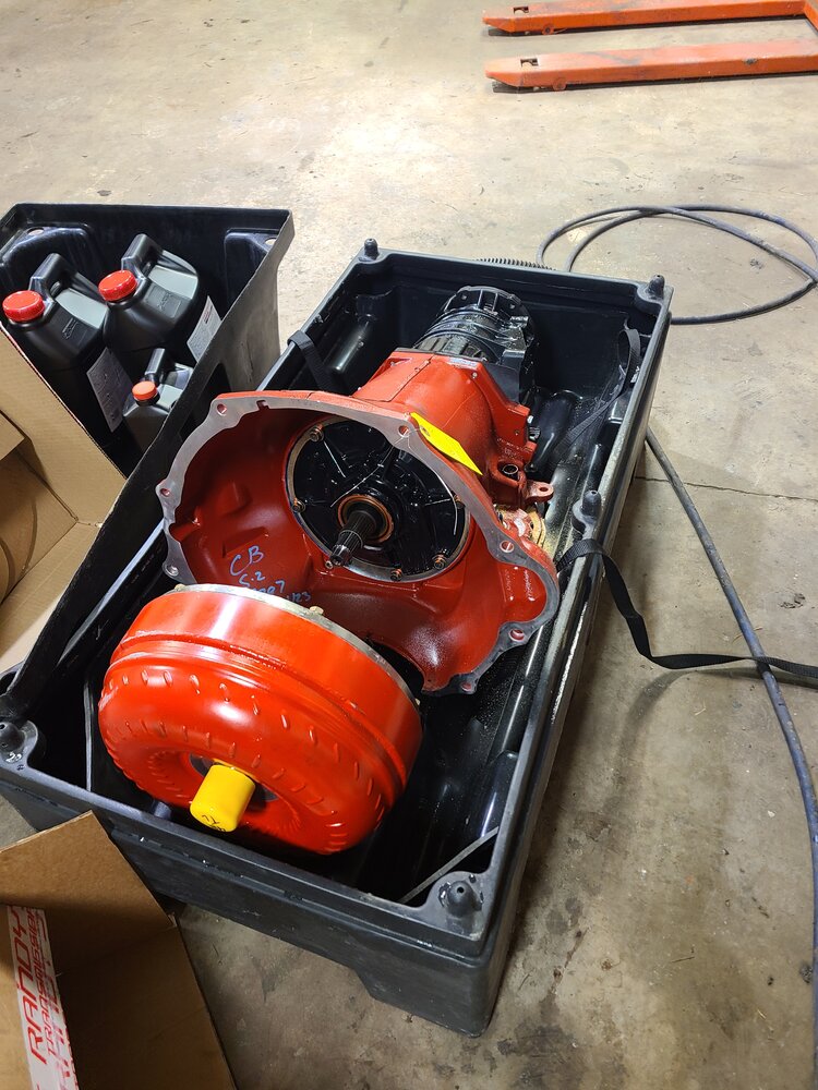

A nicely built 47RE with a good, triple disk converter will solve all your problems :D

Find a competent trans shop and do what you listed. Cross your fingers and drive the heck out of it. WHEN, the time comes buy an upgraded auto.

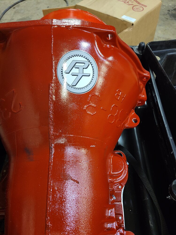

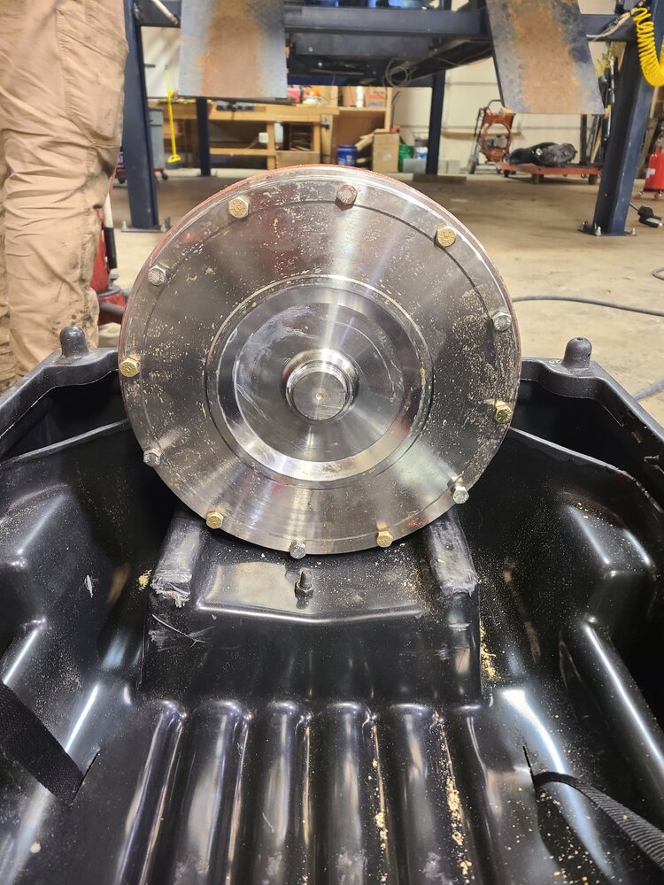

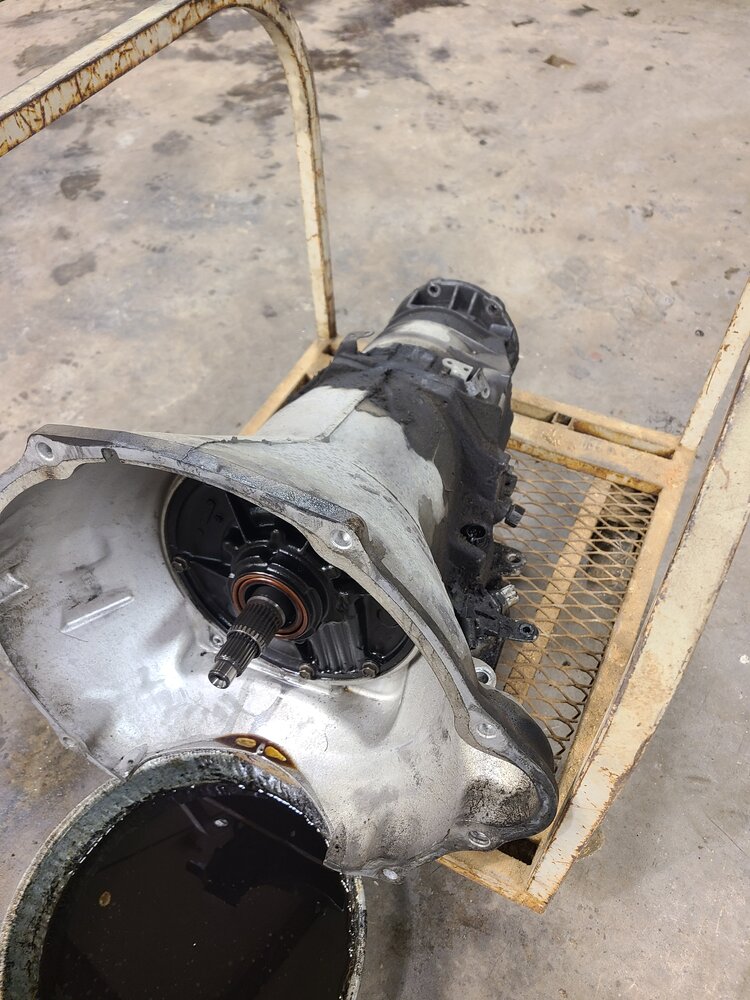

Flushed? No, just drop the pan and change the filter. You can unhook the cooler lines and back flush the cooler itself, if you want. Adjusting the band is always a good idea. Not sure you can increase line pressure without valvebody mods. Really, the main weak point is the stock clutches'/band's holding capacity and the material they're made from. Same for the converter clutch. It gets to a point where they're simply overpowered and can no longer hold.
When that happens...things get hot and the fluid gets this nice, dark, glittery shimmer to it :D
For reference:
This is bad...
But this? This is goooood!
I didn't dig in to this stock one very far, but I do know that the band anchor broke, the band was smoked (as was the drum), and somehow it still shifted almost normally.
You'll probably be fine as long as you drive it like you have some sense. This one was not driven that way. Quite the opposite, in fact! Now it doesn't give a damn what gets thrown at it.
