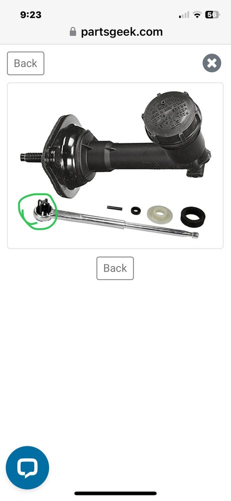

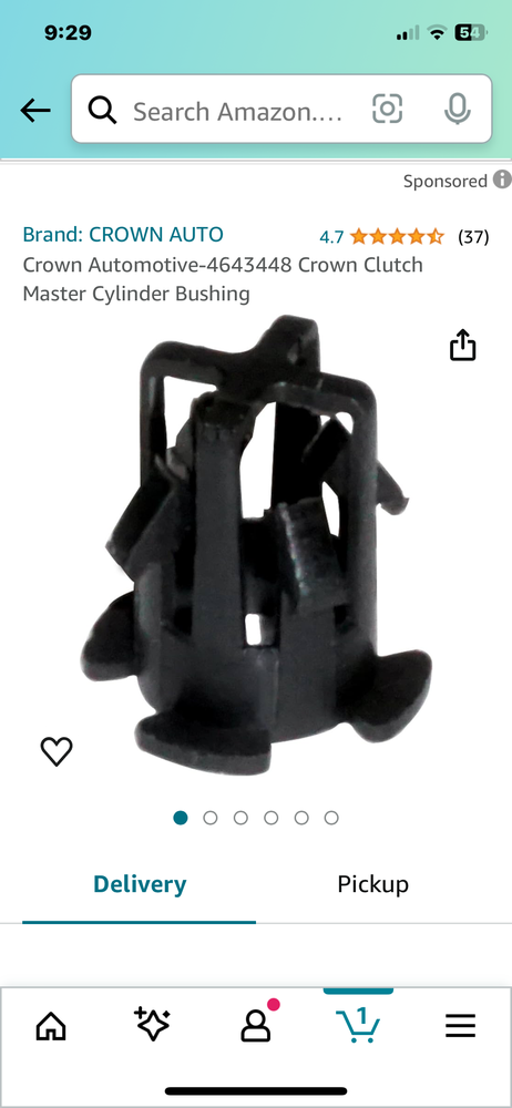

So the Interwebs have not been useful, my clutch bushing (retainer) is shot. The part seems non existent for an XJ, I have found a few that claim to fit a TJ of the same year (98). Surely it’s the same, but wanted to see if anyone else has run into this before I order. The old one looks like the one in the picture. Crown auto offers one that fits the TJ and Libertys but does not mention an XJ. It doesn’t give any dimensions for me to compare though.

It should be the same. Maybe a long shot but check dormans they might have just the bushing. I probably have one from a wrangler stuck somewhere if you cant find one let me know. I will look and see
Text me tomorrow and I can compare a 99XJ to a 2000 TJ. I had to replace the one on my TJ a couple years ago.
Damn manual XJ people.
The wait is over, it is identical, definitely ordering a spare before they discontinue the part.
