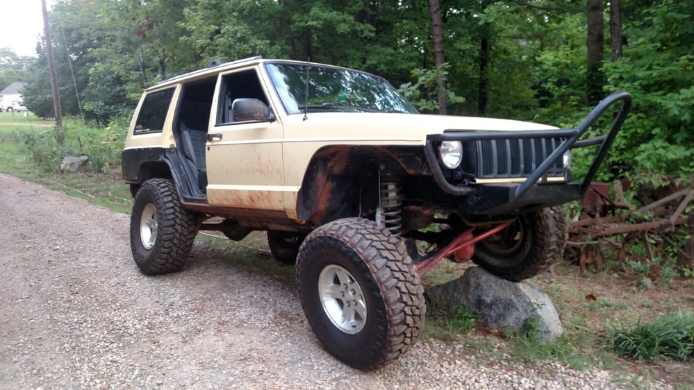

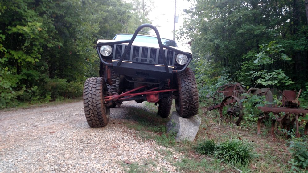

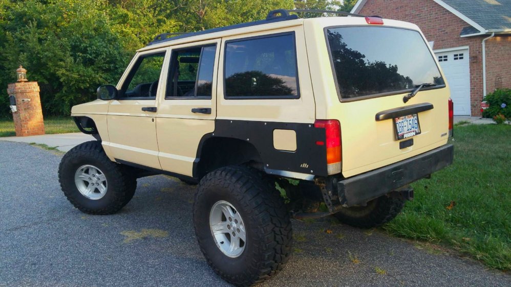

Just bought my first jeep.
Exterior/armor
  • 98 XJ ~180k miles
  • Custom desert tan paint, door jambs, the whole 9 yards
  • Removable doors
  • JK headlight and modified grill
  • Stinger through unibody
  • Dirtbound off-road quarter armor
Suspension/Tires-
  • 6" long arm lift, custom 3 link front
  • IRO OTK steering
  • Adjustable trackbar
  • JKS quick disconnects
  • Wrangler wheels w/ 35x12.50 mastercraft mxts
Drivetrain-
  • Front and rear 4.88 gears
  • D30 front
  • D44 rear from Isuzu Rodeo with LSD
  • Rear wheel adapters
Interior-
  • 2001 interior, new headliner, etc
Performance-
  • Airbox mod
  • Banks header
  • 4 hole injectors
That's it I think, some pics

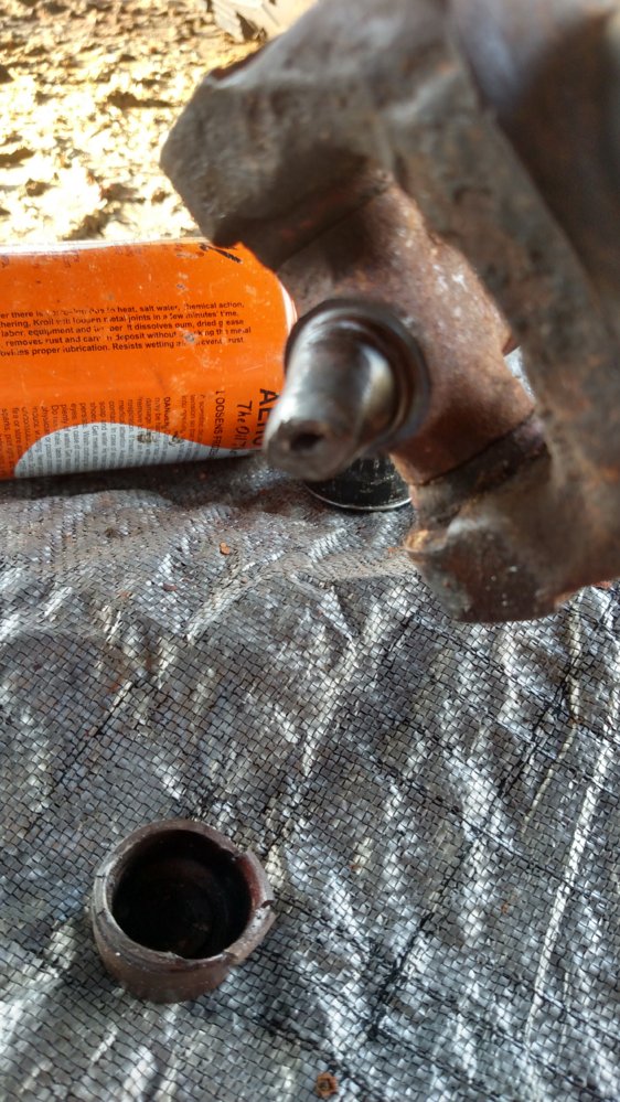

Lol minor update bought the heep and didn't have the discos with it, got them the other week from the PO
just put them on... Lol well I'm sure y'all know how big of a difference it makes:rolleyes:.
Yay vibrations...
has a nice vibe when on the throttle, went over u joint front and rear motor mount guess now I just need to start going through every thing(and cleaning and buying gaskets):bounce:

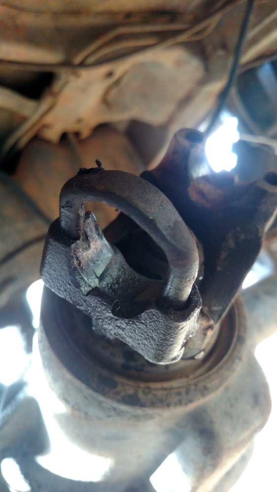

Anybody have the yoke off of the differential from a D44. My rear end is out of an Isuzu rodeo if that helps. If the rain ever let's up I'll count my splines.
That's how my u joints looked when my T Case bushing was bad. Throwing the angle off
Small update. Played hell trying to get my yoke and straps before the snow hit. Took a while but parts didn't get here until that evening so I ran outta daylight. Got her back together though and snow is supposed to be coming Monday. Hopefully enough to play in:driver:
